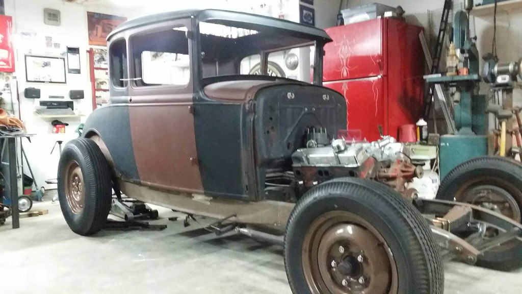

A good friend of mine owns Past Time Customs in Garland, TX. He made me an offer I couldn't refuse so he's going to do some work for me. The plan? He's going to finish assembling the rolling chassis entirely. I'd been working on it on my frame jig, but it was only tacked together. He's also going to mount the trans, motor, AND (this is a big one) he's going to mount the body! When I get it back, if you squint from about 50 yards away, it'll look like a completed car. :ror:

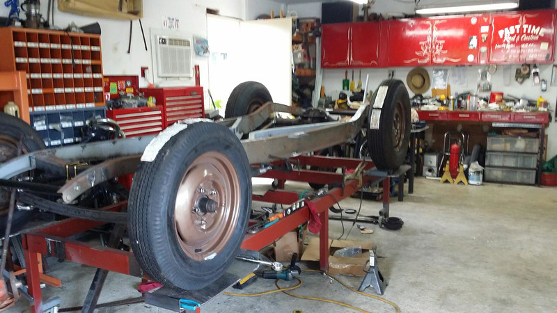

So a few weeks ago Gary came down to Austin and picked everything up from my house. Here it is all loaded up and heading out:
I was happy yet a bit sad to see it go!

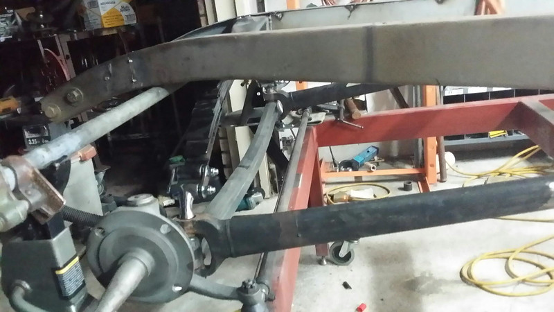

Front end going together. Dropped Model A axle with '40 Ford split wishbones and brakes (for now). Buick drums will eventually end up there.

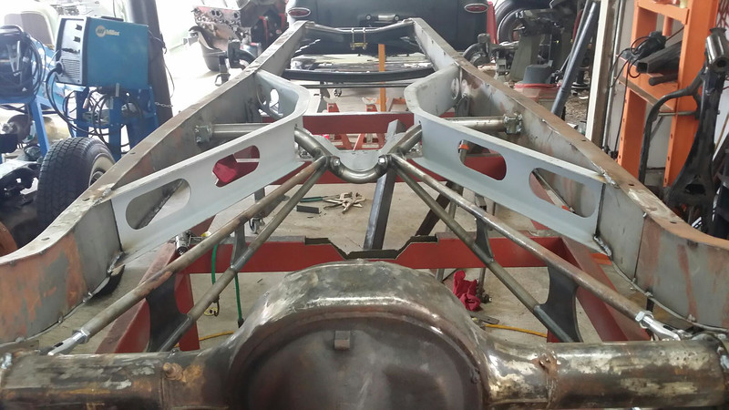

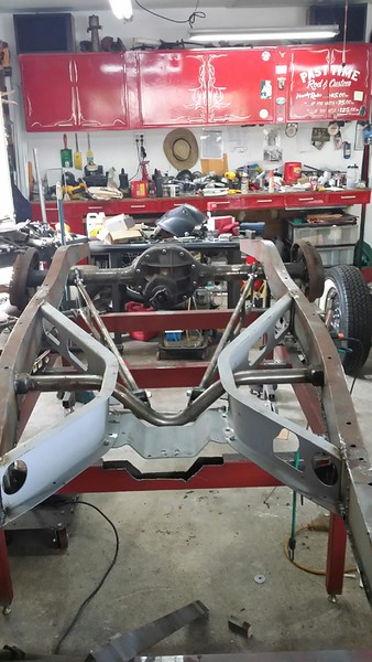

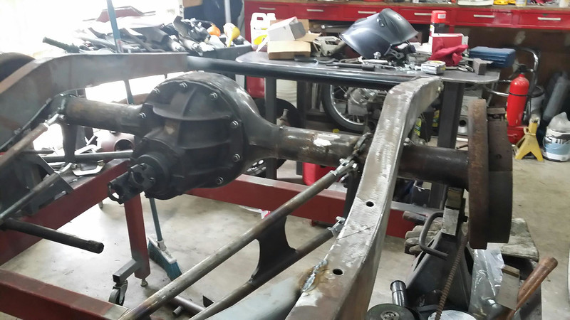

Chassis Engineering cross member and the Pete & Jake's Drag Duty ladder bar suspension in!

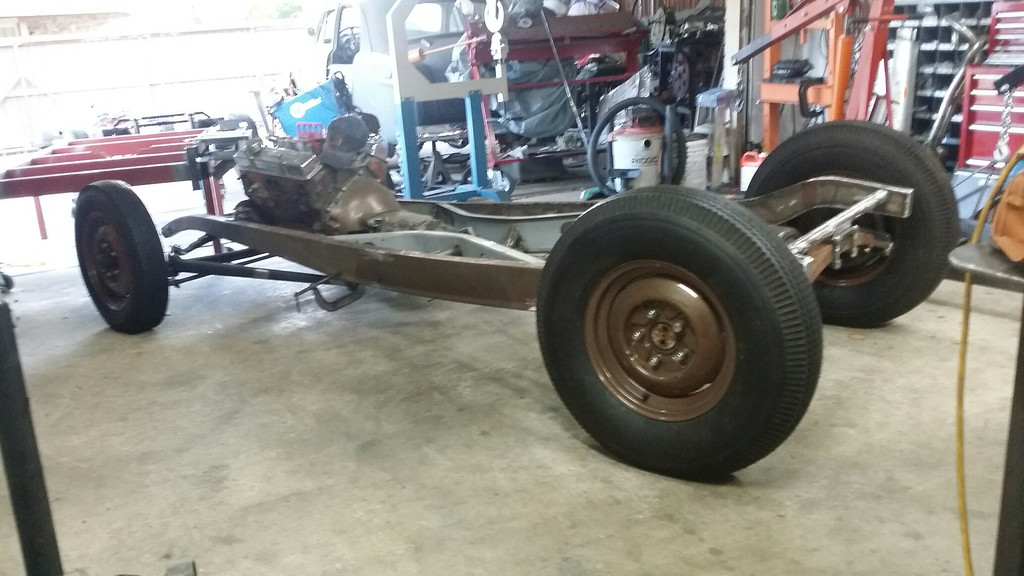

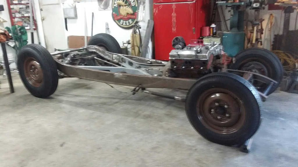

Dangerously close to being a roller!

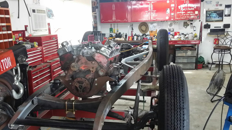

Motor and motor mounts are in. Went with a Hurst style motor mount.
