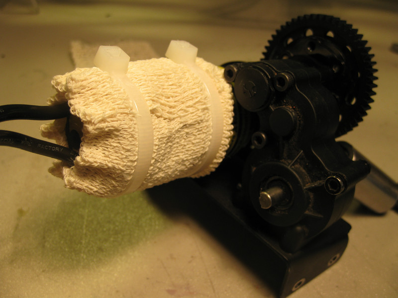

Try this, will allow some air flow and still keep the debris out."thumbsup"
http://cgi.ebay.com/3M-Vetrap-Adhes...t=LH_DefaultDomain_0&var=&hash=item84b7b3a6d6
Like this?
It does allow easier breathing than the coffee filter I'd planned on using. I tested by breathing through each of them! :ror: My only concern is if the fibers get caught up in the spinning bits, but I guess chances of that are pretty low, huh?

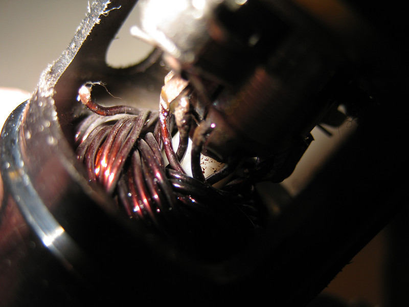

Tonight I removed the motor and took a look inside. I think something is wrong here!

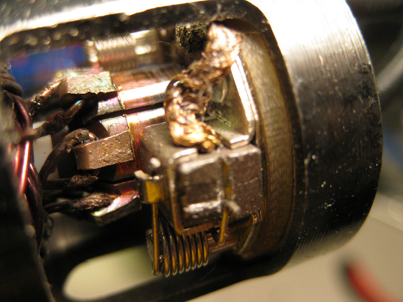

The other side.

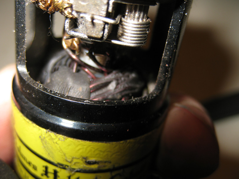

And there was this dusty residue outside the can, too.
I don't know what happened. Maybe it had something to do with my rebuild? Maybe it simply got too hot? I really don't know, but needless to say this motor will NOT be powering Oly next week.

im guessing the residue of dust is metal and carbon, and the can got so hot it melted the epoxy from the winds.

That sucks, the epoxy on the windings look discolored and if your seeing smoke, it's probably toast.:x
