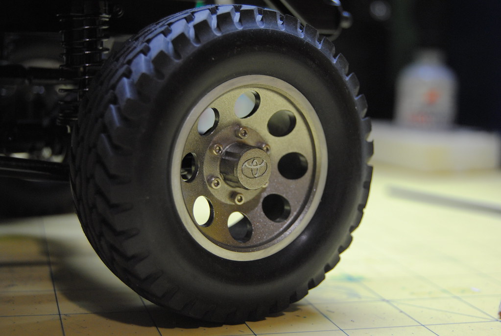

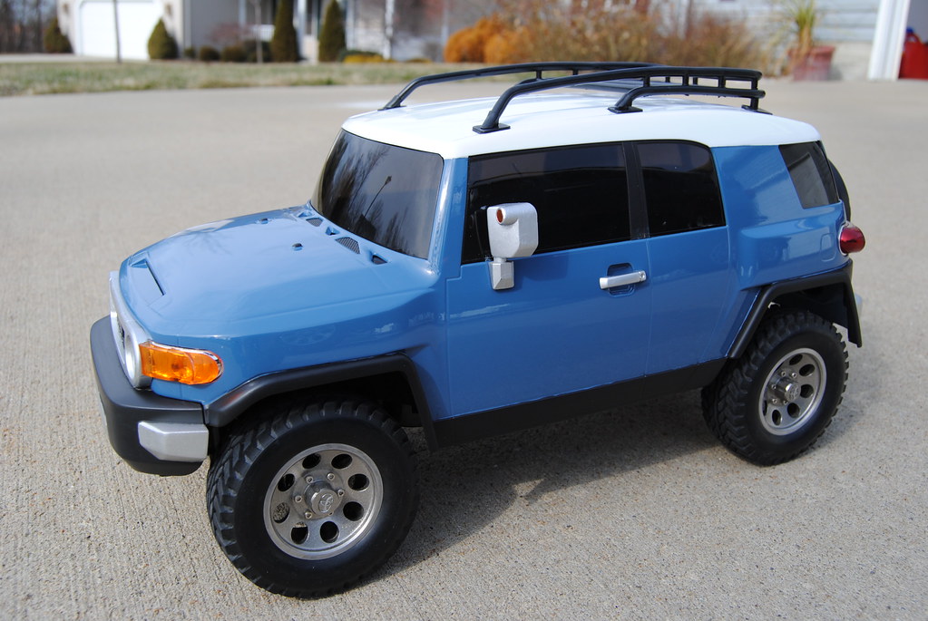

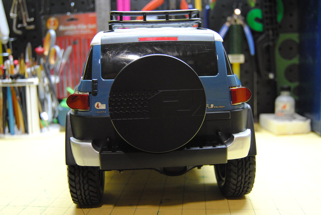

The rims I used are integy 8 hole 1.9 wheels. The tires are RC4WD invaders. They originally come as 1.55 so I cut the tread off and fitted it to 1.9 sidewalls. A lot of work but it was the closest match to my real tires.

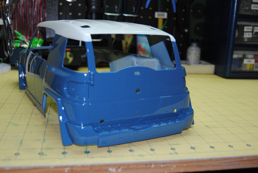

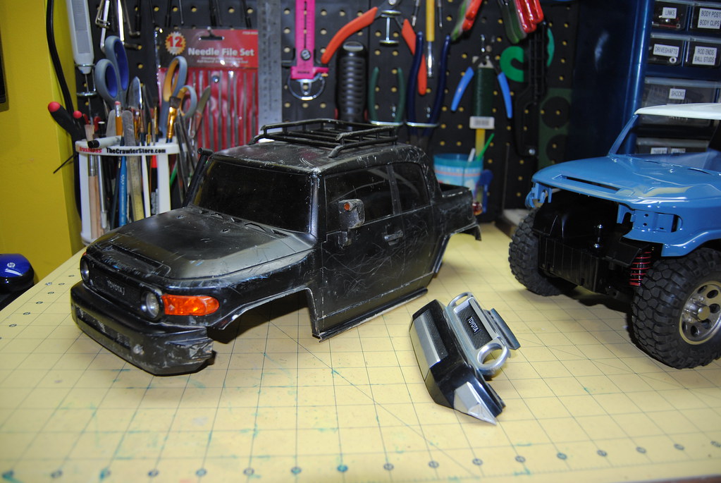

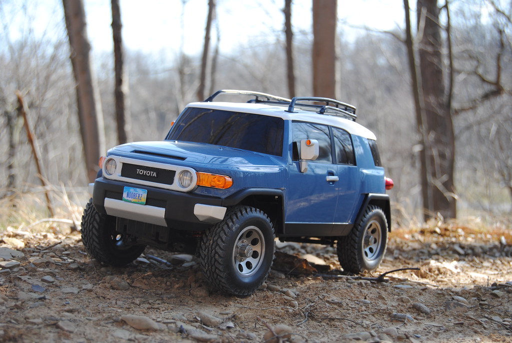

This time next week I'll be in Colorado for FJ Summit 9. I've been working on getting my little FJ Cruiser ready for the trip.
I started by molding a clear windshield and front windows.

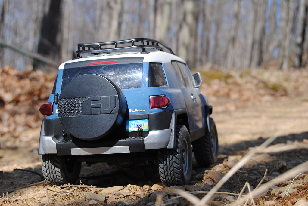

Expedition One rear bumper was next. I installed the full size one 2 years ago so I've been slacking.
License plates from Krawler Konceptz and found a suitable rear wiper.
Dashboard was the last major improvement.
