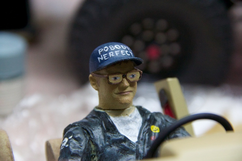

Painted a 3D printed head I was shown at a local comp by a nice man with glasses. Shamelessly ripped off the idea of painting eyes on the glasses. Masterstroke Dana.

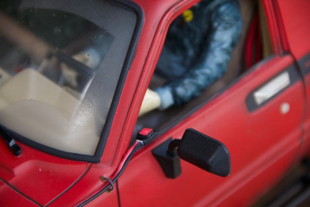

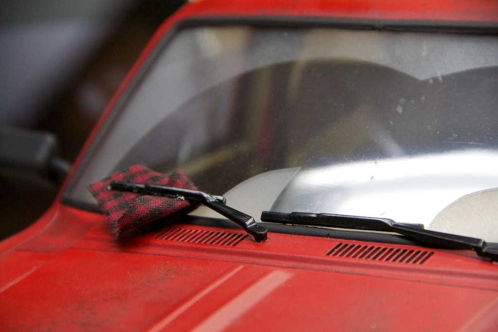

Didn't have another wiper on hand so used a rag. I've seen this done before. Works!

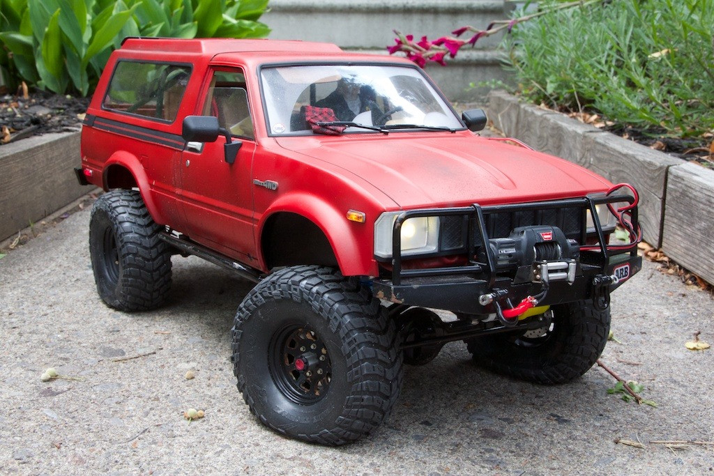

I'm happy to report that I'm essentially done. All that's missing is a licence plate.

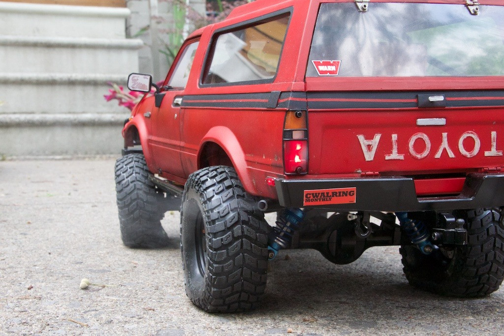

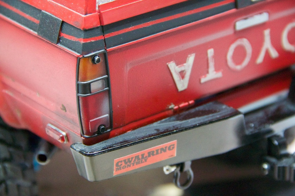

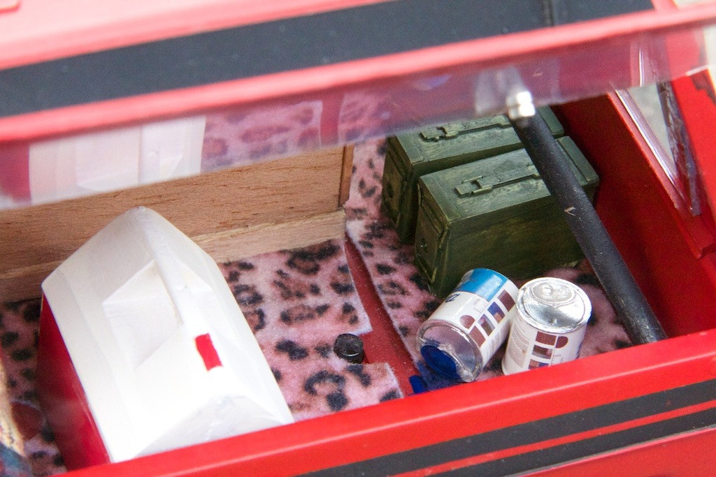

A few tiny details between yesterday and today. I flatted out and rusted the wheels to better fit with the rest of the build. Added a bunch of things in the bed, including some spilled paint. Darn it! Pobody's Nerfect. I also added a wired remote for the winch. I mean, how else will he control it?

Yep, functioning exhaust.
I ran a 6v Smoke Generator unit meant for model boats via a battery (so I don't have to have it running all the time) and hid it in that wooden box I made. Hooked it up to the exhaust and presto, scale hilarity.

Breakdown:
Custom Toyota Trailblazer body by Mr. N00b
RC4WD TF2 chassis converted to 3/4 link
R3 Single Speed Transmission
Holmes 35T Torqumaster
Holmes BR-XL
3S Battery
HobbyKing Most Powerful Extra Brushless Servo
RC4WD King Shocks 90 & 100mm
HeyOK 4 Amp Winch Controller 3Racing Winch
1.7 RC4WD Baja Claws

Love the detail! Dirty windshield & winch controller. Everything is top notch!!
Very nice youmightbethatman. I think you should put a glove on the windshield wiper instead of the rag so the truck waves, but that's my personal opinion.

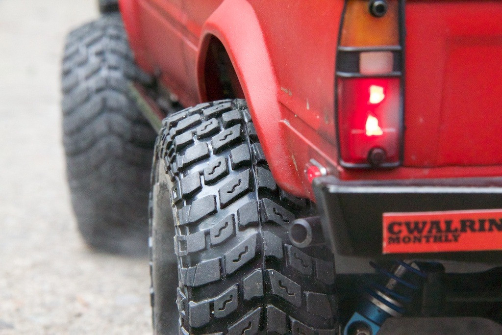

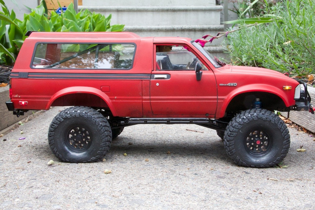

Well, after a reasonably unsuccessful comp, it was time to get this truck a little more accurate. I went to leaf springs for springing.
I had a super fun time with it at the HOP, but found on the 3/4 link, there was a lot of body roll. A little too much for something so heavy. I got the soft option springs from RC4WD which made a world of difference. Sure, I lose a little flex, but this just feels, better.
As an aside, with the leaf springs, I had to lose the RC model ex front bumper. The one shown is temporary.

New bumper is on, and I had a quick run at the HOP today. This setup is sooo much better. Still a great amount of flex, but not so much that body roll pulls the whole thing over. I'll never link a TF2 again.
