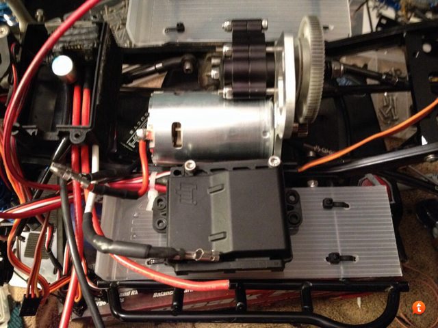

I run a 16T 48P pinion with the stock 87T spur.
a 11T pinion is way too slow...
and decreases wheel speed and top end I want.
To gain more power (spelled Torque)...
I run a 3s LiPo...
in combination with a 55T motor.
my top speed... maybe 5 mph
but from 0 - 5 mph, acceleration is brisk ;-)
But I rarely use all that power off the line.
A motor with less winds will be faster...
but speed isn't what this chassis is about.
It doesn't really handle well going fast.
Gearing along with the motor's wind will dictate speed.
In other words... volt up and gear down.
