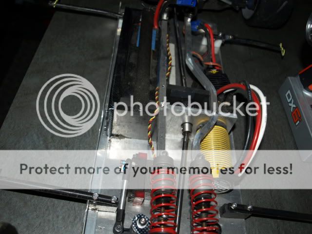

1.Removed front and Rear spools and put heavy engine oil (only thing I had at the time) to the front diff.
2.Months later installed Diff in rear with 5000 weight oil

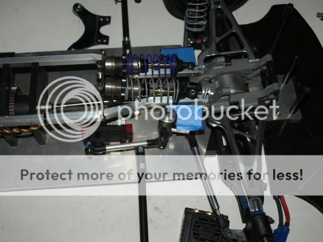

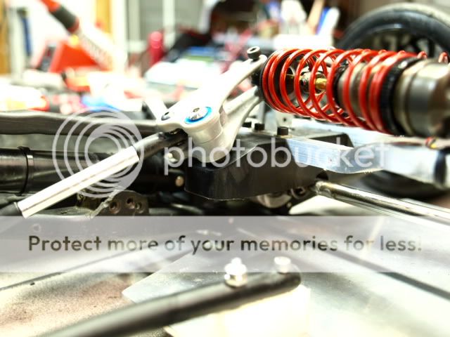

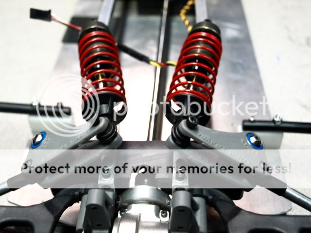

3.Built lay down style shock setup with temporary revo rockers

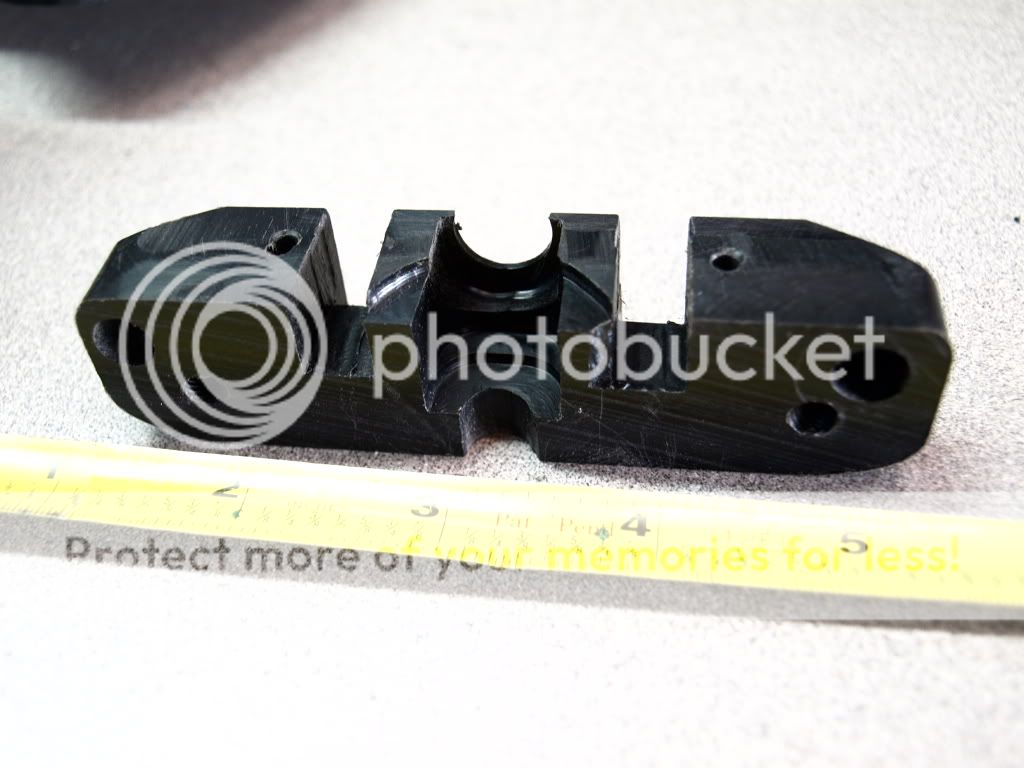

4.Machined Delrin blocks to hold it in place
5.Painted wheels.
6.Replace broken rear axle, may have to upgrade to Traxxas Summit shafts in the future.
7. In process of front and rear sway bar system

Mock up of front with ugly delrin shock support block.
Better made Rear shock support, will make same for front
Slide Rear into place
Rear
Rear

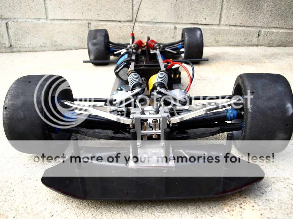

Made some upgrades
Needing new shafts . ( keep breaking)
Installed my custom adjustable brake button on the DX6i (silver tab on the grip behind the throttle)
NEW Tires !
Reinforced the chassis
New upper chassis rails
New Aluminum motor plate
Moved the Motor and battery to left side for better weight distribution
Results were great !
I was able to drive it with the huge body on it and reach 58mph before it STARTED to FLY up into the AIR !:surprised:

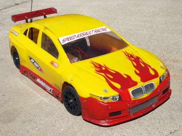

same ole ugly sedan body
need cash and some time to fab my own body

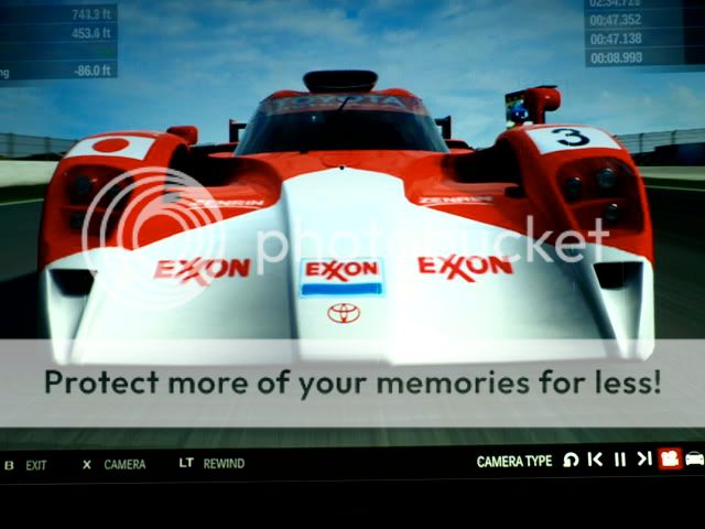

Want to build something like these GTP bodies
