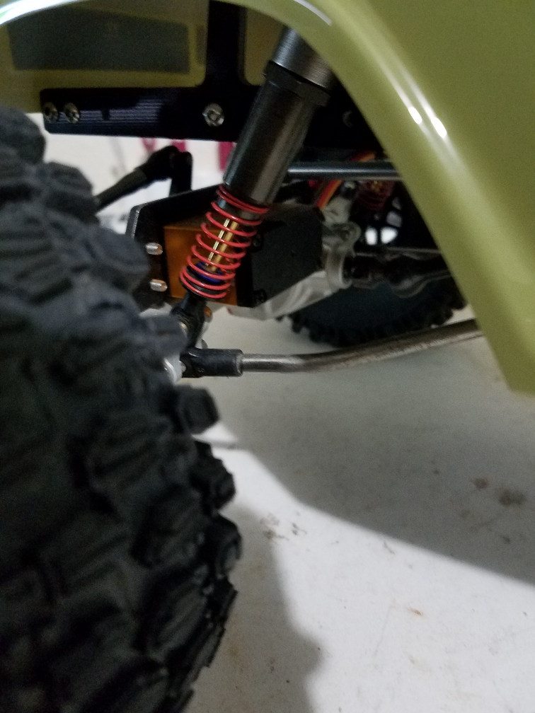

Here are my modded 2660 with 7mm spacer inside. It keeps a low ride height and perfect with these mini t springs. Still the smoothest shock I've ever had and sit at 82mm. I'm thinking this is what youre wanting to accomplish. Hope that helps
