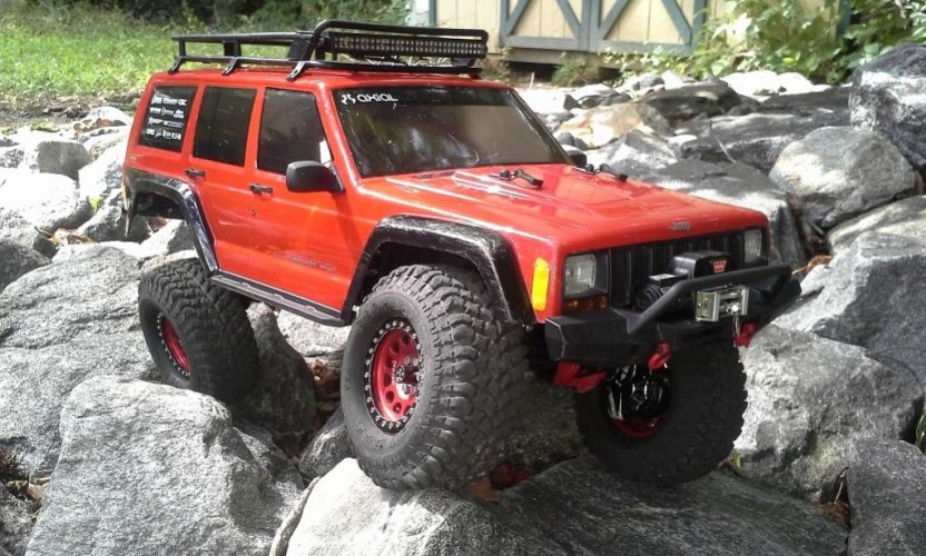

When you say "extra large tires" what exactly are you thinking? I assume you are aware that comps limit the maximum tire size in each class. I run a class II 4.75" tire with a lowered suspension and the truck works exceptionally well.
Probably somewhere around your size. How did you lower it? This is what mine looks like now.

To start with I slicked up the stock GTS shocks with green slime on the X-rings and left the retainer cap about 1/4 turn loose. I then installed a set of optional Traxxas .30 rate springs. This allows you to dial in some droop in the suspension. I typically shoot for getting the shocks close to mid stroke at static ride height.

Your shocks don't leak? What weight oil for the shocks? What is the stock spring rate and don't get rubbing with that much up travel using that body?
A better way is to use the white spacer in Traxxas 2362 rebuild kit to replace the black spacer in the bottom of the shocks. It’s super easy & 2 kits runs $5. This allows you to fully tighten the lower retainer and have perfect shaft movement.
You won’t be happy with anything heavier than 15wt shock oil. Factory Team 150cst is perfect.
Stock springs are .45/.54 on yours (I think). The point is: the stock setup is just too stiff.
I run aftermarket shock mounts that let you run 0, +5, or +10 mm on the upper shock mount. This will drop the truck accordingly, however, the front axle and linkages will start hitting stuff if you go this route and dont run a longer shock as well(IE longer shock body will keep the same bottom-out point). You could run 100mm shocks at the +5 and 110's at the +10 and still have the same bottom out point.
My goal was to try and run 110mm shocks(vs the stock 90's) but retain the factory ride height. I got there and the truck had an insane amount of flex, which was mostly down, as the up stopped at the same point as stock. Later I went back and put the stock shocks back on but at the +5 setting and I was hitting things on the front suspension and it was limiting uptravel.
The rear is less of an issue unless you run a low COG battery tray like the Bowhouse. In that case I was fine on the side to side flex/travel, but the straight up-n-down travel would cause the links to hit the tray.
