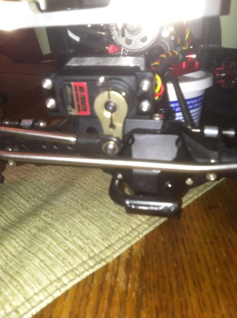

OK I have been able to get the remote/rec I wanted and preassembled everything to test everything and program my remote (Jr xg14) and now I'm confused about the motor direction thing I have changed my locker to put ring gear on the right side(pumpkins on driverside) then when I push forward on my remote it goes reverse and forward when I push reverse using the remote I can reverse the stick direction to get it to work correctly but no matter what I do it seems faster in reverse I emailed holmeshobbies and they said
Holding the motor in your hand, with the output shaft pointing down, rotate the can until the "0" mark faces you. In this orientation, the negative endbell contact should be on the right in normal forward timing. If the motor is reverse timed, it will be 180 degress opposite of this.
Doing this I see my neg wire on the right side of mark so it seems I have a cw motor ?????
I have read the tech posts on this and put locker in like the picture shows but it is faster in reverse
Can someone help I'm confused and not sure I'm not getting the concept or is the complexity of my remote programming confusing me
