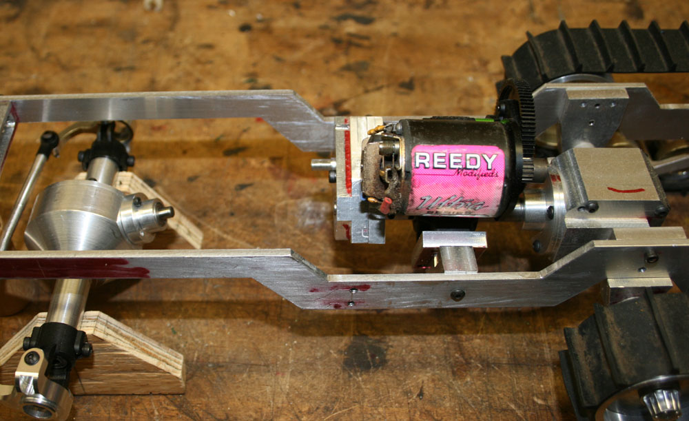

US M3 half track.
Very impressive machine work. That looks like a fun project.

Thanks Big Mike. We have looked into all the tracks, but as its his project and not mine, it was felt they are too expensive. Honestly, aside from the Axial tranny we have maybe $10 into this thing. Scrap metal FTW! Dad just wants it to move under its own power, not looking to recreat scale manuevers. "thumbsup"

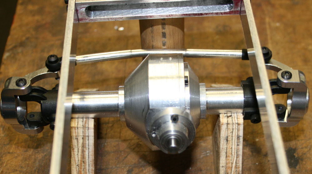

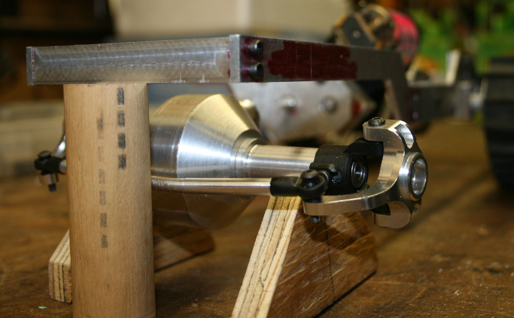

Between putting the dog down and installing all new hard wood flooring, dad finally got some time to crank out a front axle and transfer case. Leaf springs are up next.
(Spits out all of his hot chocolate) DDDDAYYYUMMM!!!! Thats the most skilled work ive seen on this site yet.. :shock::shock:
WOW :shock:. I wish I had that type of engineering/fabricating skills. Simply amazing work. This makes me want to go build something.

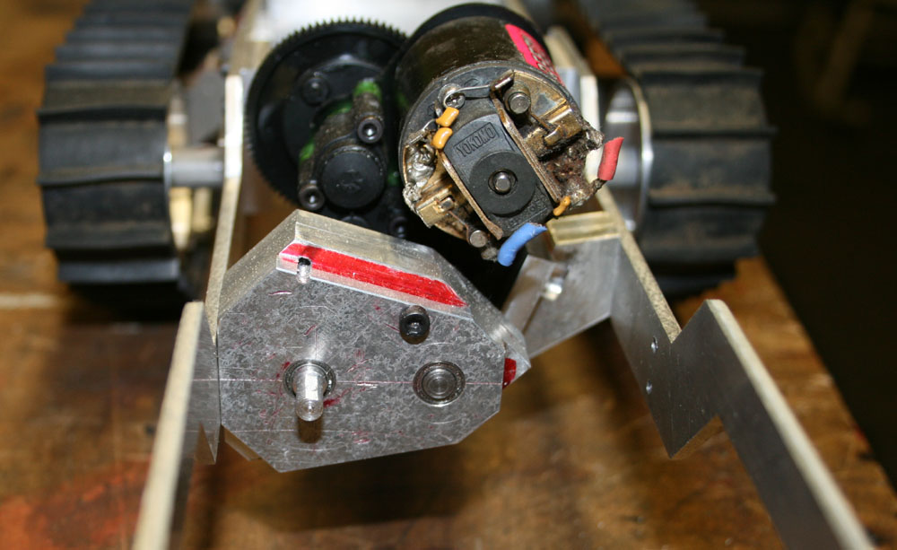

Thanks guys! Got the leaf springs almst done and mounted up front. I think they are too soft, so may re-engineer them, or use shocks with internal springs. I'll post a couple pics later after I fully wake up, LOL
Sorry for bad cell phone pics, my digicam battery is dead. Got the leaf springs mocked up. I dont like them, seem too soft. Main leaf is brass (bad, I know) rest are carbon fiber and staples are used as spring clamps. I will make some new leaf springs from spring steel when he isnt looking, LOL
