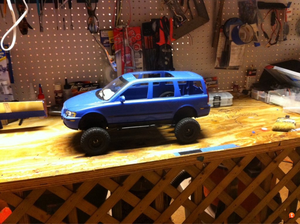

No more weight up front. Wait tell you pick this thing up. Very nose heavy. That GR7, motor, metal gears,,,, it's a tank up front.
Will have rear seat. Back of seat will be back of hatch area. In that pic of electronics, there is a 2800 hidden in that mess.

Cool build man and pass that ish my way dean! Are you going to keep the perriwinkle blue, or duplicate the 1:1?
It'll get painted. Not sure on color. I'll have to fill the hole in the roof. By time the body works down, might as well paint it all.
