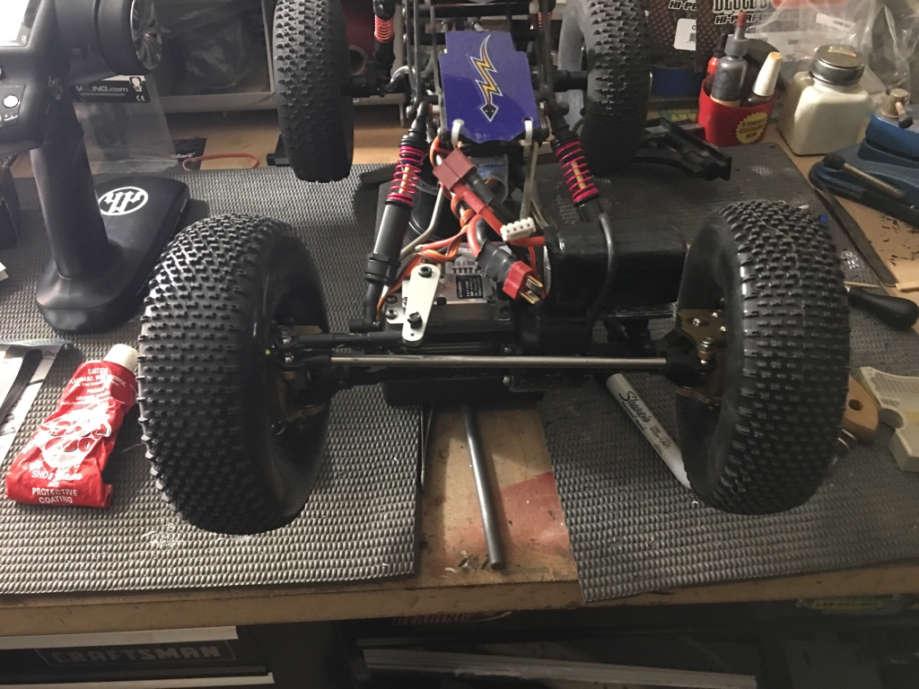

This is how I laid out the electronics on the bottom plate with double sided tape. Dig unit is in middle and then I bolted that plate thing on top.
Example of motor wiring.
Great job Joel! MUCH cleaner looking. Great pics too, will use your pics as reference for my own. Geez can I just send my rig over to you to tidy it up :mrgreen: Big thanks bro "thumbsup"
