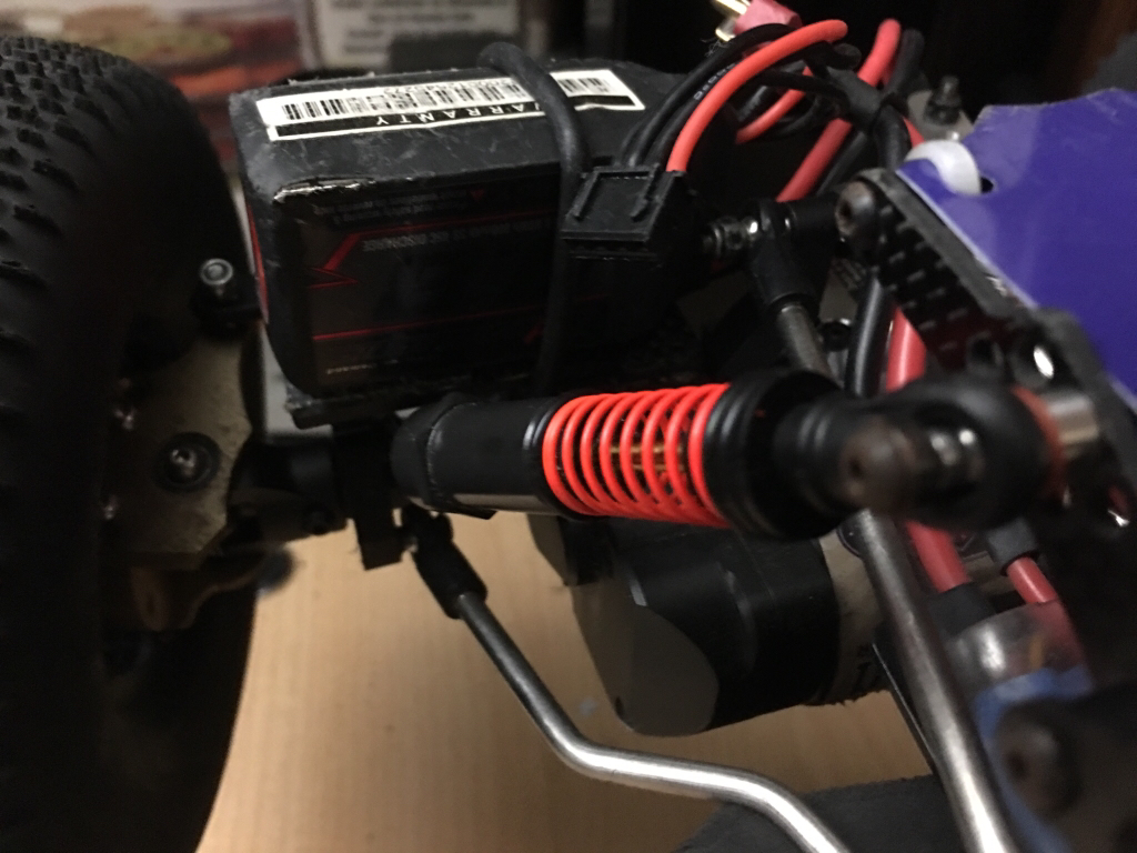

Look for an 500 to 850 mah 3s, you will want to dump the factory plug (Tamiya?) pop a Deans or xt60

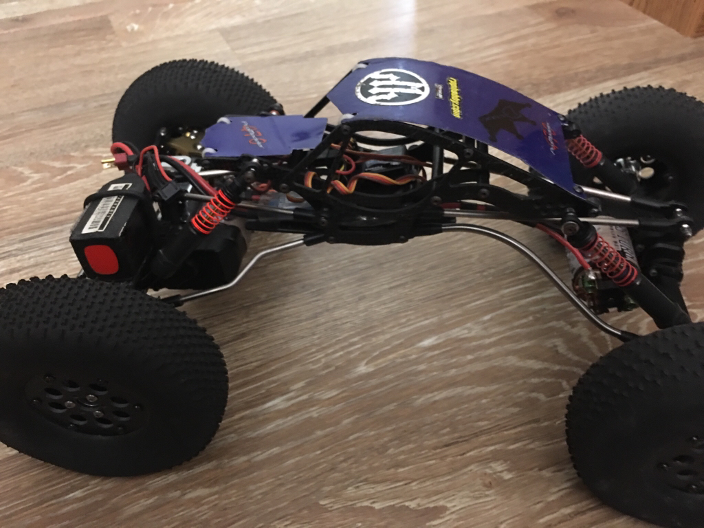

I run these broods on the factory mount
Hang up and Drive
Ok I bought the 500mah version of these, should I run a Lipo Alarm on em? I have a couple of those cheap RPP alarms somewhere around here 🤔
You can run a lipo alarm or only run the 500mah for 10min per pack.
But if you have a Lipo alarm run it to find out how long you can actually run a 500mah lipo for.
It will work. Most run between 450 and 800, due to size and run time. If comping you will want a small battery, for just fun, the bigger ones give longer run times.
