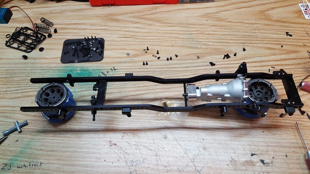

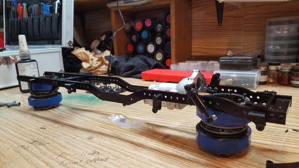

This is what you get in the Ultimate kit....
Left and Right Chassis Rails, 19.7 inches long
Front Servo Mount
Front Shock Mounts
Front Leaf Spring mount, and swing hanger
Front 540 size Motor Mount Plate

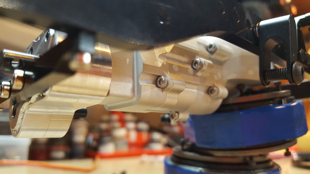

GCM LowRange Scale Transmission, Steel Gear, 14.3 Gear Ratio
LRT2 Transfer Case, 1.11 Overdrive Front Output
Transfer Case Cross Member
Frame Center Cross Member
Frame Rear Cross Member/Rear Shock Mount
Rear Leaf Spring mount, and swing hanger
Includes All Hex Hardware, 12t Pinion Gear for 1/8 motor shaft, All steel drivetrain gears and shafts, and all aluminum mounts and rails.

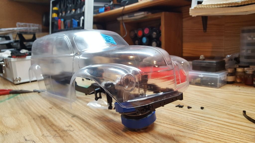

I looked at them awhile ago on their website, just out of curiosity. They look damn nice! If I found a body I really liked, I might consider it.
