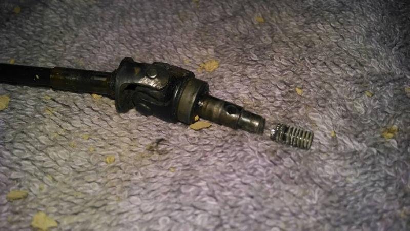

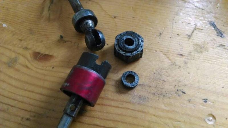

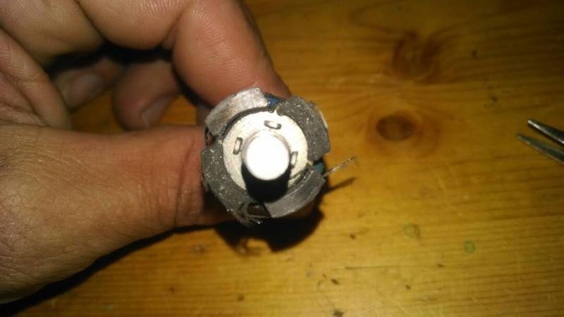

Pics all since I went with the Dlux mod housing and could actually keep gears in one piece...
All pics are of different breaks over the last month or so and of diff breaks.
I have so far lost/broke both stub shafts on the uni's and vvd's, bearings blew apart at the Knuckle's and outside edge of the axles and broke a rear axle shaft.. And Not once have I had a gear skip, pop, or the mesh loosen up!
