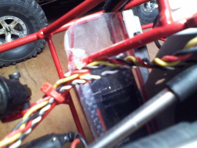

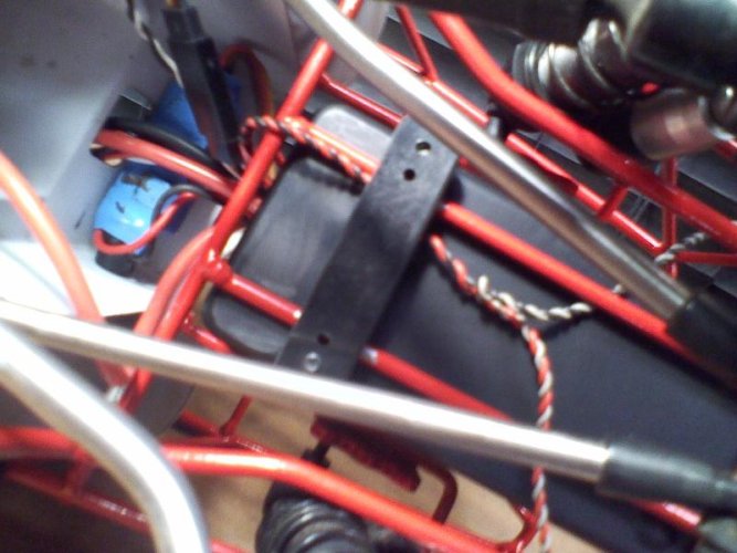

The interior needs trimed on the ends and narrowed ,And there is no body tabs ,,I used heavy duty velcro ,,Attached the front battery plate to the chassis and interior with zip ties and Shoe Goop,, I used a Radio shack project box to hold the electrics ,,made a small clamp to hold project box,,So far three runs and no problems ,,It is heavier but seems to side hill just as good ,, Using a 2200 mAh 3s lipo fits snugg,,
