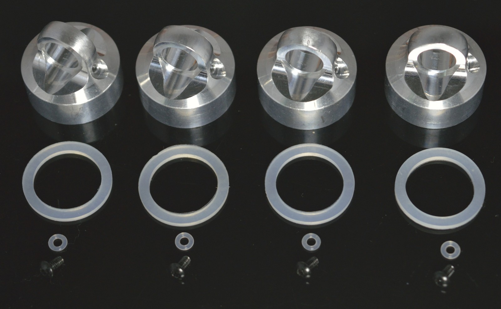

Lookie here!
Aluminum Shock Caps Polishing for Axial Yeti XL 90032 Dhawk Racing | eBay
I sent them an email on ebay stating they needed a bleed screw and what do you know I guess they made it happen."thumbsup"
