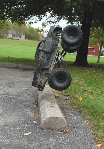

i just had to run over some stuff with the tires inflated to 10spi :crazy:
Now for the fun :chug:
