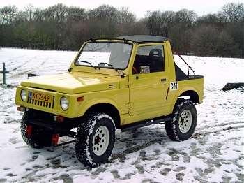

Judging by the pic of the real Samurai with 30" tires, those are too small. They should fill the wheel wells a lot more-- right now it looks more like a Mule. Good work otherwise though.
Numbers don't lie, scaled off the 1:1. One thing that throughs you off is being able to see through the body/chassis.
I think it's pretty close.
The only real difference I see are the leafs. The scale sami has arched springs. The other one has flat springs. Other than that yay it'ss dead on.
those tires look a little on the dinky side, going through my tires i happen to have some maximizers with k-rocks sitting right here beside me and looking at them, looking at your sami, looking at them looking at your sami, you might have to lift it a little but they would probably look pretty awesome on it. like a 1:1 lifted sami with bfg krawlers. either way great job, i love the one off body jobbers
