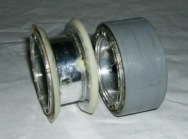

I used your idea and came up with a fix for my 2.2 8shooter
I turned the outside down to 60mm
a 64mm or 2 1/2" pipe 28mm wide
There are still enough room for lead

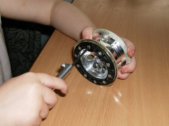

My little helper

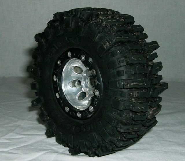

And the modded wheel

Thanks for the write up! I just finished using this method on my MRC. With no foams, the tires now grab so much better than stock.
Great tech tip there rckjeep, this mod helped considerably. Almost have my MRC ready to compete "thumbsup"
Nice how to rckjeep, I did the same thing but drilled the bolt holes thru the rims and used 2/56 button head screws and nuts to really pull the bead locks together."thumbsup"
