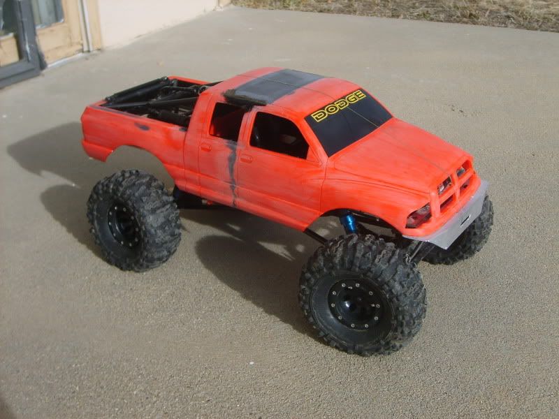

I swapped my WK axles out for AX10 axles, and now the track width is where it should be, wheels stick out just the right amount past the body.
I painted the frame, and the body, bought the carvers, mounted the spare, upgraded the winch motor (Mini LST 370 Frenzy), got a new LiPo for it (3S 3600mAh 30c) and got some rock rash on the new paint already from the comp yesterday, here's some pics:

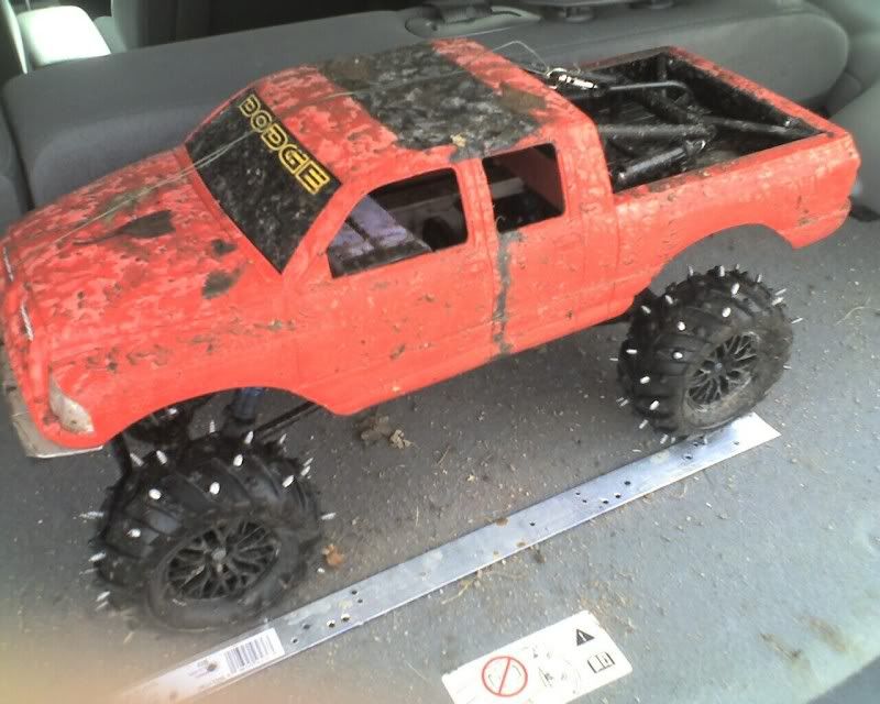

Finally some pics on the rocks:
The rock pics were taken at the Scale Summer Series opener, and the truck ran well until I shattered a driveshaft, not just broke, but shattered. I put some extended Traxxas truck shafts on, and they may have been a little old and brittle to start with, so I guess I wasn't expecting much, but I didn't bring a spare, so I was out after the first gate into the second course. I upgraded the Axial trans to a 6mm output (using a 6mm rod through the existing aluminum outputs that broke last time I drove it.) Now it's beefy, and I can use my Aluminum driveshafts again, and leave the slipper as the weak point to prevent more catastrophe.
I was also having issues with the MLST ESC. I'm pretty sure it's dead now, but I don't know what killed it... The motor is made for this esc, and it was on it's own battery, good thing I bought a spare for it.
