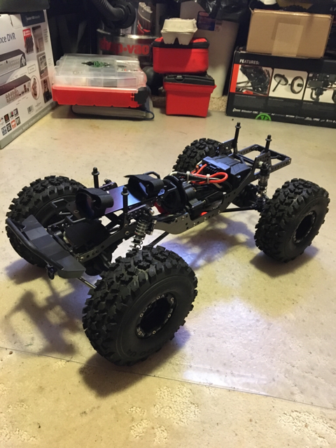

Do you use the stock battery tray for this? Or something else?
Yep, I currently have a stock battery tray and supports mounted in the front. I have the MMX on the rock sliders and the Rx will likely be mounted on the opposite rock slider.
Ignore my untidiness... Some progress has been made since.
I like that set up. I could run small packs for comps, and larger ones for bashing around. It looks like the spur nut touches the plastic battery tray frame. But it obviously doesn't touch right?
Correct, its above the spur gear. I'm pretty sure I can get the spur gear cover on there. The battery tray is mounted sturdy so I'm not worried yet.
So here we are ready for an indoor crawl get together Sunday. Pretty excited to test her out. Still need to get the BEC connected.

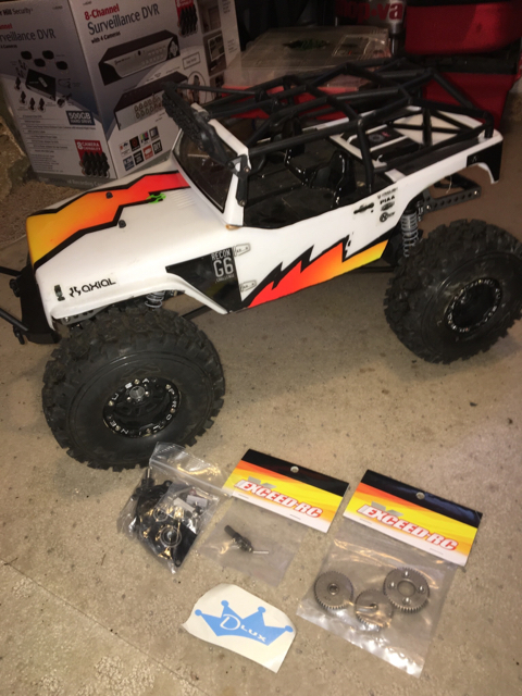

Then after Sunday it's time for the real fun. Dlux goodness going in here, ham bergler transmission. Yummy!!

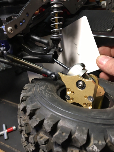

Well now I understand the importance and reasons for beef tubes. Stupid dog bone axles, I have Universal's on order but now I have to get axle housing's and Beef tubed. But at least the Dlux knuckles fit! Love Dlux parts.
