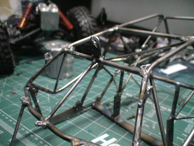

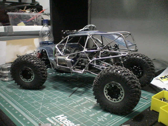

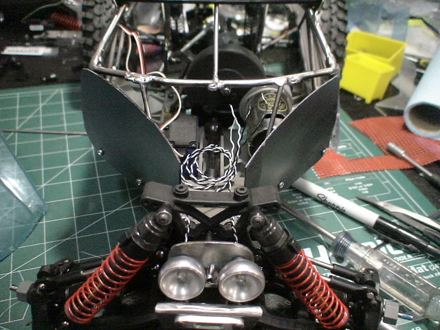

Got a lot done today:

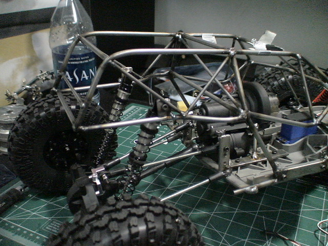

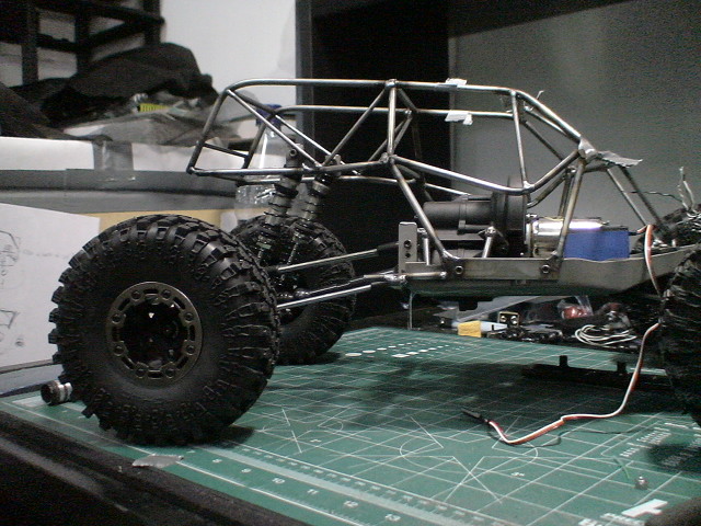

The rear HR shocks and links are on, just need to sleeve the links:

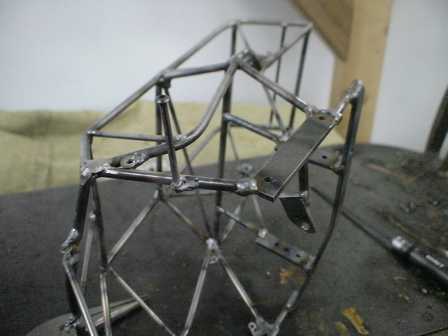

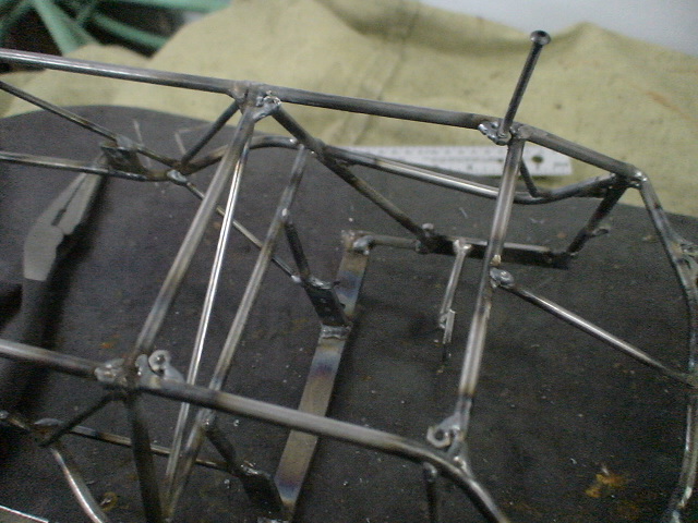

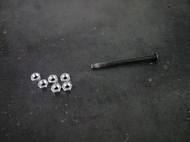

Time for nuts! Lots of nuts!

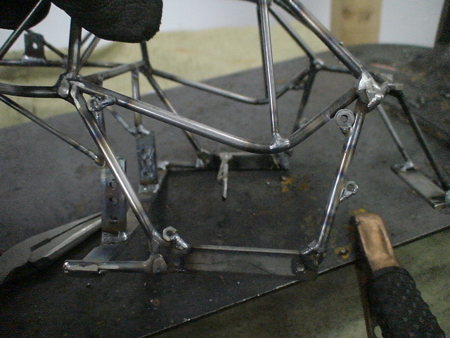

Here's how I put them on: I use a long 3mm screw and spin the nut on the end. Then position on the chassis holding with pliers or my hand. MIG carefully to avoid damaging threads!

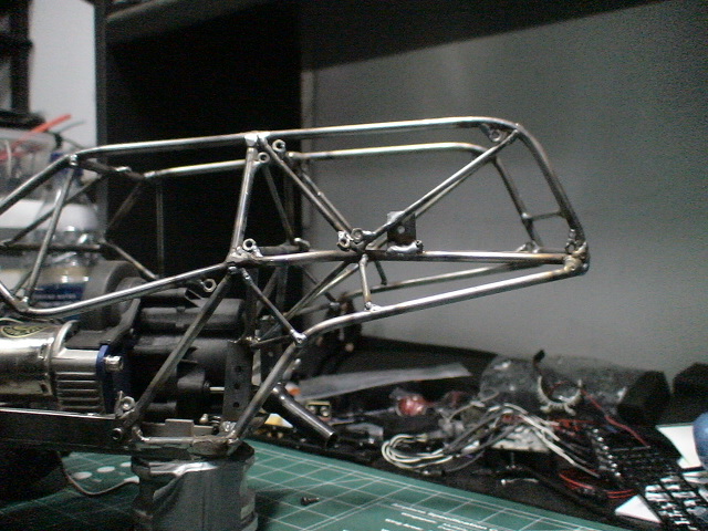

Rear 'fenders' on, more nuts:

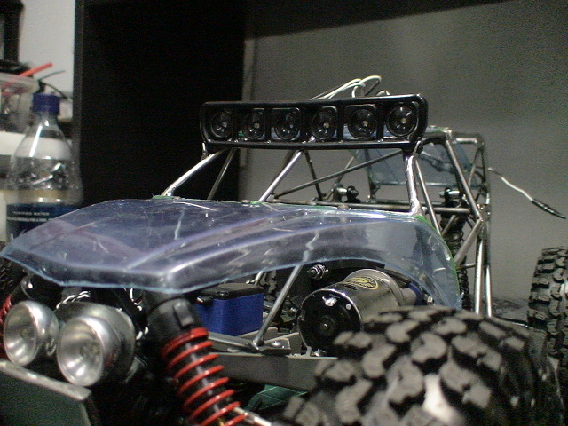

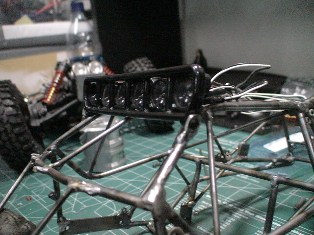

Lightbar mounts:

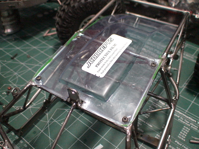

Roof bolted on:
Mmmmm.

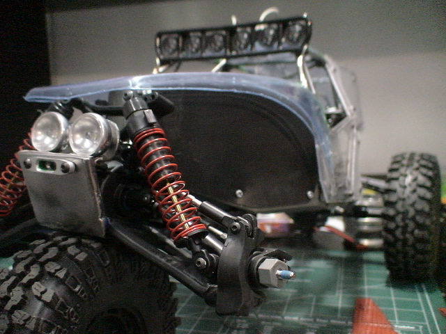

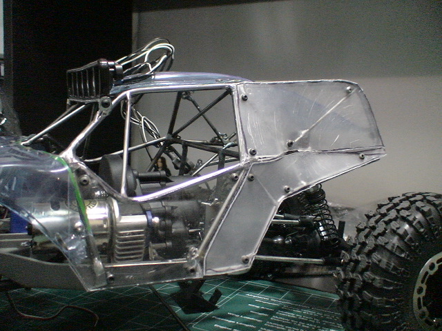

Cut and heat molded the body panels:

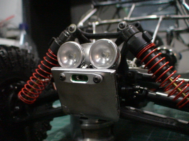

MSD Fairlead on:
BAM!

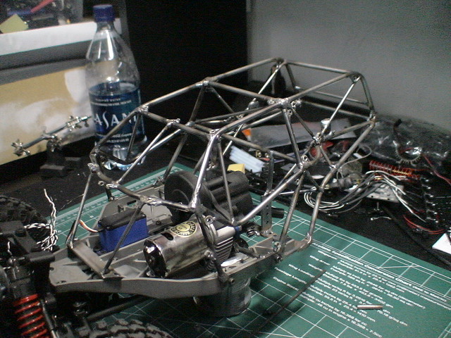

The Power is here! Tekin RS Sensored system with a 10.5 motor...

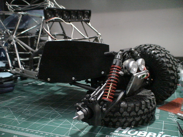

Black styrene inner fenders:
No mud getting in here!
More tomorrow!!
How do you like that light bar? Also, how's that motor setup so far? Been thinking about it but don't know if it's toom much ummmfff for a rig for me. Ryan, again sick,sick build dood!
It's cool, I like RPM stuff and this one is less likely to bend. I'm sure it'll get destroyed either way with the way I drive. ;)
I had to guess on the motor using what I've learned from my current summit tranny'd truck. The 5T puller is around 2000KV. The Tekin 10.5 is around 3480KV, and being sensored there shouldnt be any cogging issues. If it's too slow, I'll just swap the motor out for an 8.5...
