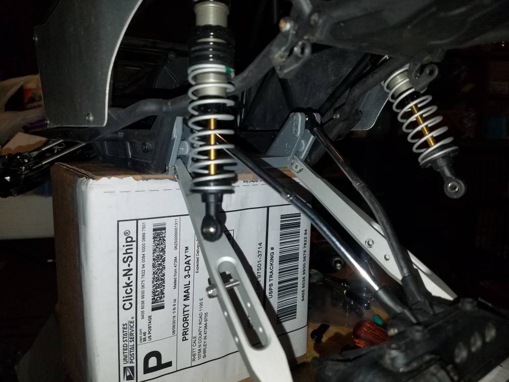

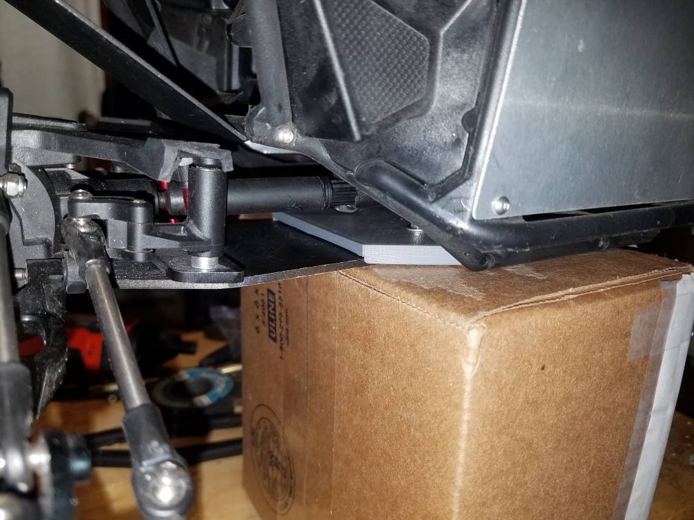

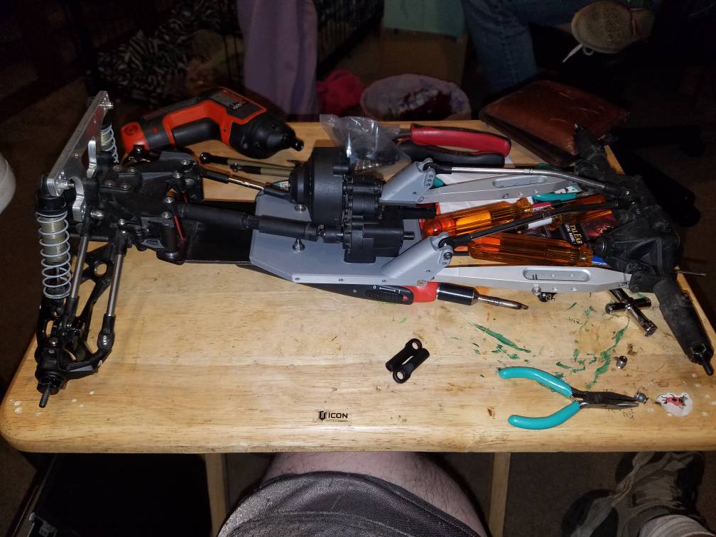

Cool, what material did you print it with?
PLA for now. I imagine I will ultimately have to go with something stronger but going to give this a go for now. Bumped the heat up just a bit for better adhesion and printed w/ 2mm walls/ceiling/floor and 30% infill.... We'll see how strong it is...
Pics of it mounted?
Hope to be able to work on it a bit tonight, been busy buying/selling/working on my 1:1's for the last week or so, lol
