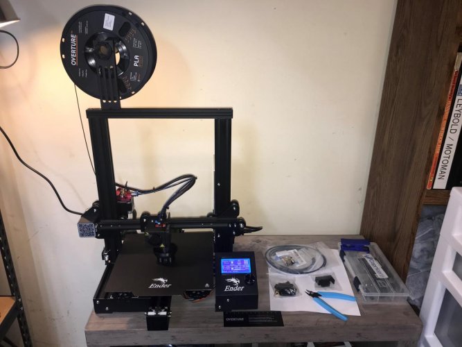

Love my Ender 3 PRO!
I entered the 3D printer world last December with the PRO and have had great success without any issues.
There were a few printable mods that I did right away and also added the Capricorn bowden tubing. Once the bed was leveled, I've had flawless prints. My printer runs everyday for hours at a time and I have not had a single problem with it.
