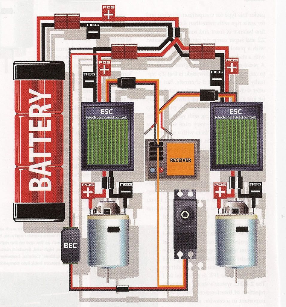

With whoodies setup you will need to direct wire the CCBEC.
This is what I sugest:
Go buy a Y-harness with a female input and 2 male outputs. You will need to take one of the males ends off and replace it with another female. This is very easy to do with a hobby knife.
Plug the servo into the input side, and make the red and black wires go to the other female. The signal; wire goes to the male side.
You will plug the CCBEC into the Y-harness to power JUST the servo.
You need to reinstall the Power wire of ESC's to plug into the RX (just one will do but I do both).
I just scanned this picture out of my RCDriver Crawler issue.
BUT, they forgot to reinstall the power wire to the RX!
I know this is confusing and if you need pictures I can go get them from my Berg.
Thanks Harley. I was thinking the same thing when I was at the LHS but they didn't have a Y-harness in stock. I already did this setup on my other berg.
...Now, if I plug the front ESC to the 3rd channel and the rear ESC to the 4th control, then where do you plug the CC BEC to? Or do you just let the ESC power the servo? Or order that optional piece from Futaba for the 4ch/bat?
Can't you just plug the BEC into the vacant CH2 slot?
Take the signal wire out of the BEC RX plug and plug it into any available slot on the RX. I would recommend not cutting the signal wire, you will not be able to program it without it.
