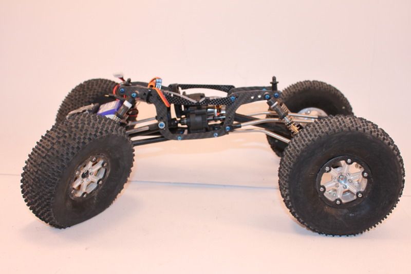

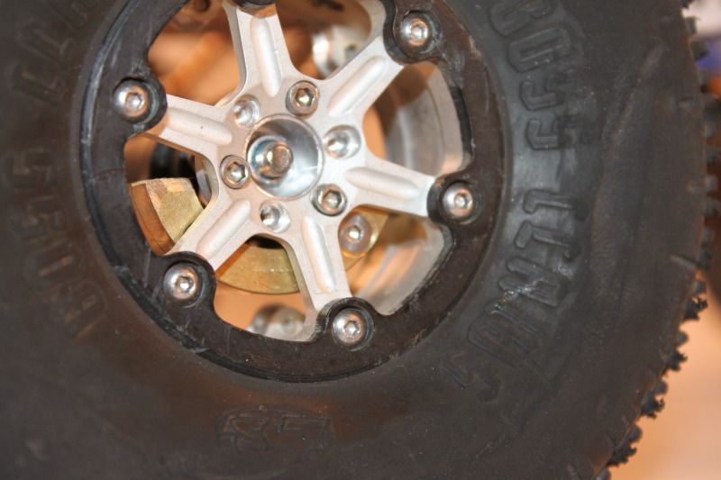

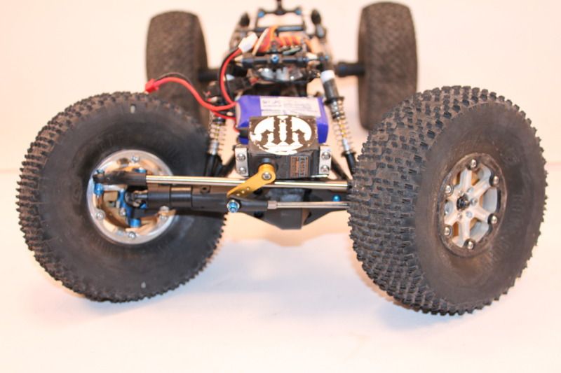

With the wider front axle I couldn't run as much knuckle weight. But I also wanted to try less, so I put my shaved VP base on.

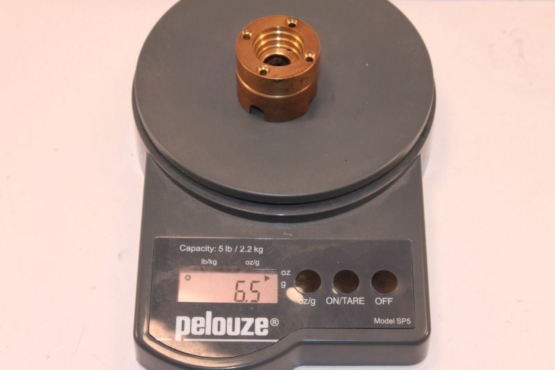

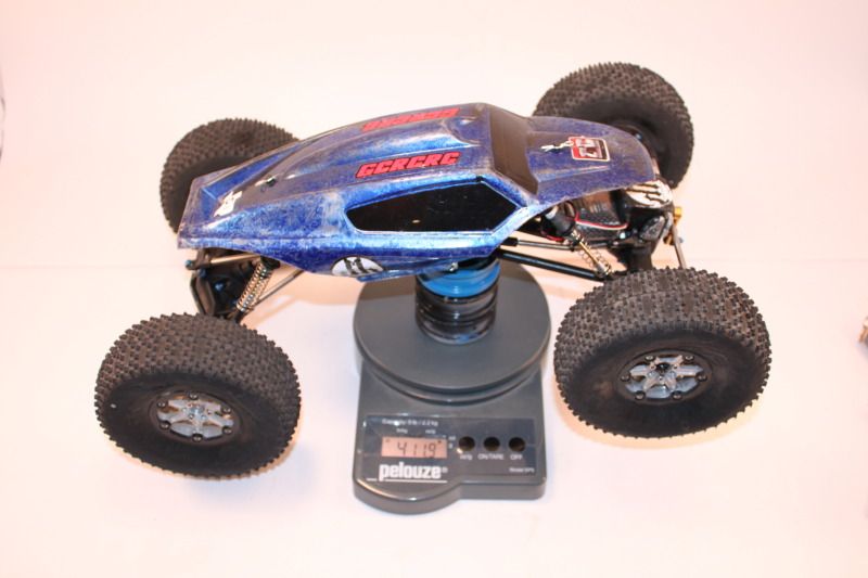

The weight before.

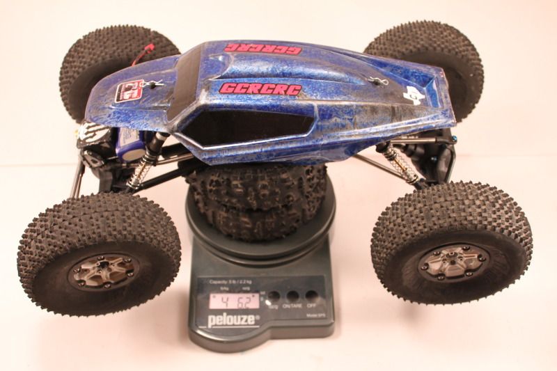

Current weight. It actually came out a bit less in the end.

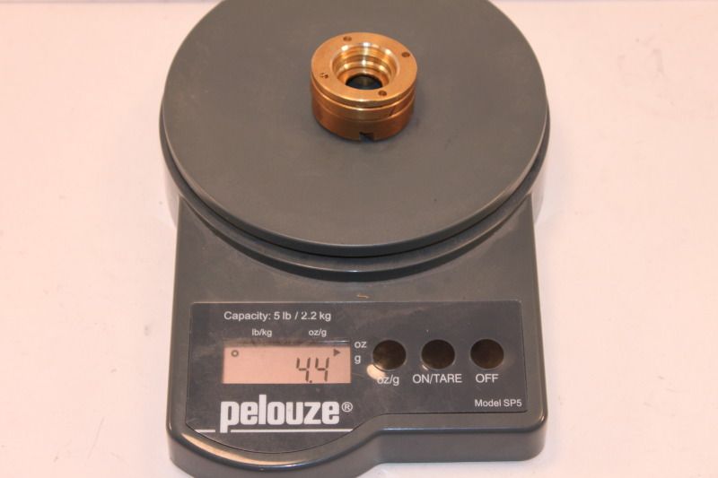

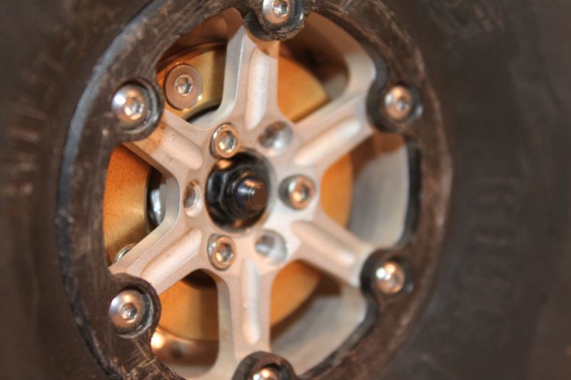

Old rear SVEN lockout weights.

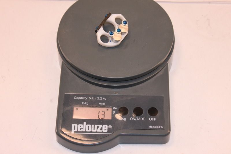

As of now not running any but may add an oz of brass on each corner in the end.
The Proline shocks werent my favorite and I had always planned on SCX shocks for this car. They shaved about another .3 oz.
Some more pics of the changes.

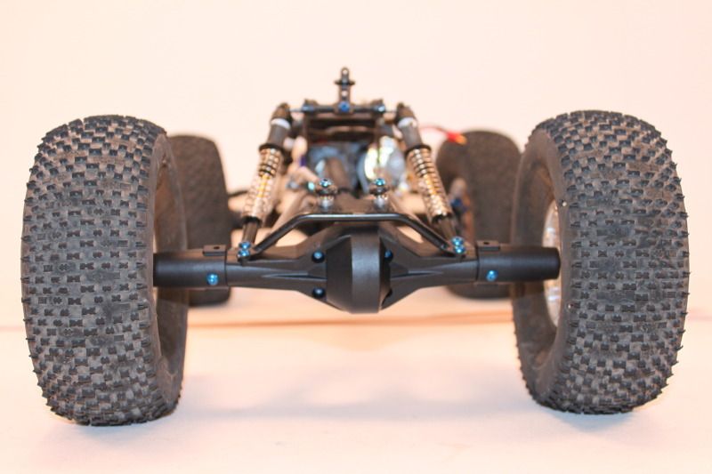

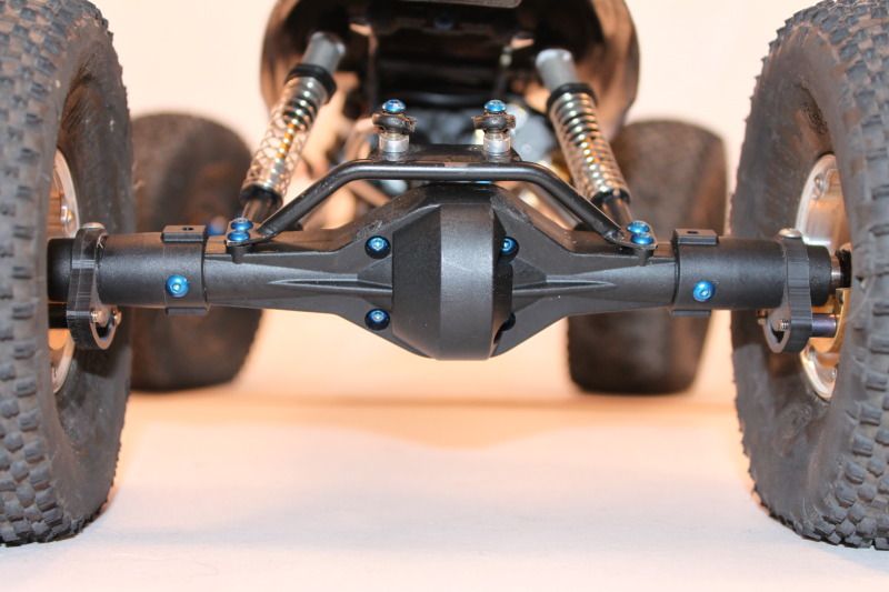

The new rear axle.

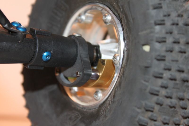

Knuckle weights tucked in nice and tight to the wheel face.

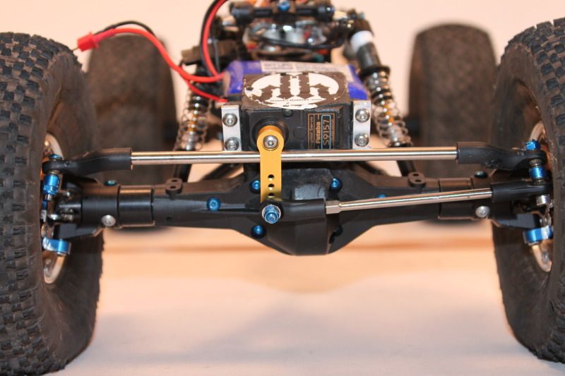

Completely revamped steering setup.
And all back together RTR with a heavy 4s pack.
Well thats a big drop from 5lbs 2oz! I will probably add an oz each rear and tune from there.
I added one ounce each front wheel and tire, and two ounces on each rear lockout. Bias is perfect and the weight is a little more reasonable now.

The rod ends look like the ones that come with the rtr wraith to me
They are two of the wraith ones with the bolt on drag link part cut off.

Looks real nice man. That steering configuration is nice"thumbsup"
Thank you. "thumbsup"
Are those D-lux rear weight holders? I like those"thumbsup"
Yes they are. They work out well, If I had a wider rear axle or if they were closer to the end of the lockout they would be perfect. But they still work well and don't hang out too much.

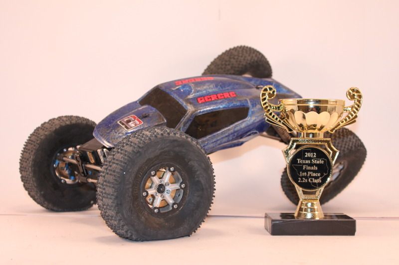

Thanks Norm, it sure was, the competition was fierce, Eddie with his tuned T1E, Jeremy and Michael with their very well tuned Dunn chassis, Shane with his awesome hand cut carbon car, and Chad with his BWD machine!
However....
The car did what it was supposed to, and things worked out.
I really wanted to switch to my Parma Exciter body since the hardline is a turd at rolling over. I see Jeremy and Michael righting theirs with ease. But with getting everything together to run the comp and getting my cars ready there just wasn't any time.
Good thing I never ended up upside down I guess. :ror:
I still plan to switch to the spec class body.....I mean parma body soon. Man I wish this car could just quit hiding under a lexan boat and put a cab back on. :roll:
