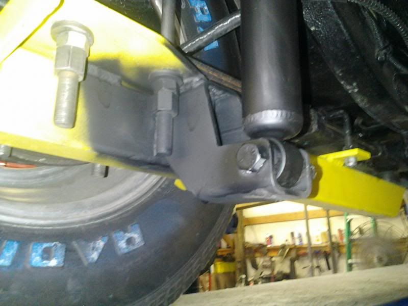

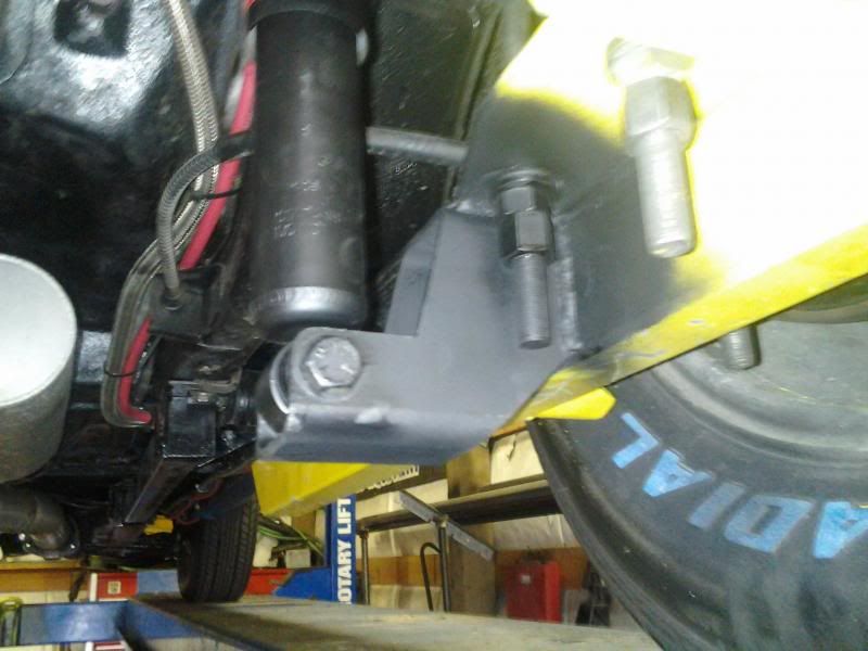

Then it was time for the lower shock mounts. Again many ideas were considered until we decided on this version. It is a piece of 5" square stock cut to fit the desired shape then welded to the slapper bars.
A pair of KYB gas adjust shocks were installed. Talk about a difference in ride quality. Couldn't be happier... Thanks to Kenny for all his help fabbing, welding and putting up with me...

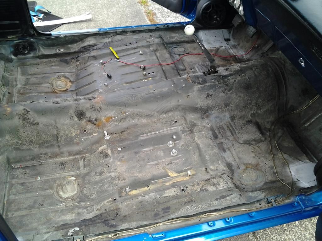

Spending a bit more time getting a few things done. I pulled the seats in prep to have them reupholstered. While they were out I pulled the carpet to inspect the floor pan from the top side. All looked great, you can see where the roll bar was welded in prior....
(Side note) I new it had one during the intiall build up of the car. When the previous owner was trying to sell it, he had no takers. So, the bar came out and a complete interior was installed. The car had never been to the track as the owner before the one I purchased from never completed the project. And the fellow I bought it from didnt have any desire to run it on the track prior to the sale to me.

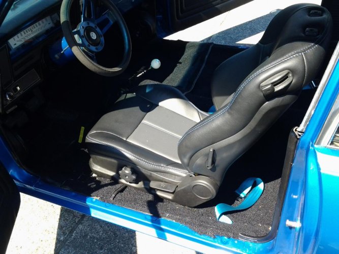

I installed the drivers seat, the pass side will remain out untill the rear seat is installed for easy of access. The pic washed out the thread color a bit but it is a close match to the paint. Inserts are a perf material, again the pic doesnt do it justice as it is just a shade off from the black on the rest of the seat. Pic makes it look like light grey when it is more of a gunmetal or charcoal. The seat backs were also wraped to get ride of that ugly plastic and to make it match the rest of the seat.
