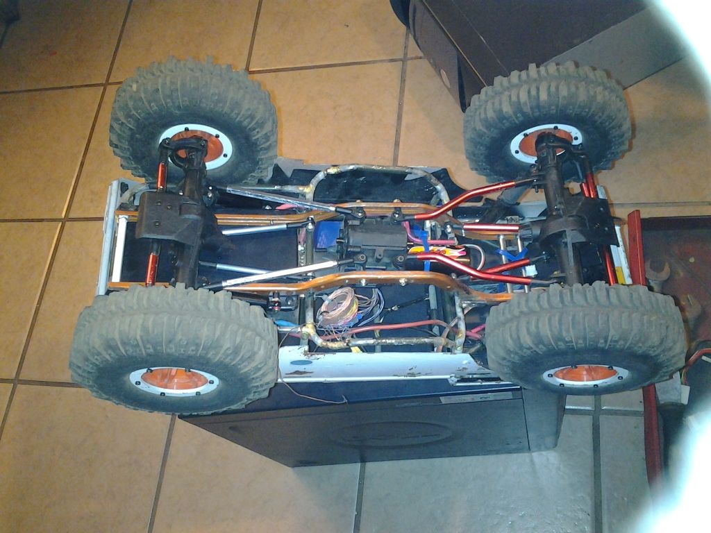

here you can see the pinion angle. excessive pinions angle can cause u-joint failure and yoke wear. a more in line setup will reduce stress on the system and prevent blow outs like this. i didn't get a pic of the yoke, but the front yoke on the rear drive line and the both ends of the front show no signs of wear. most likely this was caused simply by me clicking the shaft wrong and the excessive angle and happened in a short time i was on the trail.

It looks like ur front axle has negative castor(axle is rolled forward), which would put pressure on said Pinion? Try getting positive castor(get ur servo plate to sit level)an see if that doesn't help ur issue.. better for crawling an climbs...
I will take another look at that, something is off, i don;t think it is housing, i have tried shimming the pinion thinking that was the case and found that stock clearance was damn near perfect. one thing i did notice is that I didn't start having issues till I dropped the rear drive line. I think if I could get that to stay on, it would help alot.
Yah according to that pic the dif angle is off by quite a bit which could be putting excess stress on the pinion. If you would put a good amount of force on the pinion being the housing is plastic it could flex a bit maybe causing the pinion to become loose and skip causing the teeth to grind off?
