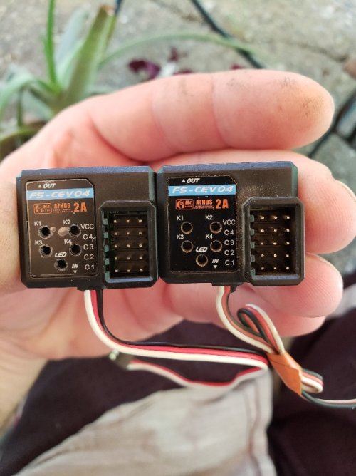

I tried rebinding a dozen times and it still wouldn't work for me. Tried going back to 4 channels, then binding in 6 and 8 with no luck. These are ones I had gotten with my flysky It4s, which are the same part number. I tried the It4s with the fs-cev04 and they work first try, so right now I'm completely baffled. Did they maybe change something with the new ones and keep the same part number?

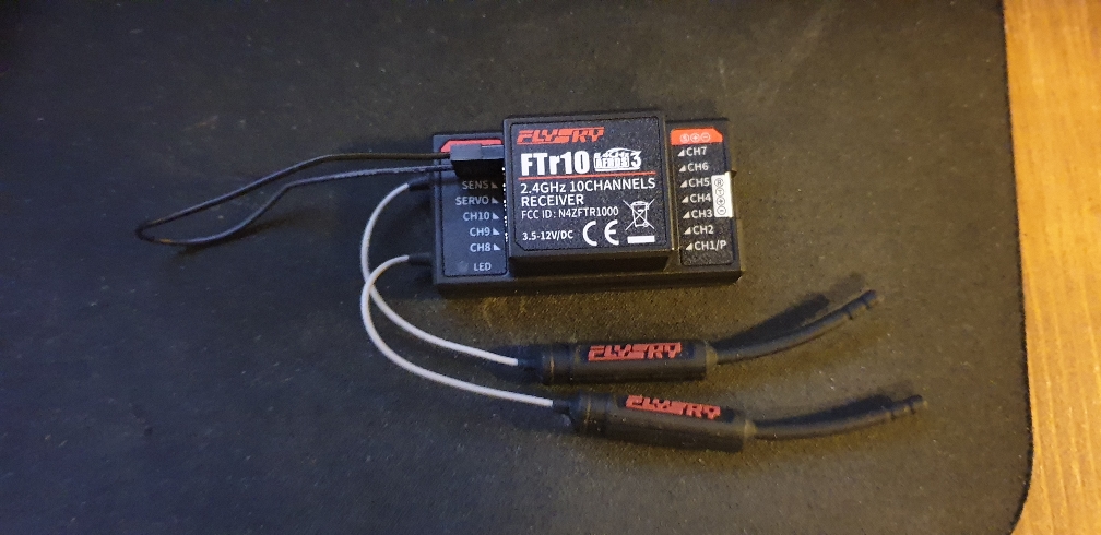

Noticed you used the FTr10 Receiver on a TRX-6, did the receiver fit inside the trx waterproof receiver box? I'm looking for running the same setup for my TRX4, but really want to maintain some waterproof capabilities.
Ok so I rebound the reciever about 30 times and it didn't work. I went and ordered a new fs-cev04 that actually said it was for the noble 8 channel. I guess I'll have to wait to see if there is a difference between the new ones and the old ones that came with the It4s. I'll report back when I get them in.

The Fs-cev 04 that I got with my It4s has the same markings as that video. I have watched that video probably 10 times trying to figure out what I'm doing wrong. The one I ordered looks like the 2 I already have with there same number on it. The one I ordered said it was for the noble 8 channel setup but it is still the same part number, everything looks the same.

Ok I have a update. So i ordered a new Fs-Cev04 from China that said it was for the noble 8 channel upgrade and it just arrived. I plugged it in and assigned the channels in the ibus menu and everything works! Didn't even need to rebind the reciever. Maybe the new Fs-Cev04 has something else as far as electronics or firmware? I don't know I'm guessing.
New one on the left, old one on the right.
