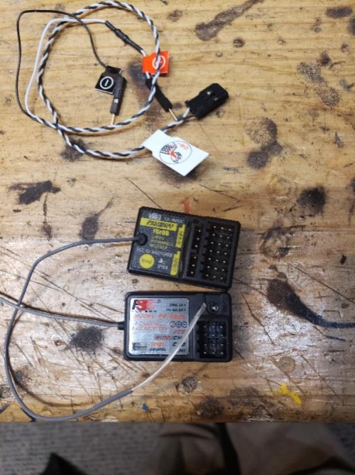

Flysky released a proper 8 channel receiver for the noble the fgr8b. It is almost the same foot print as the old 3 channel receivers, just a hair bit taller. It comes with a wire to send your pack voltage to your transmitter. That does require a firmware update which wipes out your models. I think there is a program to download your settings beforehand but I didn't see it until it was to late. The update seems to fix the problem with channels 5-8 not working when switching from a different model.
