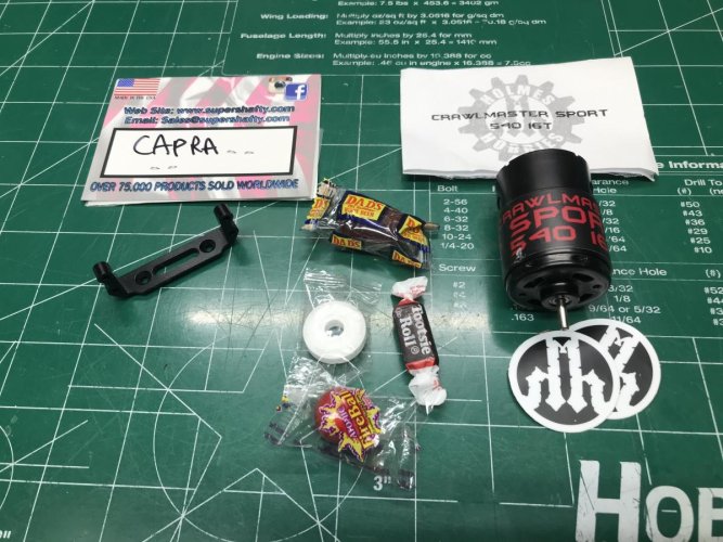

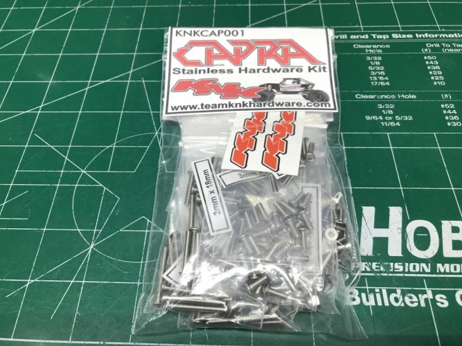

My SuperShafty servo mount arrived today...Yahoo. As for the screw kit, I'm curious about something. In one of the RCC threads, someone brought up screw materials (SS, carbon steel, Ti, & aluminum), and which was better for which purposes. The "general consensus" appeared to be that, for crawlers, carbon steel was the best (for off-road racing, a mix of To & carbon steel is the "winning combo"). However, now, I'm seeing people mentioning/buying the SS kits, and I'm wondering, is SS better than carbon steel in crawlers? Any 'assistance' in this matter will be appreciated.

The SuperShafty servo mount is nice! It will defiantly get rid of the flex I've been hearing about that the stock plastic mount has.
Team KNK SS screws are a must have for all of my builds!:)

As for the screws, I run Team KNK stainless steel screws in all of my rigs. I have never had issues with broken or stripped out screws. I am not a big fan of rust and rusty screws, so that is why I chose to go with stainless.

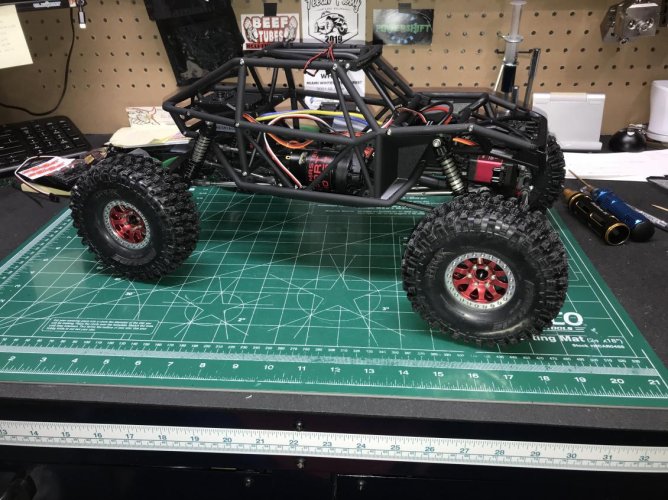

Time for an update!
I haven't had much time lately to work on the Capra, but was I was able to sneak in a few minutes each day over the last week.
So to get this build up-to-date, here is what I have done so far.

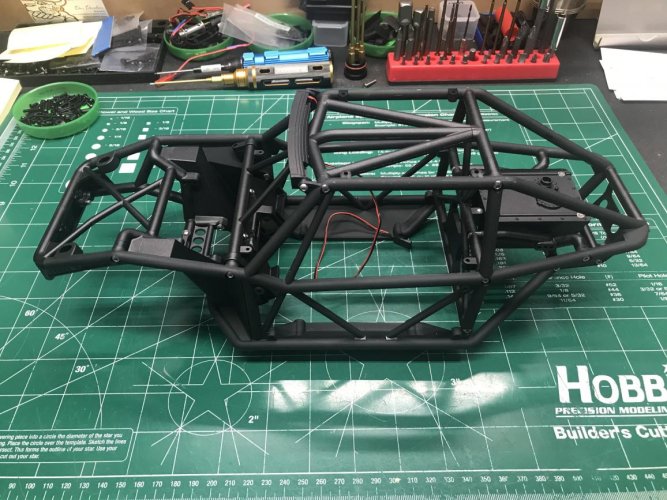

Cage feels nice and sturdy after it is bolted together. I like the look of the material Axial used for this cage. It has more of a "flat finish" look to it compared to my Wraith and Yeti.

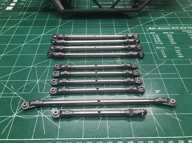

Links went together easily and quickly. It seemed much easier to thread the links into these newly designed rod ends. I like the fact that the length can now be adjusted by turning the link in or out with the included hole in the link. It takes my way back-in-the-day when I ran my AE RC-10 Offraod buggy. It was nice to have the adjustable turnbuckles to tweak the camber/caster and toe in or out.
Shocks went together nice. The feel really smooth and have not had any of them leak a drop of oil yet. I ended up using a piece of nitro fuel line on the shock shaft cut to 8mm length. That roughly get the total length of the shock to around 90mm long.
I took the advise from Dezfan and used the stock Element Enduro springs from my Enduro and added 60wt shock oil. They feel buttery smooth and should work well with the thicker oil. Thanks Dez for the tip!"thumbsup"

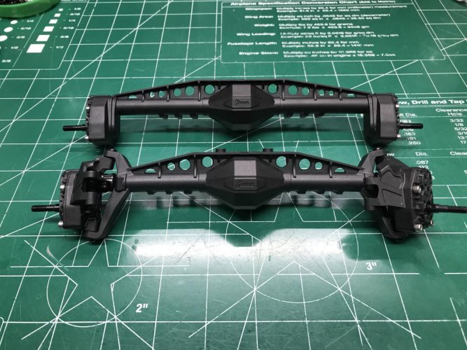

No problems building the axles. They went together good and seem to have a good steering angle with no binding at full lock. In the future, I may cut of the stops off and put a slight bend in the front steering link to get a few more degrees of steering.

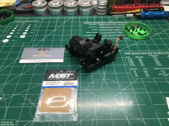

The trans went together fairly smooth. The manual was a little tricky to follow, but nothing that I couldn't handle. I did use the shims that SVT used in his build. I ended up using 4 shims in the idler gear case and it seems to have spaced it out just far enough so the gear will not rub on the case. Thanks SVT for that tip!"thumbsup" I guess I will owe you a pizza too!:ror:

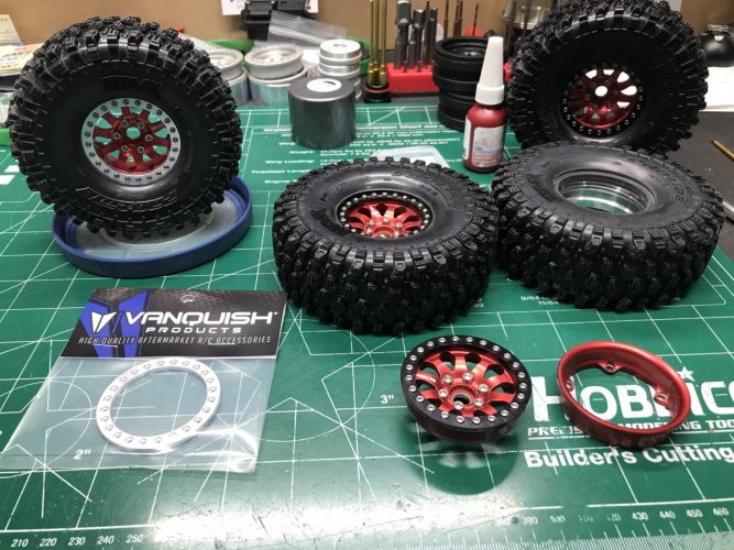

I had an extra set of VP Method 101's with Hyrax G8 compound sitting on the shelf, so I figured these would be a good match for the Capra.
I picked up a set of VP clear beadlock rings to replace the black rings. I like the looks of the clear better than the black and they will look better with the paint scheme that I have planned for the body panels.
Yesterday I spent the day painting the body panels and interior. Also added wire extensions to the servo, ESC and DIG servo so that the would reach the receiver box/fuel cell in the rear.

Good call on the clear rings, those wheels are killer with them on there. Enjoyable write up and thread as always.
Looking good. What hubs did you use for the wheels and how is the clearance on the portals?
Thanks!
I'm using 350 hubs. Clearance looks good. I may try at set of 225's when I get some. Not sure though if the 225 will work.
