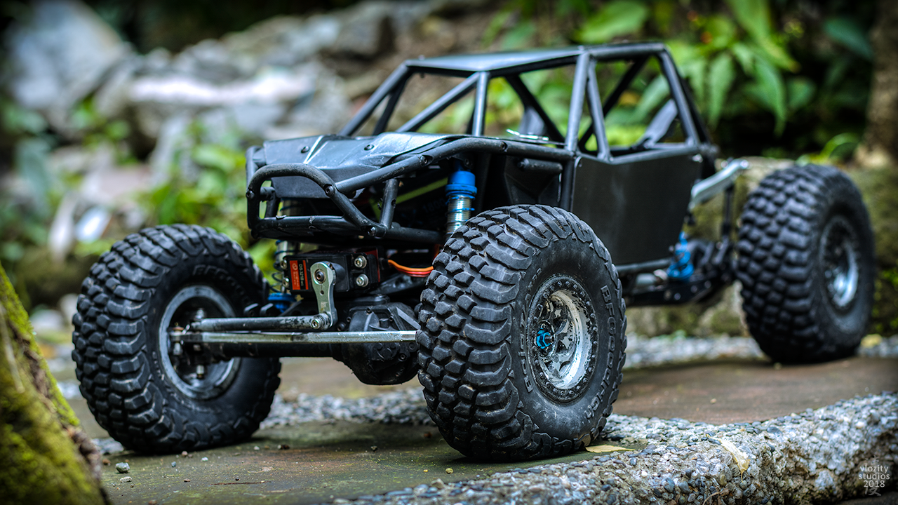

Here is a shot of both rigs...

Nice! I specially like the front shocks pushed forward to the axle... it is something I want to experiment with...
One question: that servo horn isn't too close to the tie rod?
the kit version manual states that the shock be installed on that forward hole. i actually have not run the new bomber yet, waiting on my CI foams before testing.
Actually there is clearance on the horn and tierod, it is the ball ends that hits the tie rod. what i did was move the servo up by 1mm (not shown in any of the photos), this removes any binds and scrubing.
forgot to mention i had to lengthen the steering rod so that i can use the bottom servo arm position for more angle... this created binding which wa resolved by moving the servo high.

@Zka17 my bad, the manual had it on its default hole on the lower part of the axle. I was just too tired and did not want to screw it on that hole, used the spare screw and plastic ball area on the manual... i may return it to default position, having shocks angled way too much make the rig climb harder (at least thats what i experienced on my scx10 rigs)

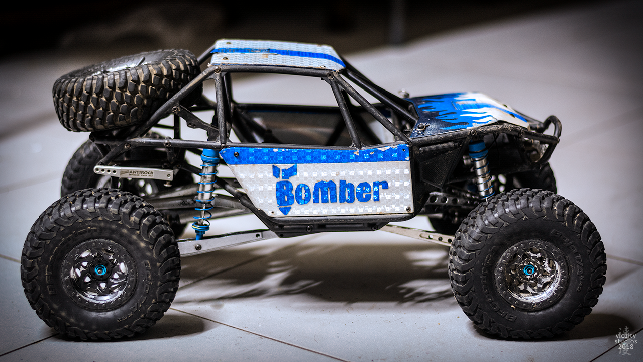

started playing around with some 1mm carbon fiber sheets to make custom panels for the bomber. i think it's satisfactory, nothing over the top specially since i justed used scissors to cut the sheet and some sanding to make it clean.
now i just need to figure out how to do the hood. :D
