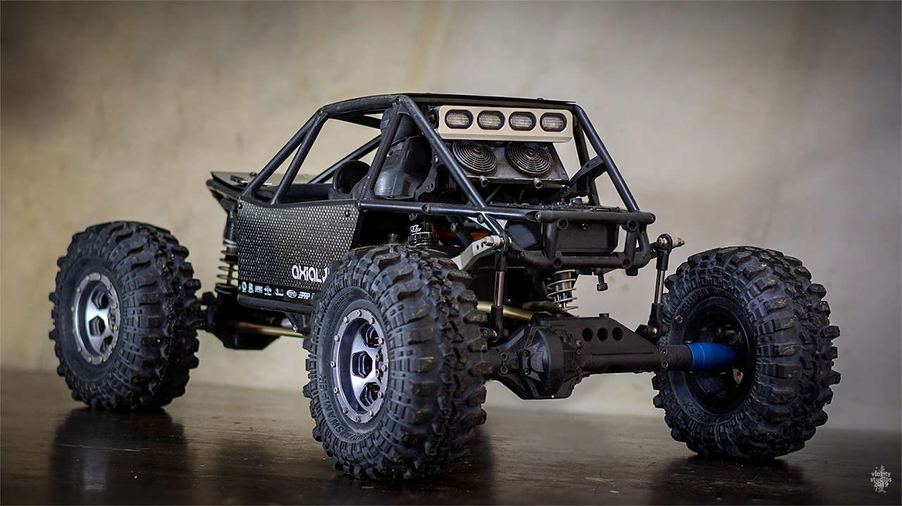

finally finished the custom carbon fiber panels...
thanks for viewing!

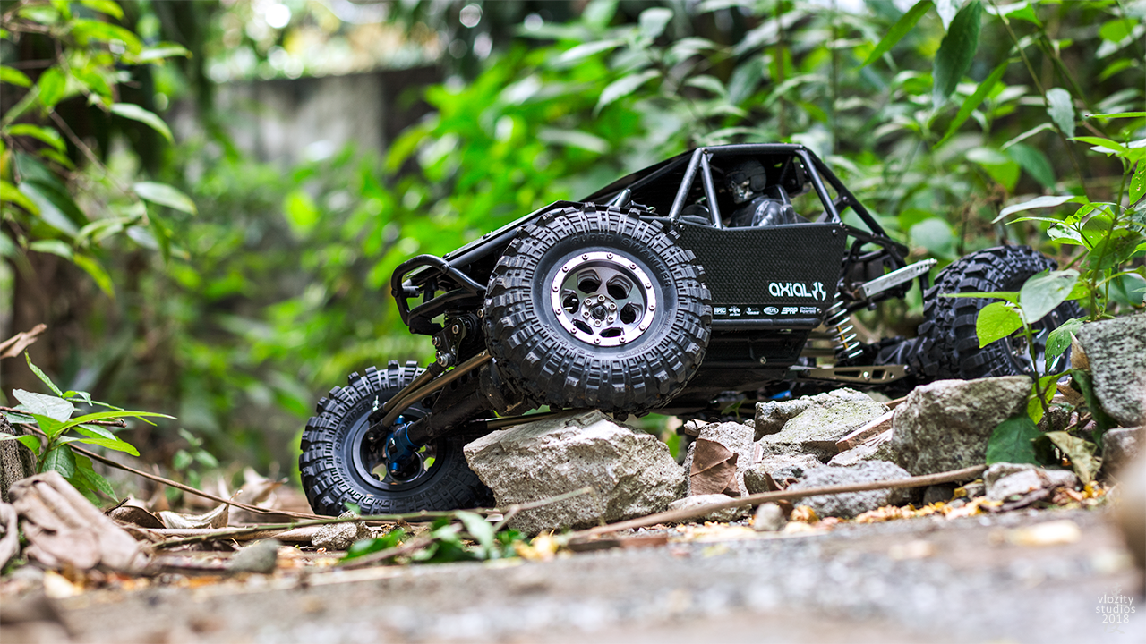

my initial run yesterday was good, still a little bouncy but the DIY foams are brand new and a bit stiff. ordering the crawler innovation 2 stage foam, but it will wait... holiday rush here is really bad, so I will be ordering them 1st thing next year.
running on flat ground is not a problem with an unsensored motor/esc. the rig is so stable even in tight turns... i am loving it. would like to get it crawling one of this days but would like to replace the motor/esc to a sensored one before i do.

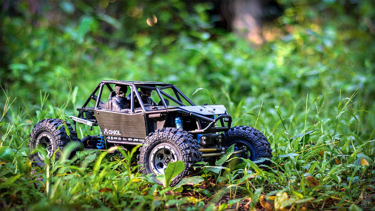

still working on the rear section...
no colored blinker lights in the rear yet, had this build on hold for weeks and have not even mounted the rad properly.
thanks for viewing!

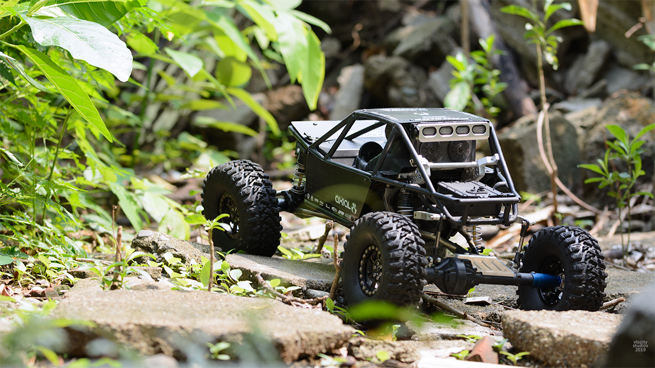

finally got the rear led lights painted. just did not have translucent yellow for the 2nd led on the left... i think this will do for now.

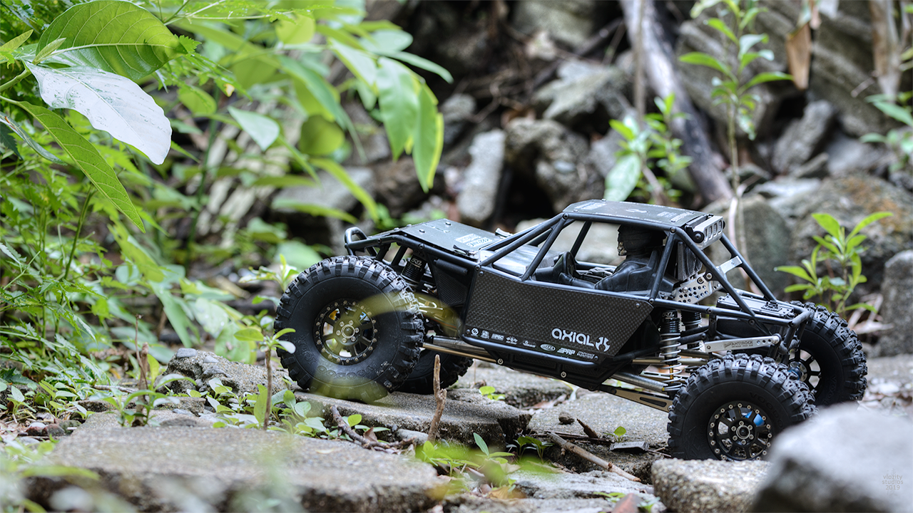

I'm trying some new shoes, voodoo with 2 stage foams and SSD wheels (not a fan of this wheels... they are so plain looking).
We are having another C3 comp on the 14th, this new setup should perform well... but still thinking if i need to put some weight on the front tire. still looking into that.
thanks for looking!

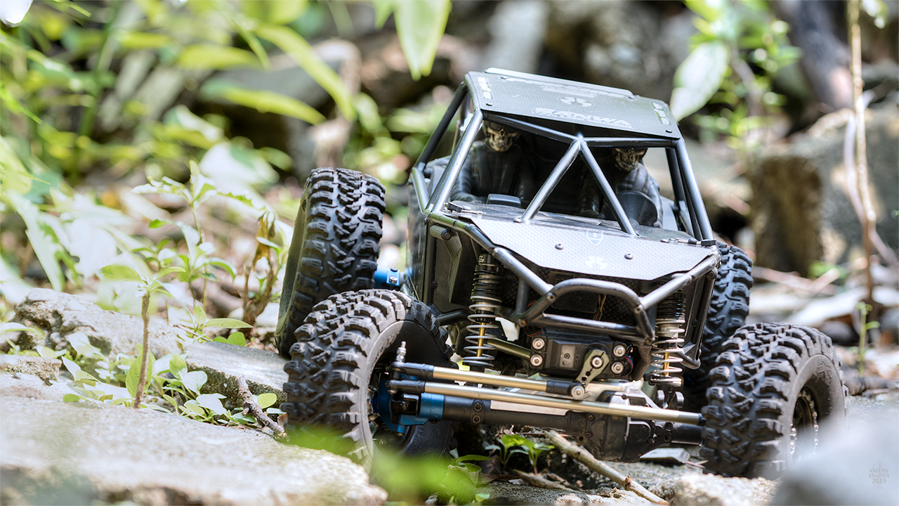

changed a few things on the bomber, not sure if you noticed the previous changes... replaced the plastic rear shock tower with Boomracing Shock Tower With Strut Bar, also replaced the lower axle link connectors. Last week I got an Aluminum Front Offset Axle Link Mount from Boomracing.
Thanks for viewing!
