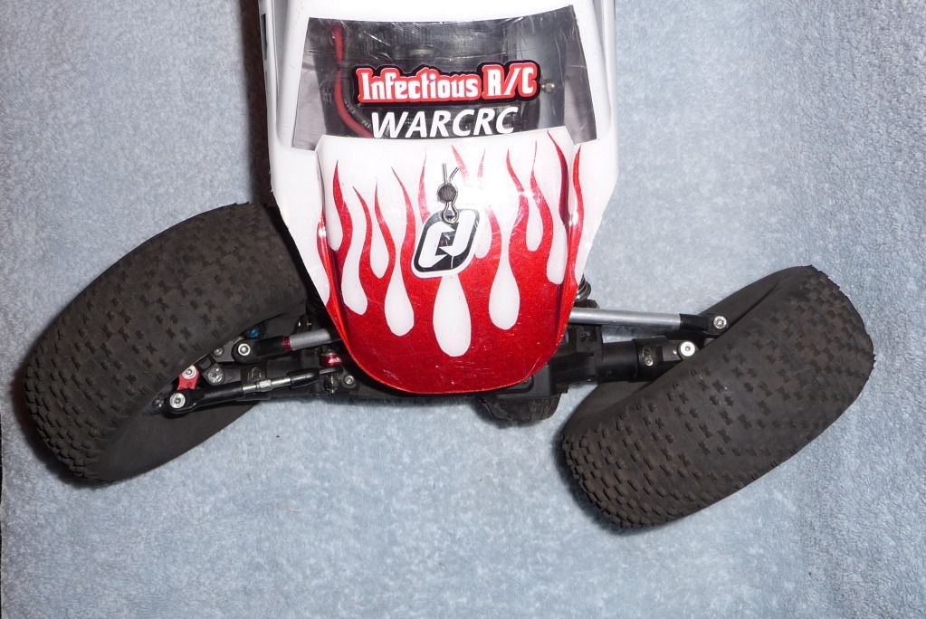

No problem guys. I have been away for a lil while. Some of the courses we were setting up I just wasnt able to make some of the sharp turns, the steering def helped, but still not quite enough to make a clean gate. I will be updating the thread in a few days with some new pics. I plan on trying to get out tomorrow and will snap some poser/action shots!

I do have a question. I am strongly considering switching to a AX10 this sporty season for the steering alone (only reason). Love my Losi, but I can't get my Losi's steering throw anywhere close to that.
My question: to get that steering throw, you are running
Front
Wraith Knuckles
Wraith Chubs
XR10 Universals (?)
Long Beef tubes (?)
What else am I missing?
Rear (I know this has nothing to do with steering, but if you did the long beef tubes...)
What axles
What lockouts
Thanks, in advance.

You got it right on the front end. The Vanquish XR10 steering link works perfect as well with the wide delrin toobs. I have XR10 lockouts and XR10 axles in the rear.
My next plan of attack will be the new VP lockers, blue Monkey RC front knuckle weights, and the New premium delrin tubes. I have a new axle housing waiting on them! Im also looking to see what I can come up with for rear weight. I tried running it as a "lightweight" rig like most guys are going to and I didnt like it.. Before I made all of my changes this this was a tank and drove better than it does this light.

OK, sorry again. I spent a day reading through various posts on what the "lastest" ideal front axle set-up is and I'm still confused with the crazy mix of parts people are using.
What do the Wraith Knuckles and Chubs gain you over the XR or the Various Vanquish AX-10 parts? Are you using stock plastic Wraith parts or upgraded aluminum ones? The purpose of the delrin "beef tubes" is to add regidity to the axle housings? Is the axle width changed when using these or are the housings shaved down to compensate. Then there is all this talk about setting custom caster by drilling your own fixing holes.
There are some combinations of chubs and knuckles that allow for more steering throw than others. The wraith knuckles allow the most (why, I don't know), but in some of the builds they are getting the most steering throw out of them. Example....
Wow, that almost hurts to look at it. Granted these are AR60 axles (but that does not matter).
The beef tubes are for extending the width of the axle so you can run the stock XR10 CVDs. There are so many more options for CVDs for the XR10. One side benefit being that you can also run the options for the knuckles and chubs. Another side benefit is (you are correct) it adds rigidity.
Aclark is using the VP knuckles and chubs (aluminum). If I go the AX10 route, I am going to start off with the stock (plastic) Wraith Knuckles, chubs, and lockouts and see how it goes. For my 'try and see' $10 is more palatable than $100 for the VP versions.

Yes, it is amazing ANY universal will operate at that angle. My real concern is having all of these pieces line up and actually function correctly. Vanquish has a nice universal set for the Wraith, but you'd have to have then in an XR length to work with this setup. Is there a track width limit in "sportsman"? I am assuming so since you could just run long tubes and adjust accordingly.
Is the desire to have parallel steering or just the most you can get at each wheel end? I have experience setting up steer arms for real cars and am very familar with various Ackerman designs (rear/front steer otrb placement). I think these sensitivites get lost when people move to BTA steering.

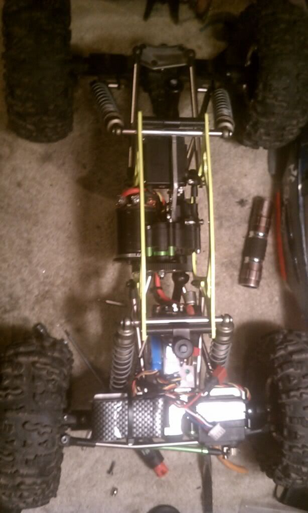

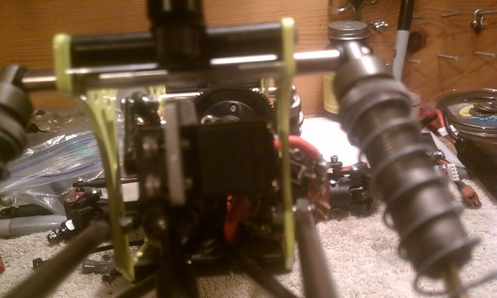

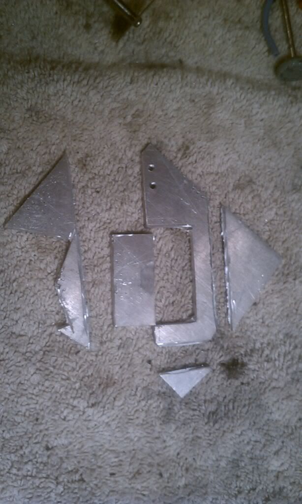

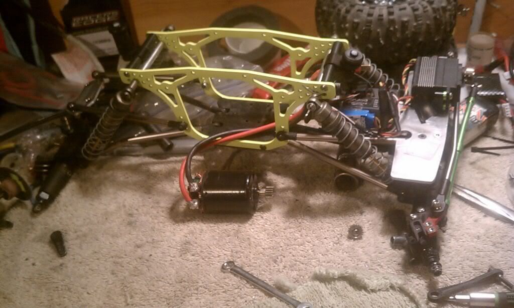

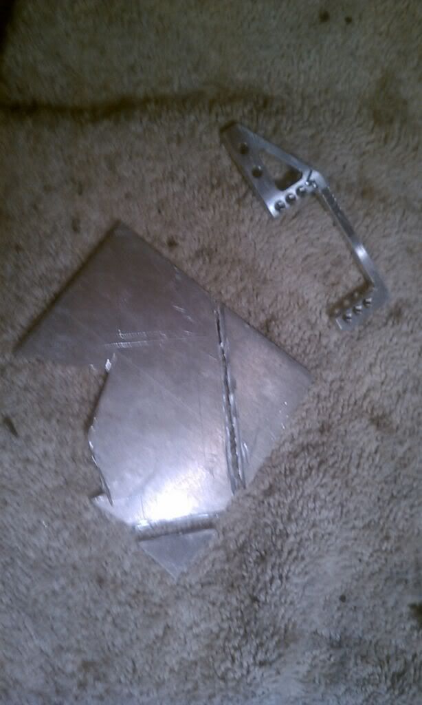

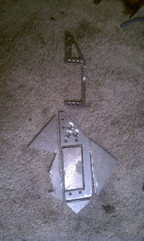

Ok more came... Well, Andrew seemed to have burnt out his mini servo, so he figured he would run sporty in the pro class. Well, I did that the first comp an tied for 3rd, 4th, an 5th from last sucked! Went with dig for the second comp, running a shafty is still a disadvantage... So against his main thought of weight, I did what I had to to get him dig an this is how I started..
Make some lines an some guesstamations, haha... An start cutting..
Then do some grinding, drilling, An scuffin..

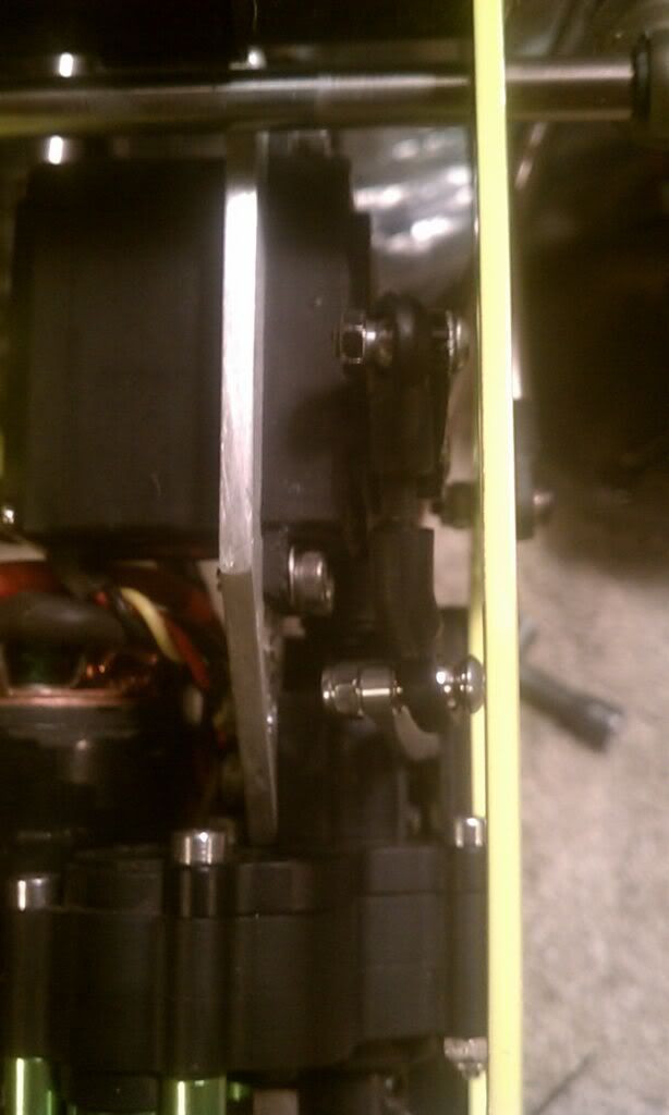

A couple fancy, weight saving, holes an vala... A full size servo mount... Made with a dremel, a drill, an A hand stone...

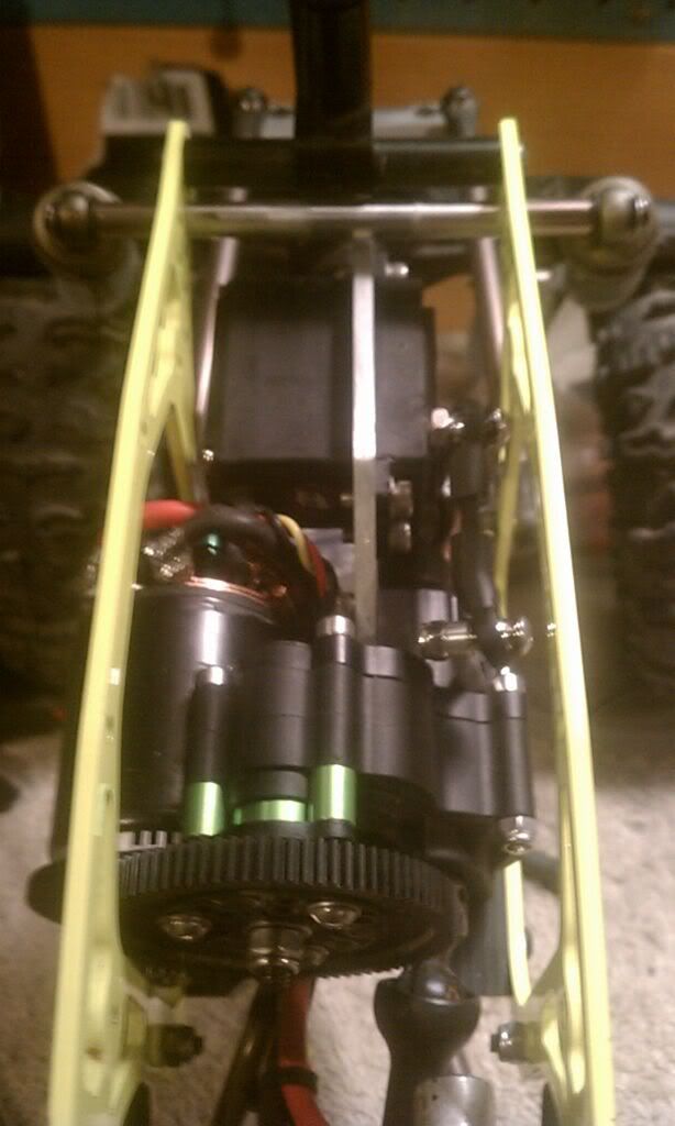

Put it all together an back in the rig an this is what it looks like... Not much room left an still forward bias..
Threw the tires back on an hit the rocks for a test run, 230 a.m..... Oh an setup the end points.. luckily, I have the same remote... So it wasn't so bad.. runs great! Dropped the 19t pinion for a 16t an its still has sct ability but can crawl with torque an dig with plenty of ability! Maybe a 14-15t pinion yet.. for tomm... tires, foams, an weight for the front end.. there is none as of now...
