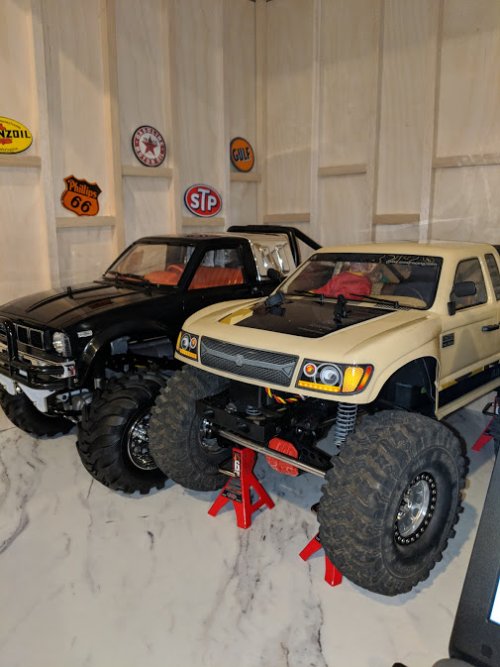

Well I went down to my LHS The Crawl Space in Denver, to grab the final things for my xr10 mod on the OG Honcho. I also grabbed a few scale items for the Honcho ii. Peer pressure set in and I grabbed some Hyrax for a comparison...
Decided to keep the body I painted over the weekend for the OG, it's original body was beat. Trying to decide between another silver honcho body for the ii or a RC4WD 4door tacoma, I'm not a fan of the sandstorm. I'll decide by end of the week and make it happen.

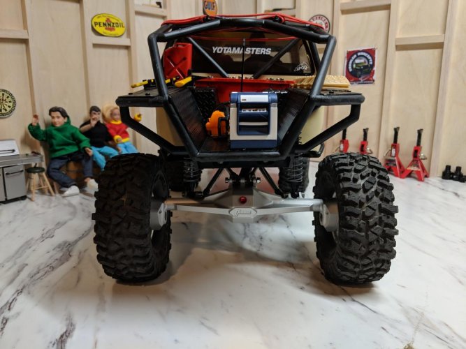

And one of my workstation/shack area in the cave

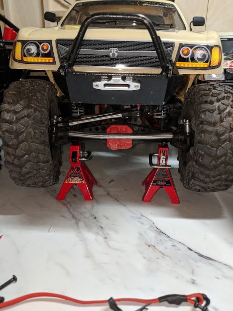

So I made an order from VP when I noticed they had links in stock. I grabbed a few other items and as I neared the free shipping I threw in a pair of lower shock mounts....the new axle under the Honcho has them molded in already... fanboi strikes out.
NBD, small mistake. Glad I made the order as it allowed me to finish the front end. New knuckles and links should have this about where I want it.
Front bumper and sliders are on order from scaler fab. The wheels I ordered for this build are taking longer than expected so I ordered another set that is similar in style to what I wanted. If they arrive on Saturday as scheduled I may mount the PitBull tires and take the Honchoii on its first drive. If they don't then the OG Honcho will have a double header weekend with a comp Friday and a trail run Saturday.
Here is the ii with new links and knuckles.

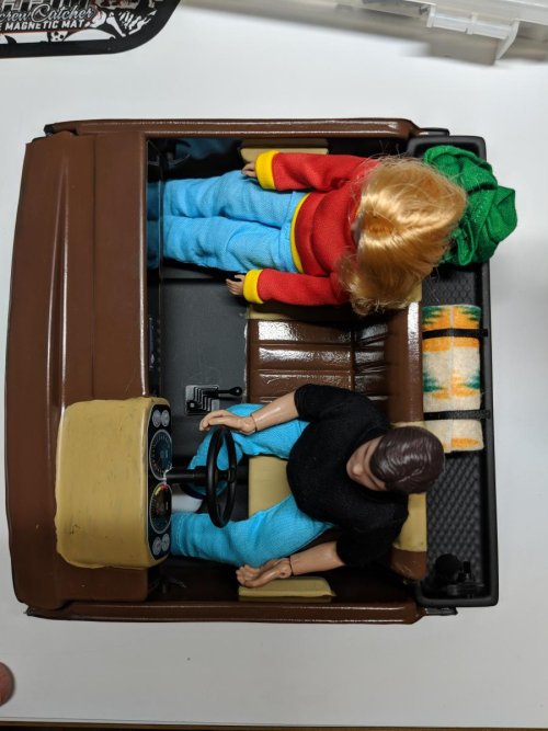

Today I got around to putting the interior together. I have thought this sandstorm body needed an old man tan interior since the day I bought the truck. I decided to go with a two tone with a brown and tan on the bench, dash and door cards. I had an axial interior and exterior accessory tree to add stuff so I put door handles on the interior cards and outside the honcho body. I also added windshield wipers and side mirrors on the exterior while the interior got fitted with a gear shifter, steering wheel and fire extinguisher. I had driver and passenger for the interior waiting and went ahead and put a hooded sweatshirt and a fleece blanket on the back deck for unexpected cold weather at high altitude.

Yes that is the Dinky Kit and thank you. I need to affix it to the inside of the body instead of it just floating/crammed in and also some seat belts to keep my passenger out of the drivers lap....

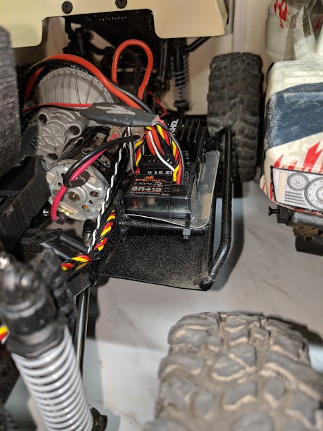

So I got my ScalerFab order in. I went with the comp front bumper and the sliders. Really like the way the sliders hold everything on this truck and the scalerfab pieces fit that bill exactly. I copied the Harley budget build and added a small piece of aluminum to mount he esc and rx after losing the factory waterproof box. I am not too concerned with that part as the spektrum sr410 is waterproof as well. This truck does so well I am quickly beginning to leave the OG on the shelf more and more. (as it goes shiny side down:sad::sad::sad:)

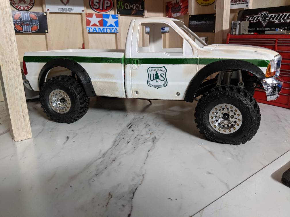

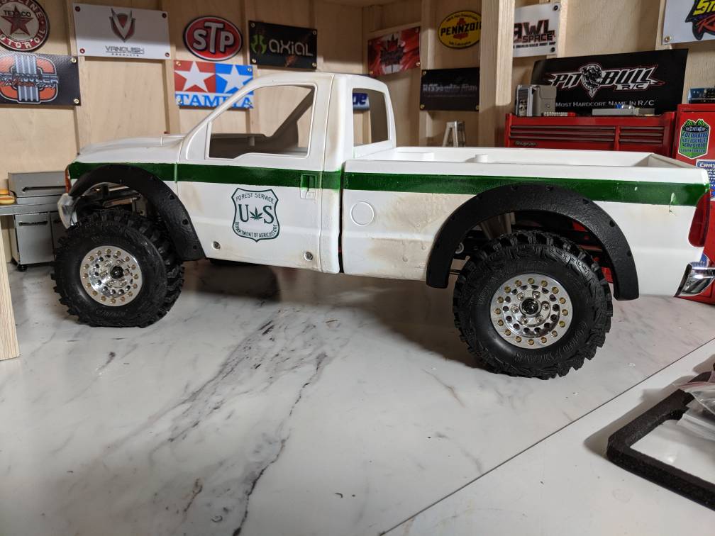

Well I turned the ii into a zero. Class zero. The f350 body is a bit on the smaller side so this made the most sense to me.
I already had a great start so I kept most of what was going and just finished it as I saw necessary. I got some super shorty big bore med 80mm shocks and had some links built to locate the axles in the wheel well correctly. Some CNC custom wheels with ci foams and rc4wd MTR tires finished the look. I got a 7954sh hitec and currently have the f350 bumpers on it. I still need an interior and windows but so far the wheels and tires are covered by the fender flares and the lights installed in their places. I need to figure out an opening door or hood or tailgate as well
VP knuckles
Boom racing universals
The Crawl Space custom links
VP Trans housing with metal gears
Axial metal motor plate
56t 32p spur
12t pinion
Holmes Torquemaster Expert 550 21t
Ae2 esc
Castle Bec
Hitec 7954sh servo
VP shock hoops
Traxxas 80mm shocks
CNC custom 1.55 beadlock wheels
RC4WD Goodyear MTR tires
Crawlers innovations single stage 3.5 foams
Tamiya f350 body
Random scale stuff
Really happy with the how the links and wheels and tires that are on this truck all came together. Now to get the electronics squared away and an interior to cover it up
