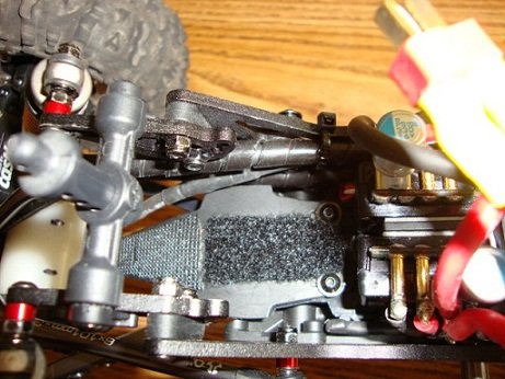

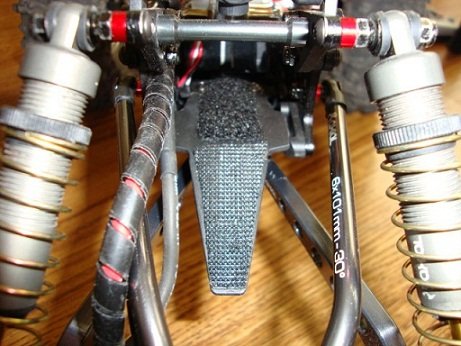

Here's a great tip for the battery mount. Can be done with what you have already. Then you can easily get an 1800, 1500, or 1300 in and have your CG as low as possible.
Removed battery tray and dremeled it, flipped it, and mounted it upside down on radio tray. Then bent the mounting tab downwards.

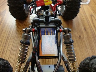

i just made a small lexan tray that the lower links clear no problems
also you can get to the esc settings with ease..

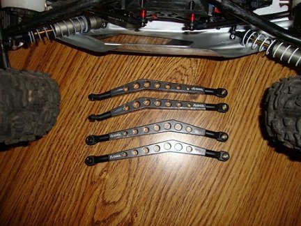

This tip is obvious to us seasoned crawlers, but will be great for the newbies.
Drill and tap your lower links to accept 4mm studs.
You will need an m4 x.07 tap.
Then install traxxas jato ends. http://www.tcscrawlers.com/Traxxas-Jato-Rod-Ends-12-with-hollow-balls-12-5525-p-17901.html
They are just like Revo ends but longer. Cut them to the same length as stock, or add a mm to each to stretch your wheelbase out to 12.5".
You can get 4mm studs from associated, venom, kyosho etc. I prefer these on ebay that are 20mm and steel: http://cgi.ebay.com/M4-x-20mm-Socke...Control_Parts_Accessories&hash=item2a0396c15a
This works best with the machined lower links but you could do it with your stockers. If you are doing this with the machined links, you will need to use the bent rod end that Bender used on his front machined lower link. Just tap it to 4mm. It is plenty thick.
attachment.php
The machined links pictured below have been upgraded
This tip will give you bulletproof links so you won't have to worry about those 3mm ends breaking, or pulling out.
