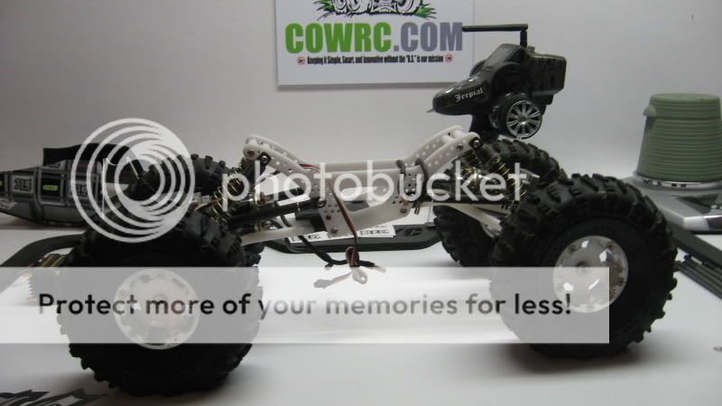

Finally got this thing back together today,ran a couple packs on the new set up and I am very impressed.Shaved off a bunch of weight and the rig works a lot better now.

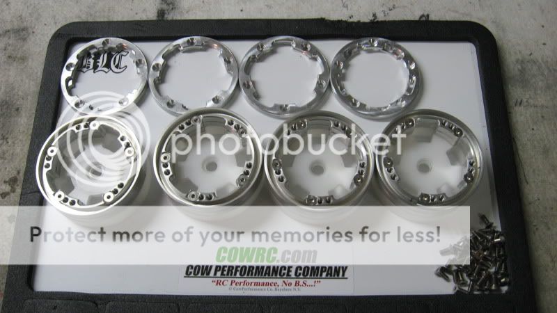

got some sick u locks from Don..Thank you!
hey zack the wheels are sick are they derlin centers. Is this a blc item. I am sure i am not the only interested person. so what gives"thumbsup"

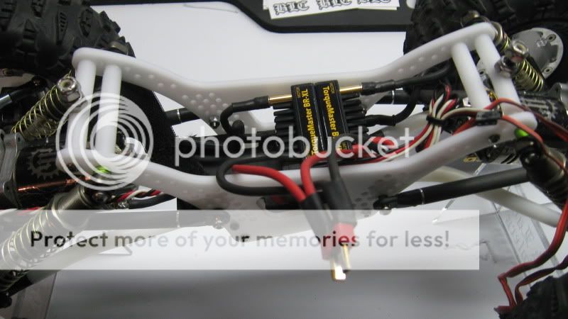

I see you have tapped holes on the top of the motor mount, what was your impression of the uppers mounted there?
I will have more chassis's available in a couple weeks.
as for the uppers,I didn't care to much for them being on the top of the moa mount.didnt seem to work aswell as with them mounted on the side of the moa plate.The losi seems to like a little more seperation on the uppers to minimize axle steer.
What is axle steer? I have mine on the top and don't notice anything strange in the handling. I really don't know what to look for though.
well best way to see exactly what axle steer is,is to lift one front wheel and watch the rear wheel as you lift the front off the ground,if you have axle steer present you will see the rear wheel move towards the front of the rig,shorting the wheelsbase of that one side creating a steering effect with the rear end. Clear as mudd...:ror::shock:
