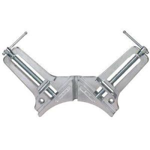

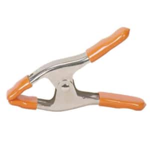

Adding to the supply list, I'd recommend the following:
Hand files - small round, triangle files (Dremel's are great but there's always something more/better/easier you can do by hand)
Metal clamps - remove the rubber tips:
One or more of these:
