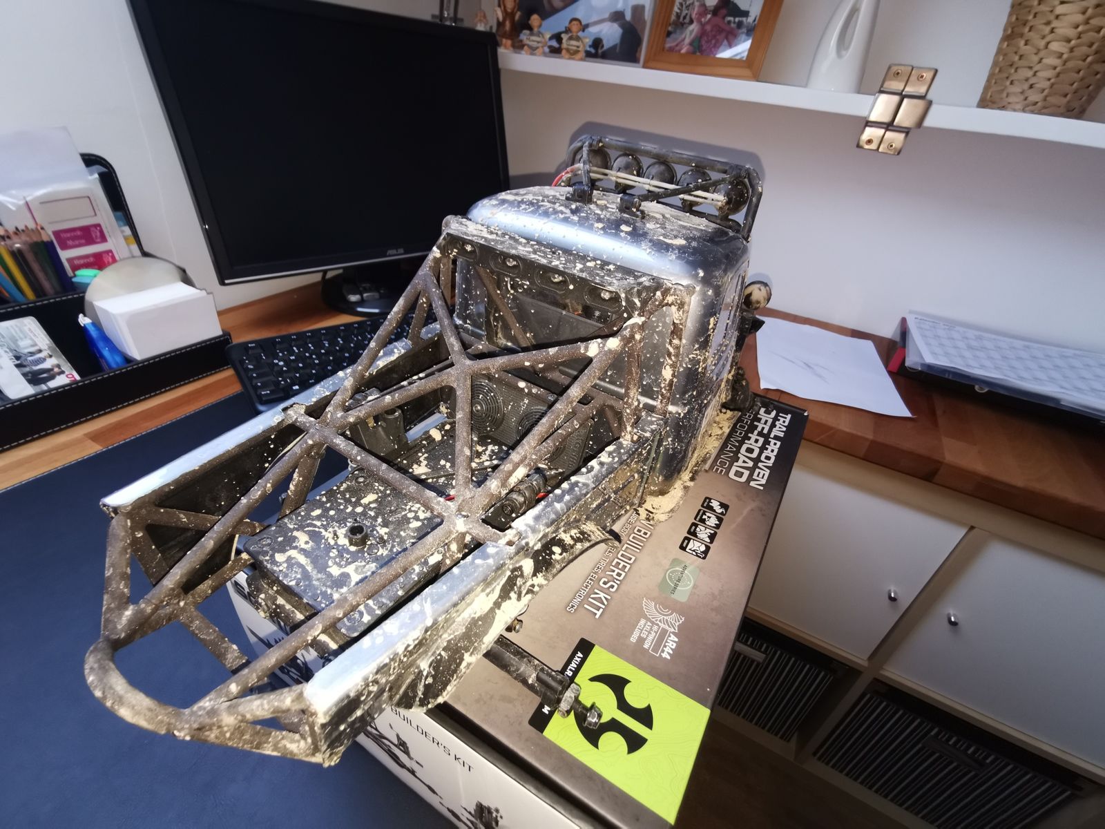

I hope so too. And if it's going to break then it just means I have to improve the design :mrgreen: It already has a lot of stiffening structure included and feels pretty tough already (probably close to what a Wraith cage feels like). In an other project I made a gearbox/skidplate from the same material and it stood up to several hours of really harsh driving with some scratches but nothing broken... I hope everything goes well and if not I've got something do to after the only event I'm doing with this rig this year :lmao:

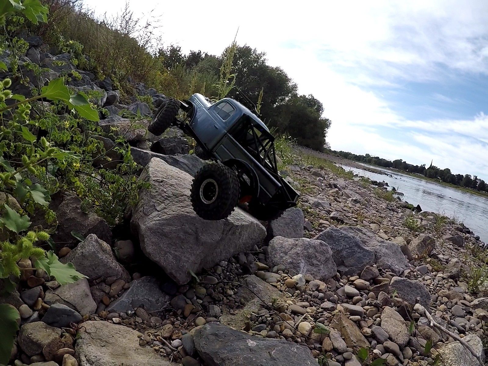

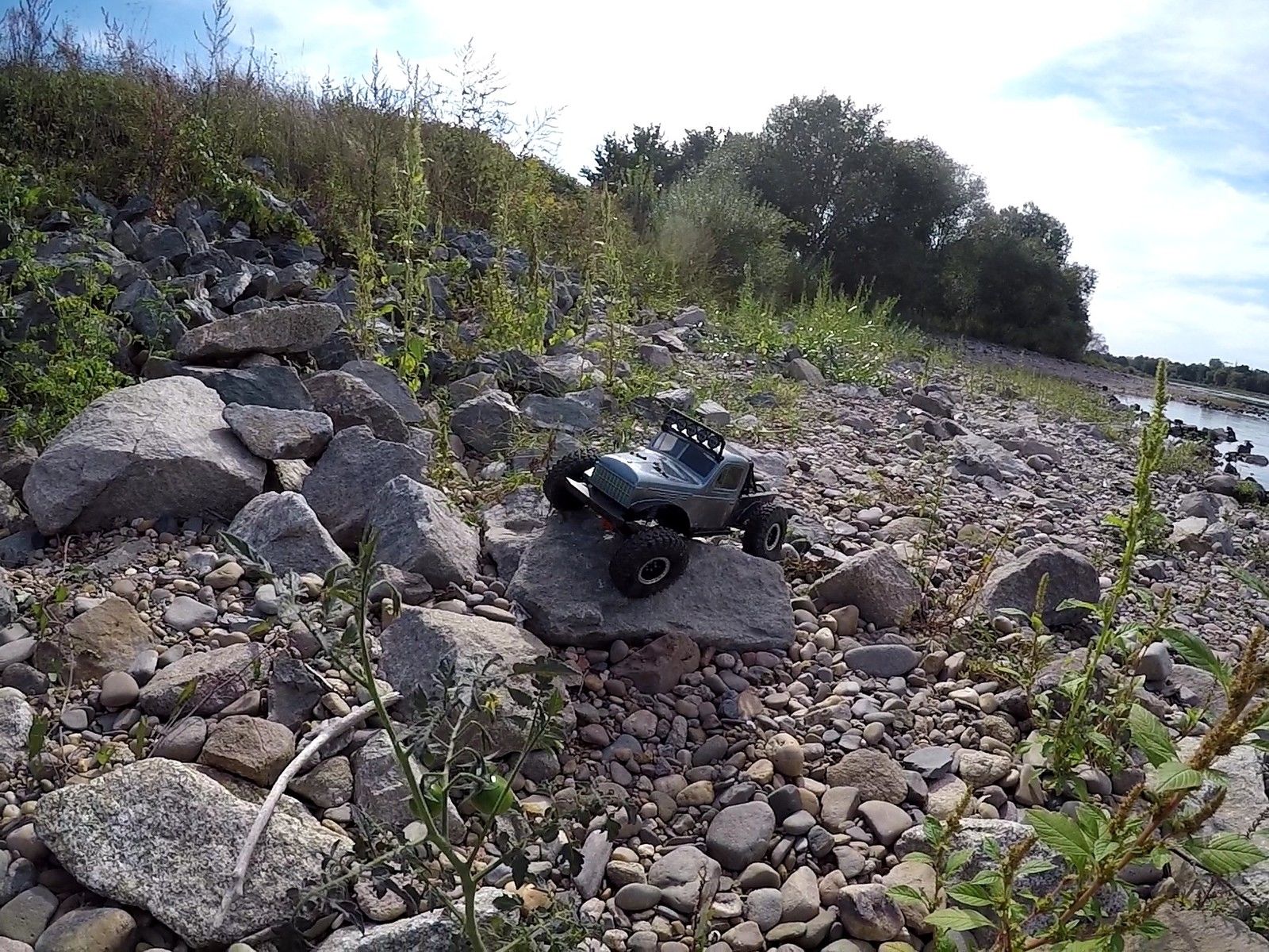

Maiden voyage happened last weekend. The car's doing great. The wider track and the overall stability and stiffness gives this car an awesome handling and predictability I was definetly missing with the original scx chassis rails...
Some pics:

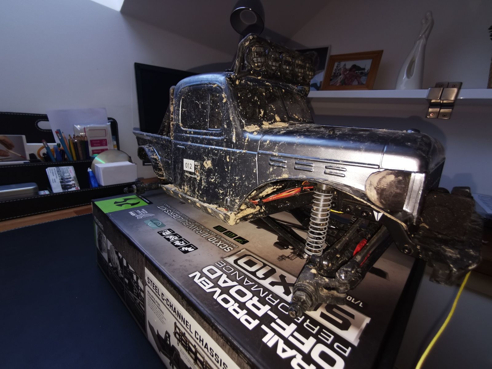

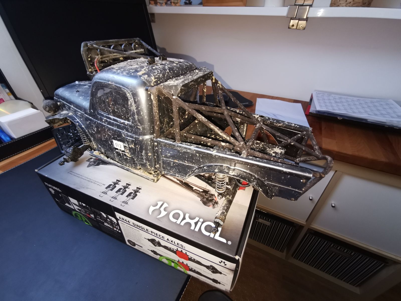

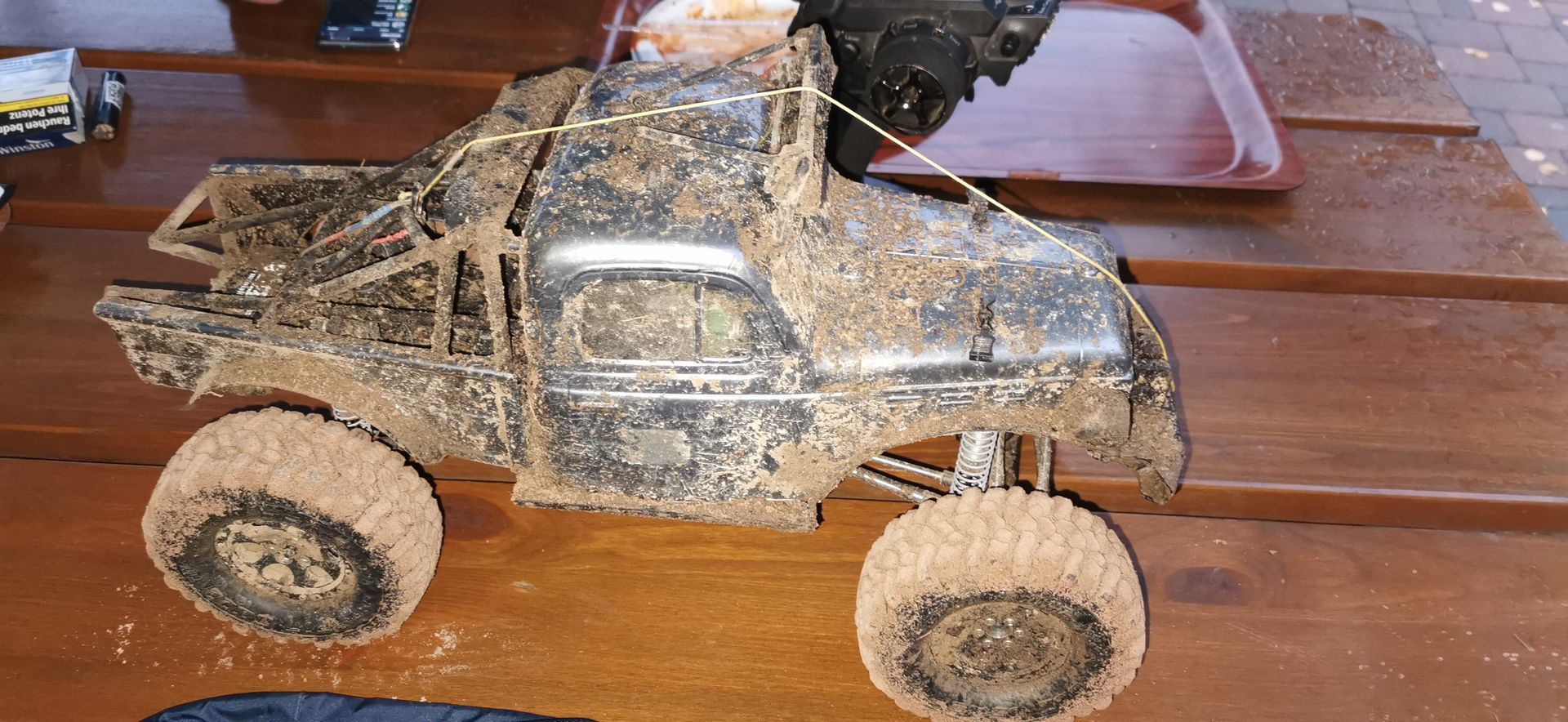

It also took some rollovers during my 45min session on saturday and the cage in the back took it all without any damage. So its off to a good start "thumbsup"
Maybe I'll find some time in the next few days to edit the video I took on my little excursion down to the river then I'll post some moving pictures also...

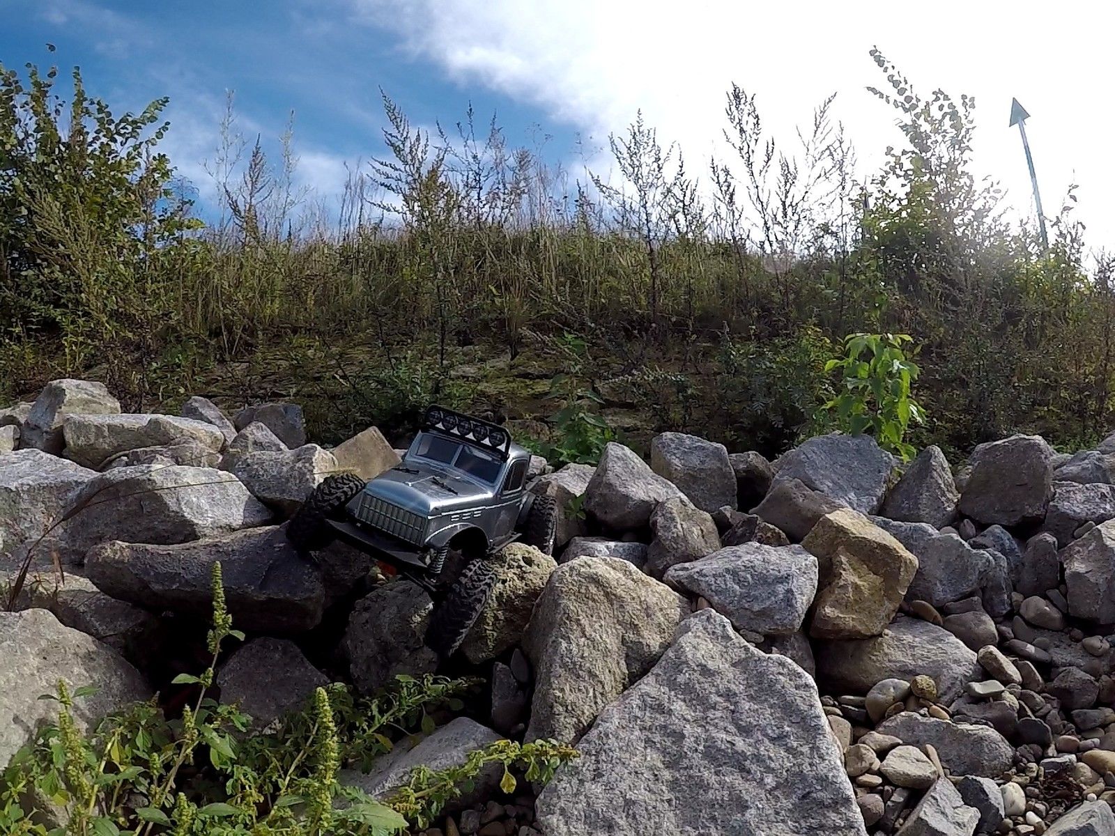

On course in the really fun rock section:

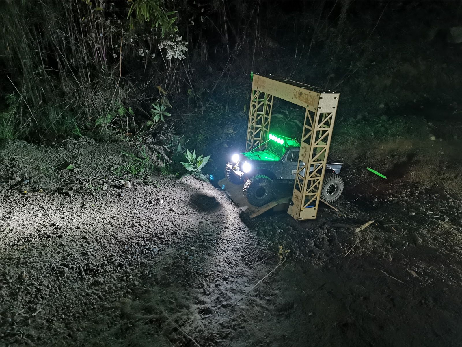

We also had fun at night running the rock section again:
838764-img-20191012-235525-jpg

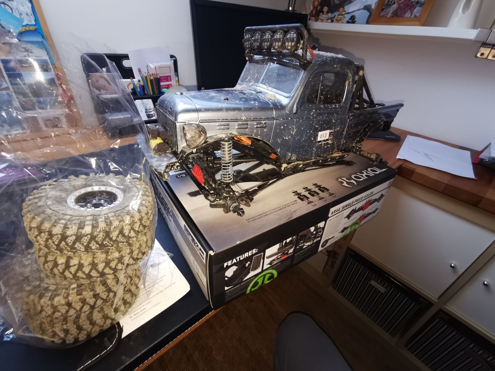

Updates for 2020 are planned already. Pics are from VP because I don't have the parts by now but they'll get here 8) Sooner or later (probably later :cry:):
These are the parts I want to buy. Everything else will be done once again by myself. Already working on an AR44 offset axle case that's going to be printed via shapeways. Originally I planned to design my own motor-forward-tranny (like I did for my RAPstar). But then VP came out with the VFD and I skipped that plan :mrgreen:
Plan is to only exchange the universals and the axle case and continue to use all the other parts of my AR44 front axle.

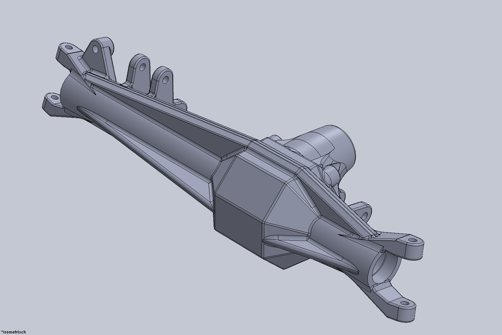

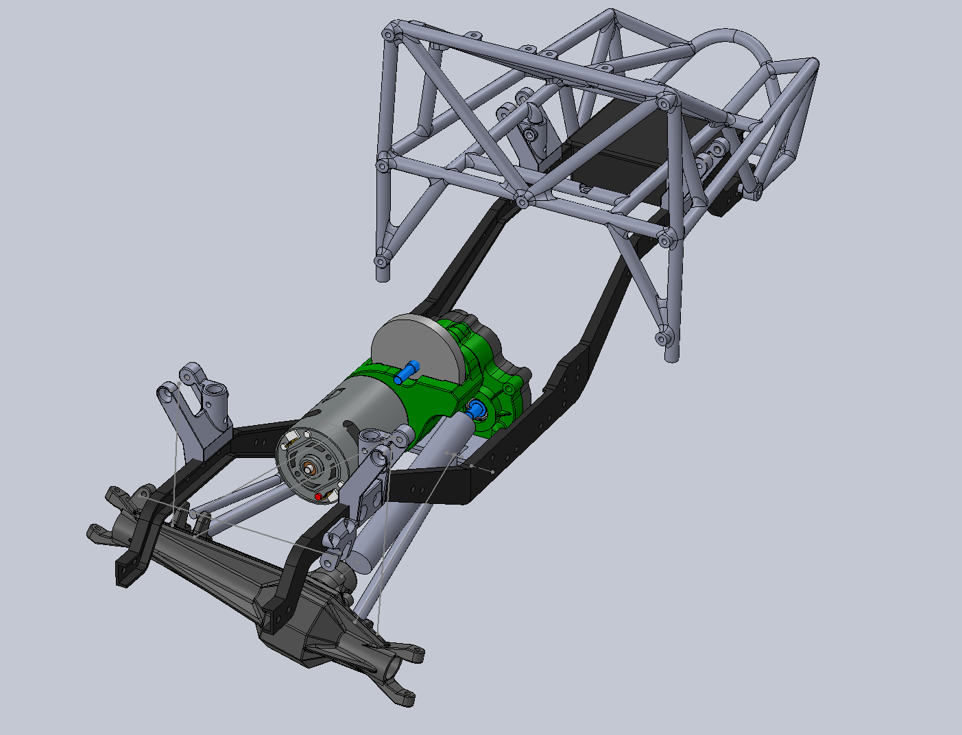

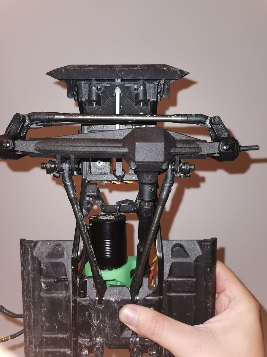

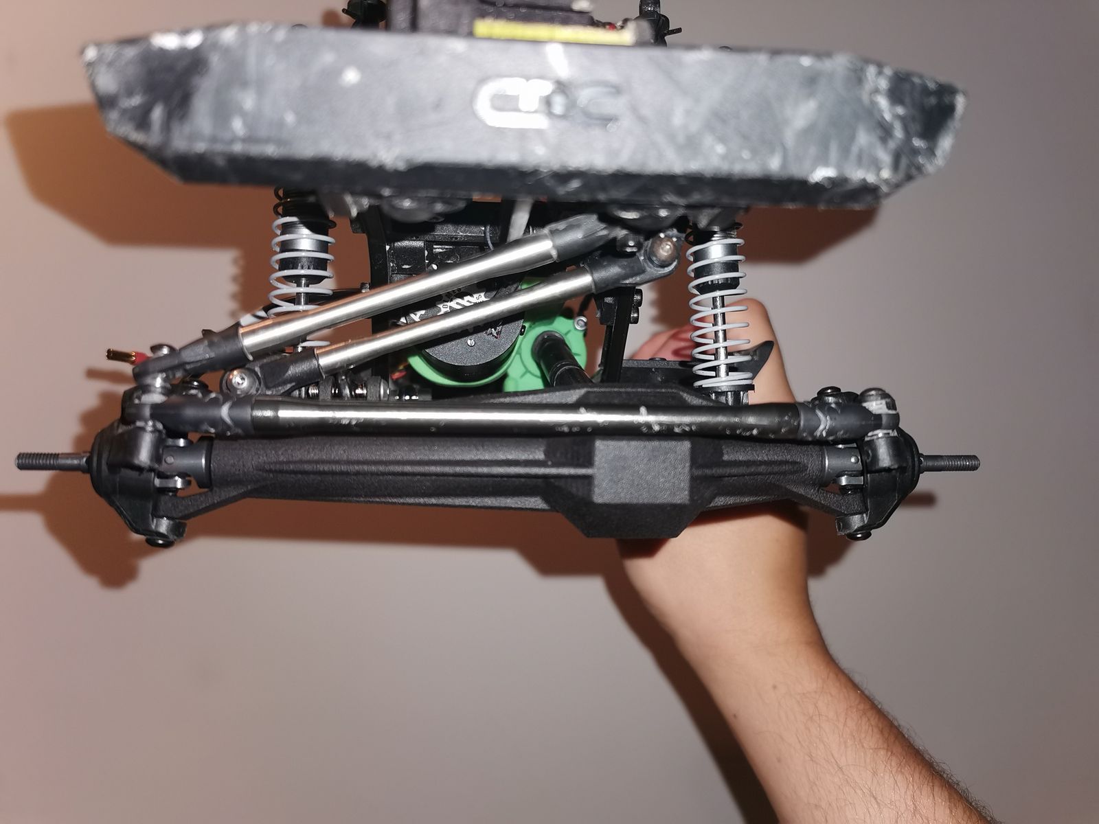

Front offset axle (diff is offset by 23mm to the side) => #FOA23 is almost done:
963645-fornt-offset-axle-png
963644-diff-png
969865-img-20200916-224055-autoscaled-jpg
969866-img-20200916-224109-autoscaled-jpg
First prototype has been torture tested over 3 mild courses and 2 hard courses (the rock section has been driven twice, once over day and once through the rainy night).
So overall I drove 600 gates + some tinkering around on the other days
-bilder achse vorher/nachher
There are only a few changes that need to be done and then it's a direct replacement for any 10.2-style axle with the use of INCISION VS4-10 VDI UNIVERSALS

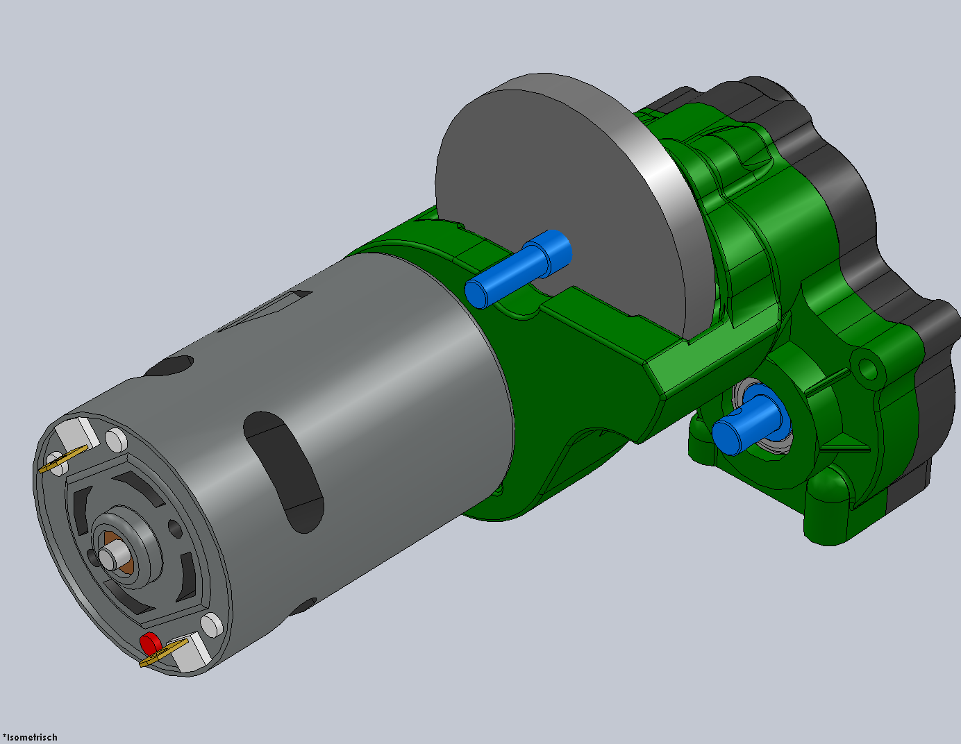

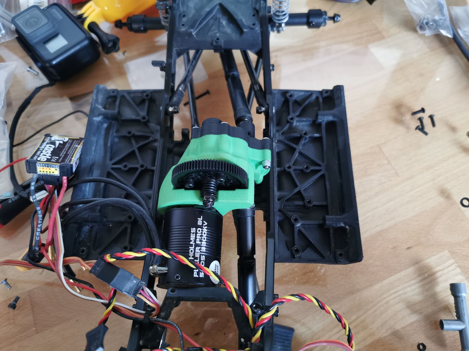

Transmission is different as planned. I didn't get the VFD trans but instead I designed a replacement front case for the OG AX/SCX 3-gear trans that puts the motor up front.
It's filled with stock internals, needs the old slipper assembly with a 52T 48dp spur gear and can be driven with a 15t-20t pinion.

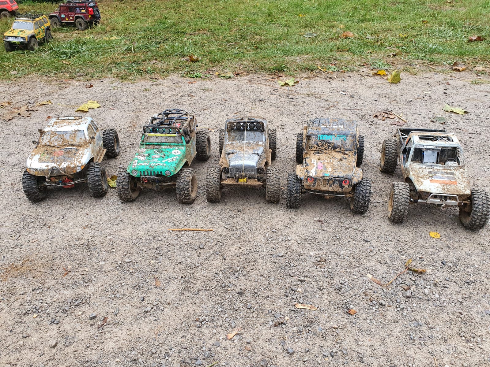

On friday in Poland we set up some #eastsidehardcore courses to test our rigs and my vsxc410II worked flawlessly.
For this year I coose a different powerplant: a Holmeshobbies Puller Pro stubby 3300kV driven by a CC Mamba X on 3S.
High accuracy down low and more then enough oomph for the casual power through obstacles that waited in all the courses.
Here are some pictures from #offmaniaRC2020 (and I'm already registered for #offmaniaRC2021 "thumbsup")

Right now I'm done with rebuilding the complete car after #offmaniaRC2020 and I've improved some stuff:
SSD-RC aluminium knuckles with knuckleweights
axial racing overdrive in the front axle
cleaned up my wiring a bunch
I'm always impressed at how easy it is to work this chassis. It can be disassembled into functional modules so maintenance gets really easy "thumbsup"

Wow really great work, I was thinking the same idea for the transmission and are you gonna publish it?
Tapatalk kullanarak iPhone araclyla gönderildi
Fantastic work on the housing and transmission - very clever!
Wow this is awesome. That axle housing turned out amazing.
Thx guys.
@levo1203 Some day I'll release it to the public. It is working but I'm not 100% satisfied with my own design as it is a pain in the a** to assemble it. So I have to redesign it, make multiple prats out of it and the I can release it. But as always I've got no schedule on that right now because life's busy :ror:
