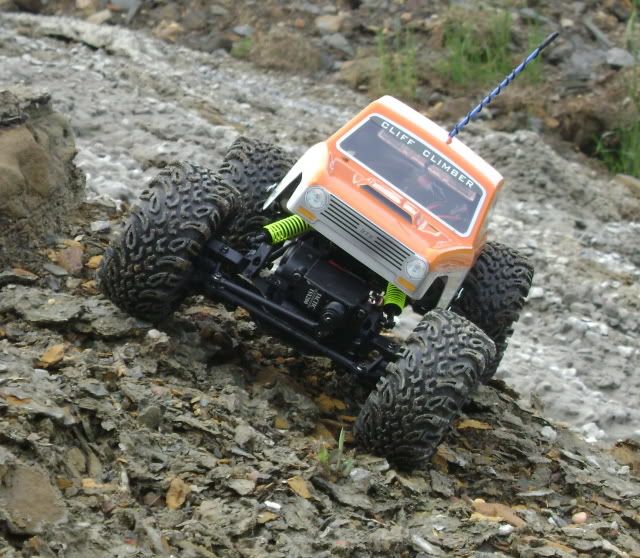

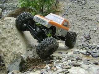

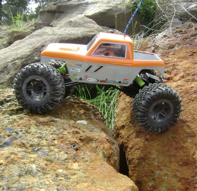

Since I had things up and running I figured it was time for some pillow crawling. I was impressed. I was hoping that it would be kinda fast for a crawler and it is. The standard batteries are so heavy that it almost compresses the springs completely so it has a really low ride height and is basically working a droop set up but still has plenty of flex. When you gun it full throttle the back end squats like a monster truck. I bet it will tote the front wheels over some rocks if you hit it right.

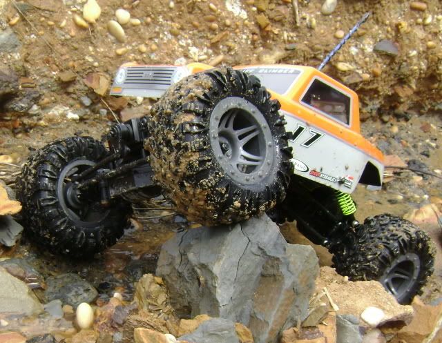

We took them out this morning and had a blast. Mine did not try to flip backwards when climbing at all. I went off a drop to fast and rolled over forward but that was driver error. When sidehilling mine stayed planted. Never barrel rolled except one time when I rolled off a ledge and that again was driver error. The Little Bro's sidehilled good but the higher weight on his caused him to flip backwards when climbing a time or two but he doesn't have his wheels weighted either. We both had issues with clod stall but it wasn't even to keep us from having fun. We kinda just got used to it. The servos could be stronger but the servo saver problem needs to go and that might help. The motors could definetly us a little more torque but for the price we paid we had a blast and are both very happy with our Cliff Climbers.

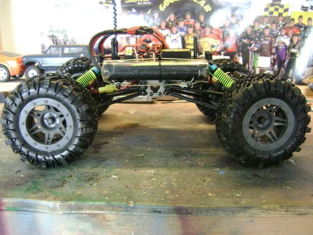

How much does the wheelbase increase being squatted down like that? Can't measure mine since it's in the mail. I really like the stance of yours though and it's making me consider droop.
Wheelbase as mine sits is 10 inches. I believe stock is 9 so it increases it an inch. I have ran droop for a while on my scalers because it makes it much easier to get a scale stance. Its good at keeping the center of gravity low. The only draw back is it lowers your belly clearance so you hang up a little more. Droop has pros and cons like anything but I like it. I really like the way my CC does with it. Plus it gives it a cool stance that you don't see very often especially since I also slammed the body."thumbsup"

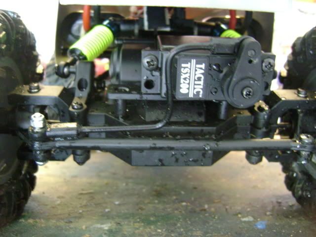

I made it home and had some time to tinker after church Sunday. I, like many people, was bothered by the look of the steering spacer on the rear so here is my entry for scary steering.
I also switched the 2 Venom 3000mah batteries for 2 Duratrax Piranha 2000mah batteries that seem to be a little lighter.
Here are the specs on it so far:
Stock RTR Cliff Climber
Body post relocated to a lower mounting point on chassis plate
Electronics lowered into battery compartment
Rear steering rod reworked
Wheels weighted 3/4 ounce up front and 1/2 in the rear
2 Duratrax Piranha 2000mah standard 6 cell packs
Droop suspension from the weight of the batteries

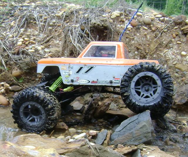

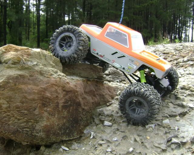

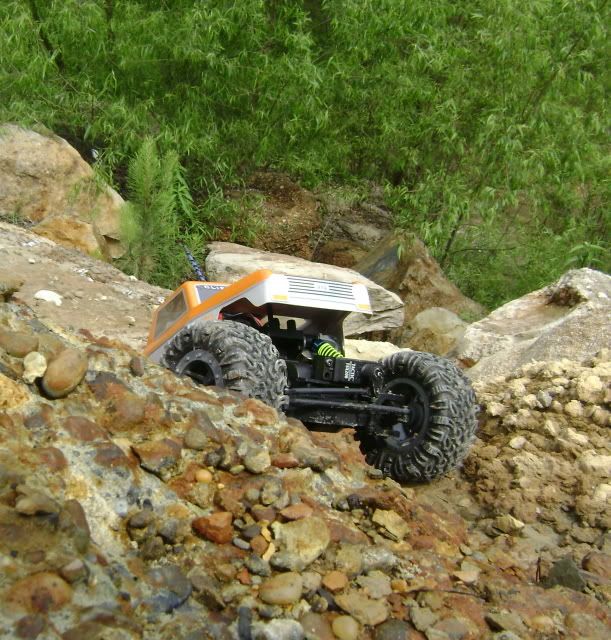

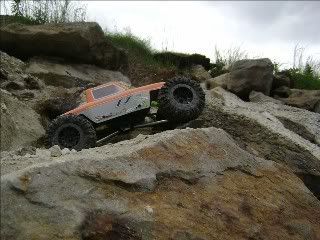

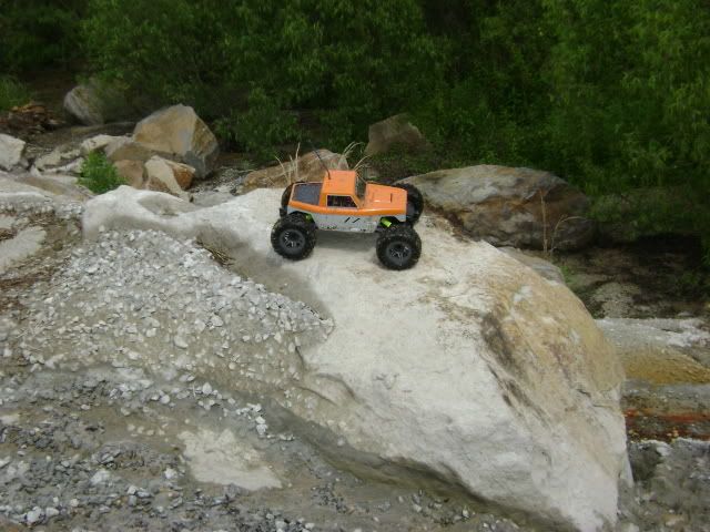

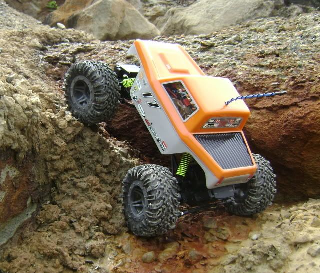

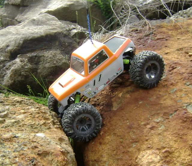

I got a chance to take it crawling on some real rocks. For the $119 price and the cheap simple mods I have made to it, I was really impressed. Clod stall was a small problem but you kinda get used to it. It really didn't hinder me from going to many places that I wanted to go. The tires grip pretty good on rocks. Tires are not so great in dirt but good enough on rocks that I am not worried about changing them. Side hilling was pretty good. Now on to the pics.

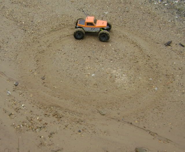

With the speed and the way these things swing around with the rear steer they kinda remind me of monster trucks so here is a donut just for fun.
Hey, this is RC not the real thing. That scary steering will work fine and you aren't going to kill a bus load of nuns and orphans. Actually a dogleg link is probably stronger than the stock plastic link.

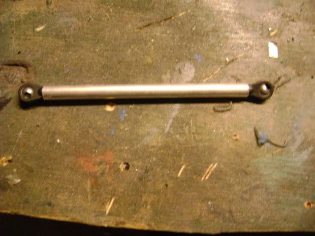

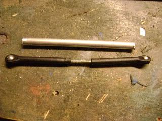

I had some time to tinker Sunday so I clocked the axles. I took the stock links and cut them in half. Then, I drilled a 4/32 hole in the ends. After that, I used 6/32 threaded rod to extend them.
Finally, I slid some aluminum tube over them and reinstalled the extended links on the rig.
The new links are nice and strong thanks in large part to the aluminum sleeve. They also look really nice like an upgrade part.

Cool, I was just going to toss the stock links since they are so flexible. I may try your trick on mine though, stock links have a little more range of motion that some of the traxxas rodends I have. Fixing that front axle angle was a huge improvement on my truck.

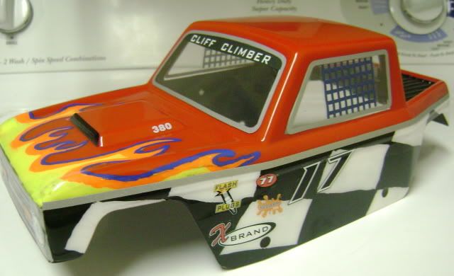

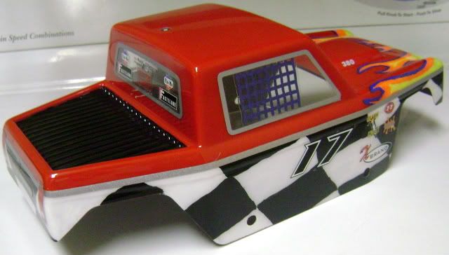

With the new body on the way I decided to put my idea on paper. I usually do that before painting a body because it is cheaper to decide you don't like something on paper than it is on lexan. Here is what my idea looks like on paper.
Any opinions?
Looks good, racey. The one thing I would like is dome real Bronco grill/headlight stickers. I bet the HPI Bronco decals would work. The stock CC decal looks like a Chevy LUV grill on a dovetailed Bronco, haha.
Body ships in the mo'nin! Glad your gonna paint something original. Flames with the checker scheme looks good in your drawing.
Thanks man! I appreciate the good deal on the body. That idea just popped in my head the other day. I think its going to look pretty, cool too!;-)
The spacer I added to the front steering created the problem the stock set up has in the rear. The steering had too much wiggle or slop. I tried a bent link set up but it didn't help much either. Eventually I found a longer servo horn that I had in the tool box so I put that on without a servo saver. That seemed to help. I also put some o-rings in the cups to fix the dogbone slop. It had gotten to where I only had 3 wheel drive if I got in a bind but the o-rings fixed that.
I got home yesterday and had a box from the good ol' U.S. Postal Service. I was expecting anything for another day or so but there was the new body I had bought. Thanks Rag6 for the quick shipping and throwing those stock decals in the box for me. I was glad to have it and had to get to work!"thumbsup"
Someone had mentioned to me using HPI Bronco decals for the grill but when I looked at the body it had panel lines in it for a Bronco'ish grill. I guess they must have ran into licensing issues or something so they made the decals different. I decided to do a little cutting on the stock decals and paint my own Bronco'ish grill. This is what I've got done on the paint so far.

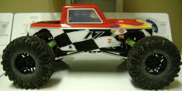

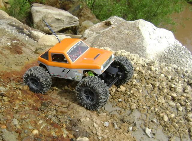

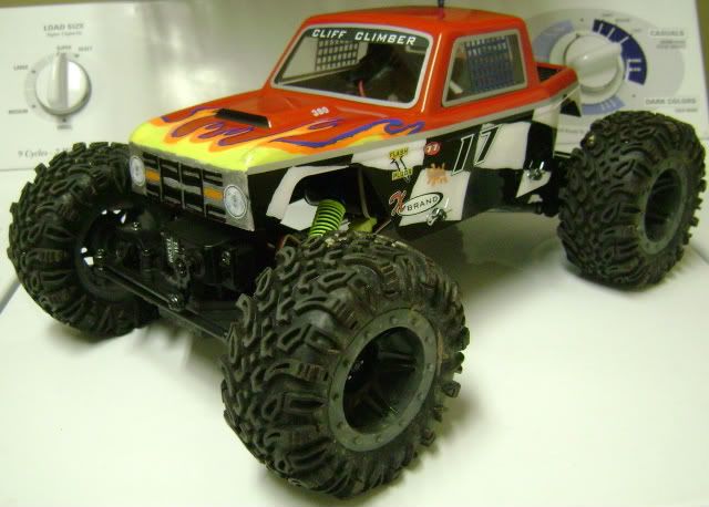

I noticed that the front axle was clocked a little too much so I shortened the links just a tad to get the steering link just about level. I got the body finished up and mounted. I am pretty happy with it. I think I could have done a little better on the flames but overall it turned out ok. I also really liked RCer4life's custom sharpied wheels so I painted the spokes of mine black.
Here is the finished and decaled body.
Pics of it mounted with the new look on the wheels.
