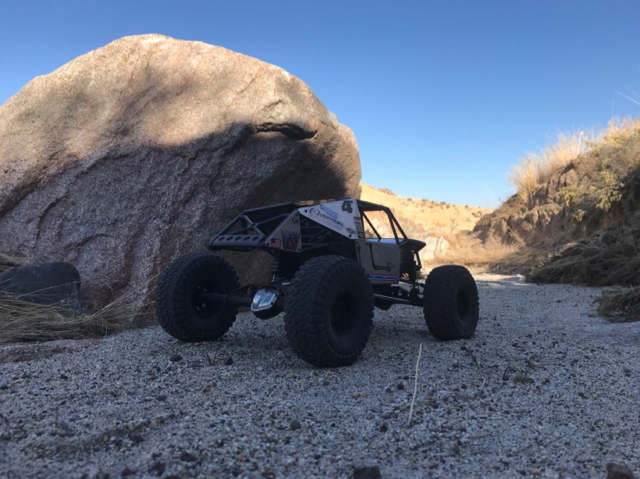

Well, we had our first run in the dirt.
I am really impressed. This thing runs great. And with the sway bar, handles great too.
Now, once I get the turning radius a bit sharper.. I may deal with unwanted body roll. But right now that wasn't an issue.
4100kv on 2s with a 15t pinion is definitely not too fast and I don't anticipate any breakage on the driveline. It's geared low and and never felt overly powerful.
19mph top speed with turbo and boost set to zero.
It is front heavy, and it does jump that way. But anyone who knows how to handle a rig mid air will find it easy.
I actually liked the challenge of jumping it. It handled like a real truck with real weight to it in the front. I will need to tune my shocks. Heavier oil in the rear should do it. I upgraded my rear shocks to xd piggyback shocks and they give more spring than I would like when landing flat.
So far, I love this truck. I think it's going to be a new favorite of mine for trailing and laps on a track.
