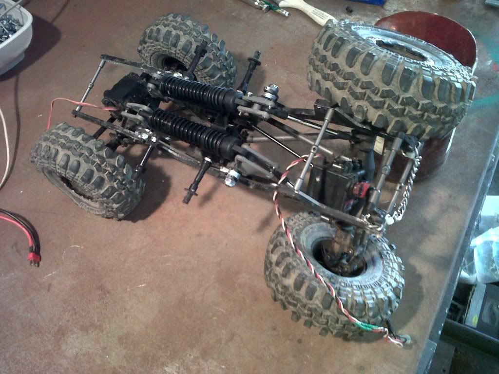

Exactly! Proof in piont, Here is my my LCC Class 3 Top Truck. Dont limit yourself to whats available at a hobby shop. If you dont see it, Build it!"thumbsup"

if you can afford a coping saw, drill, and a couple files, you can make a chassis. if you would like to get a good purpose built losi chassis, i would suggest (a bit biased) the overkillrc chassis hitting the market shortly. to see that, look at either losikid's or my thread (gonna have to dig a bit for mine) in the last couple pages. a few more pages in and you'll see the chassis i made with very simple tools mentioned above.
EDIT: the new overkill chassis, production varies slightly from my prototype
and i made this with a drill, coping saw, and files, ran the thing for 30 hours in 2 weeks, not a break.
anything is possible, think around your problem, not into it. thinking into the problem tends to lend itself to overcomplication, thinking around it ends in a simple, elegant design that simply works.

the production one's are more beefy basically, .4 thick shock arms instead of the pictured .250, more material to the chassis plates in general. i've had a couple problems with my proto during cold weather tests that were promptly fixed in the production design.
i recommend if you decide to make your own, McMaster-Carr for buying delrin. also keep in mind that i have tons of design time into both of those, and its pretty wild even to me what i was able to accomplish on it. 4.5 clearance is easy, and she stays planted and very stable. losikid has a vid up in his thread with the production model. i lack a decent way to take video, so he's the one to hunt down for vids.
sometimes all you have to do is stare at it for a while and it'll come to ya, if that doesn't work, sit and doodle for a while, the whole concept of the shark fin came to me with a very basic doodle when i was converting over to the cdw chassis. pretty much all my mods are documented in my thread (have a couple up my sleeve still :ror:), from humble stock beginnings to the overkillrc test mule, its been a long process.
