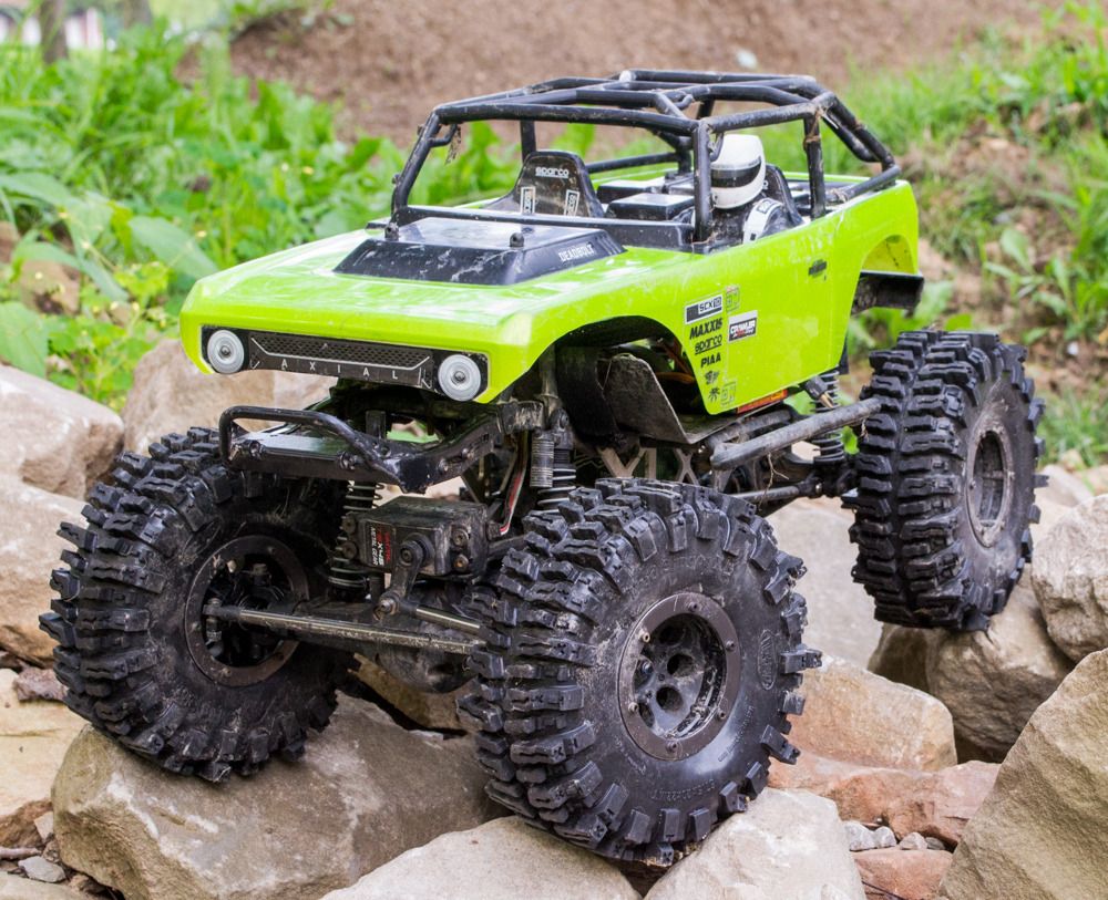

Brushless or not? Would it mainly be mudding or mainly be crawling? I had converted my SCX10 Deadbolt to a mud truck with just essentially an RC Bro lift-kit and some 2.2 Mudslingers, along with a Castle Sct/3800kv system that I used from another vehicle. I used my SCX10 because I don't like tearing down the Wraith as much, plus it's easier to transport the Deadbolt for myself. I also went brushless because it could crawl OK but I mainly needed the wheelspeed for mudding.
Trying to mud with the stock 27T brushed motor killed it within 2 runs, and the 1.9 Treps weren't even comparable to the Mud Slingers, which still do rocks pretty well. Either way, playing in the mud/water for long ends up costing a lot of time in maintenance and drying the thing off all the time as well. It was fun though:
EDIT: I also could mention the 2nd benefit of the SCX10 is removing the lift-kit and 2.2s and converting it back to a scale trail truck.
