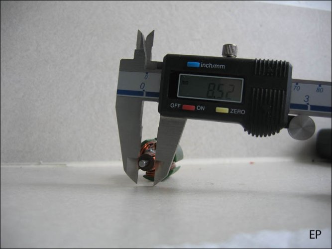

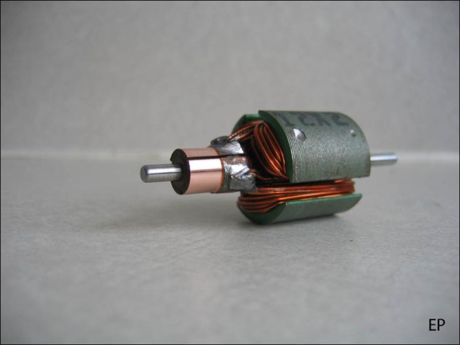

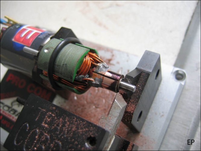

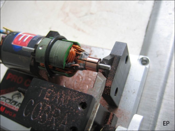

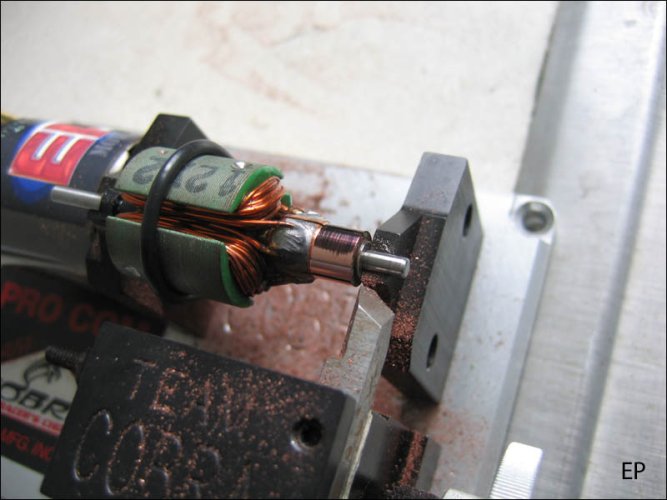

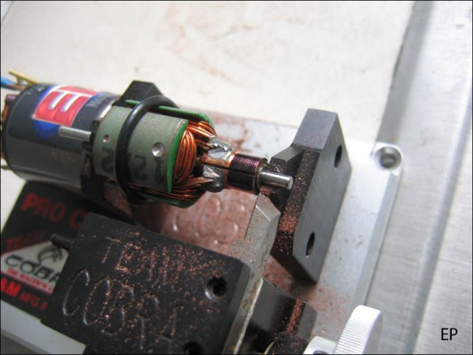

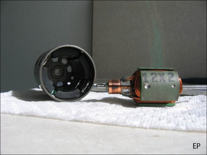

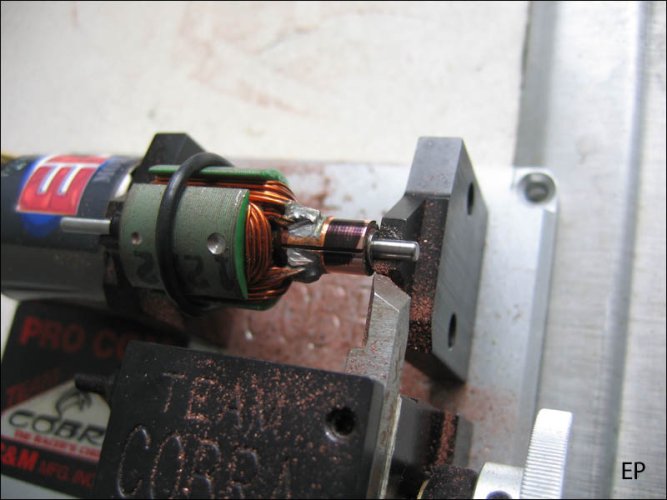

This is a nice looking motor, I'll have to see if I can drag this out long enough so the guy will forget he gave it to me to tune up.
Yokomo based 12 turn double, laydown brushes, four magnet can, perfect for flooring it in the scaler! :mrgreen:
