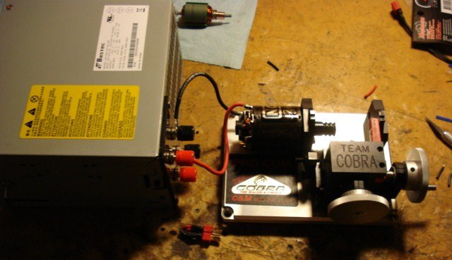

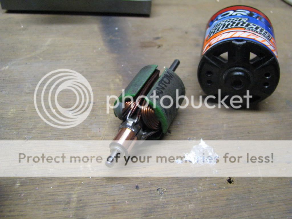

I'm having fun. Nice relaxing Sunday afternoon, pound of bacon in me, cutting comms and having a few beers. :mrgreen:

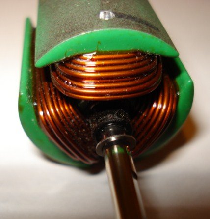

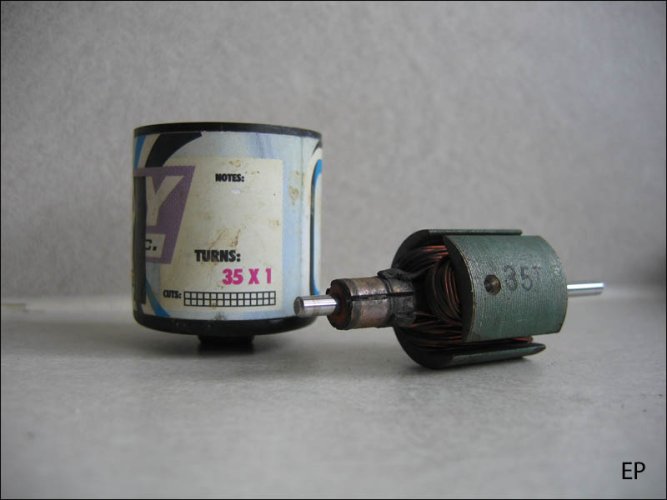

I'm much more relaxed cutting the cheap motors for sure. I warmed up with a quickie cut on a beat 35 turn Integy before hitting that Reedy.
In the second picture, look how crappy the winds are wound! Wow!

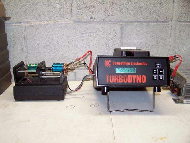

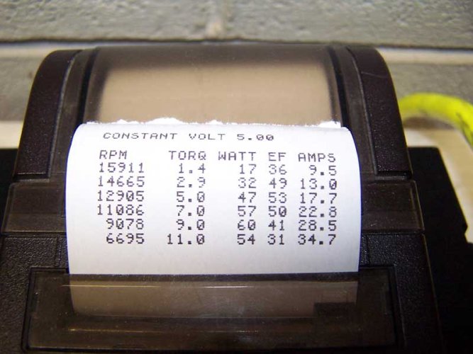

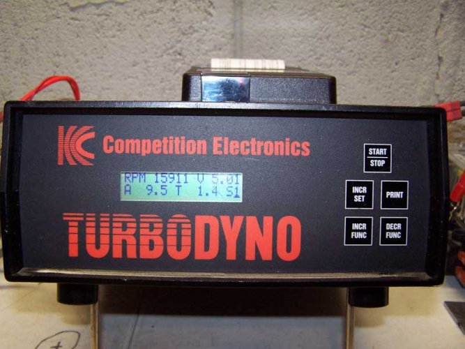

That is fun......but I have a little more fun doing this. :mrgreen:

Yeeeeah man, now that would be a real kick in the pants.
What motor you just test?
Glad you posted a pic of that. Good comparison from a cheap built motor to a Top Handwound motor.

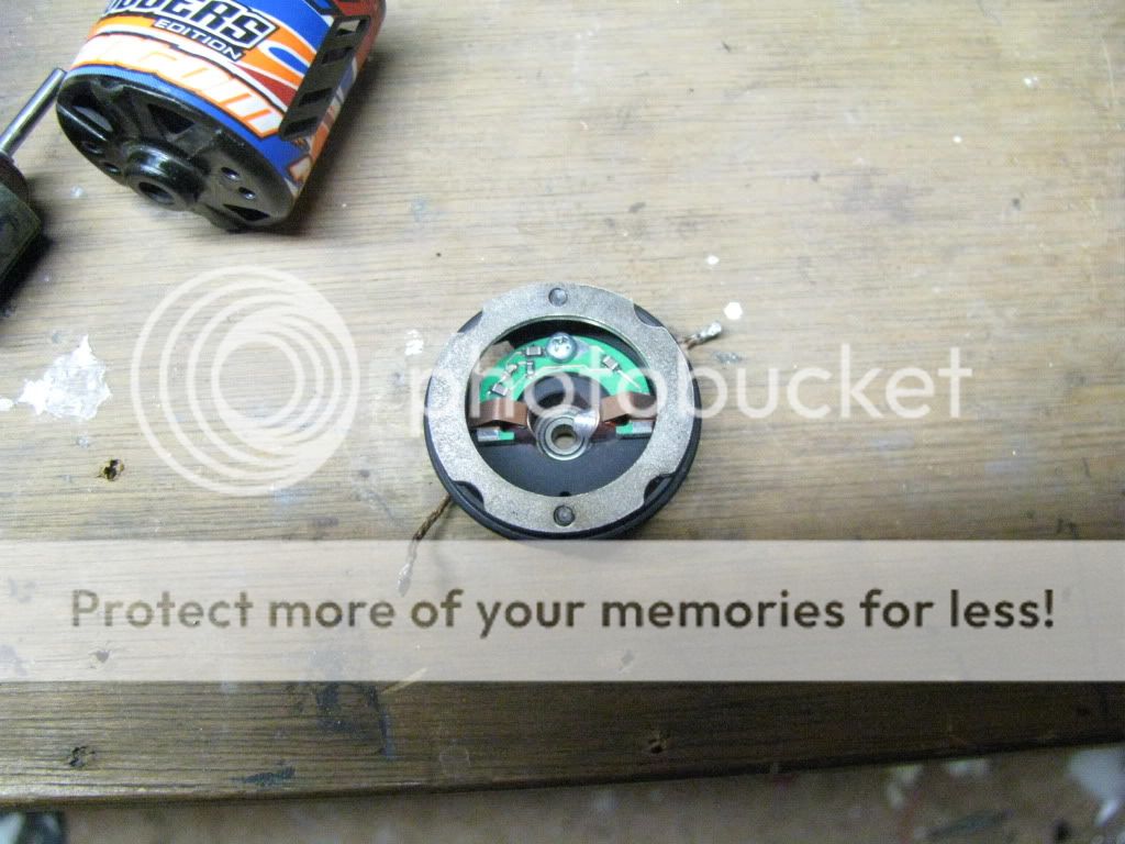

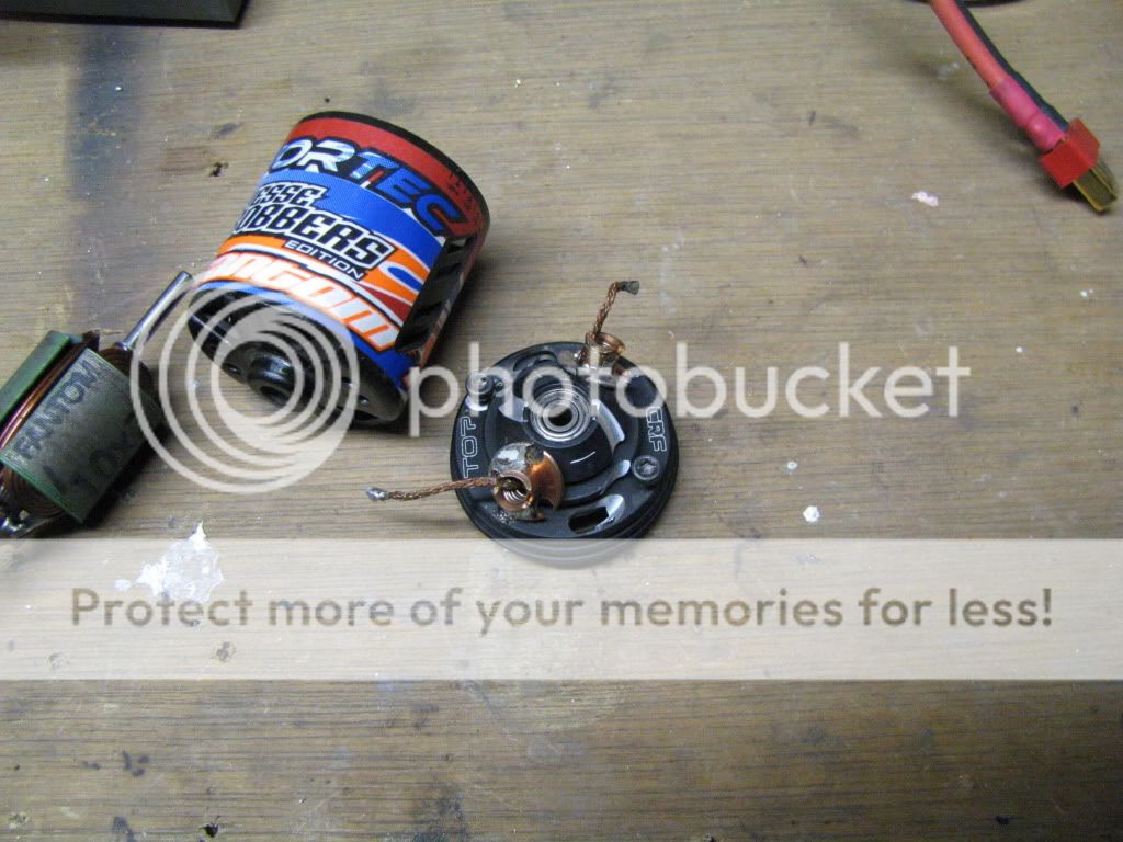

Quick question for you motor guru's. I scored 4 fantom Jesse robbers edition motors today for 5 bucks a pop. 3 of them are uncut 1 was cut once. The endbells on these are amazing. So anyway on to the question. I want to find some 9 or 10 mm coms to handwind. These come with 7mm com. Can i use the bigger com with these endbells? Or should i just wind the coms that i have with these motors?
Not sure about putting a bigger comm in a endbell like that. For $5 though, I would try it. :mrgreen:
If it fits it'd work, just get some new brushes for the new comm cut and give em a nice break in period.

think thry are all 10x2 but i will check.
well i pulled all 4 out and they are not all jesse edition but they have other names on them. They all have the same endbell and look to be the same. One is an 8x1 12x2 14x2 10x1 and a 10x2. Also the guy that i got these from is selling a nice cobra pro 2000 lathe with diamond bit for cheap. If anyone is interested. I do not know him well but the lathe looked like new and i have his number.
The pattern wind arms are really nice and always ran well in touring and 12th scale and used the top cans for a long time. I tried a top can and endbell on a comp rig for a while but it was hard to find a brush/spring combo that really worked for me and the brush shunts snagged a rock on occasion. I think they would be great in a scaler though. I may have to dig that mod motor case out and do some tinkering...
