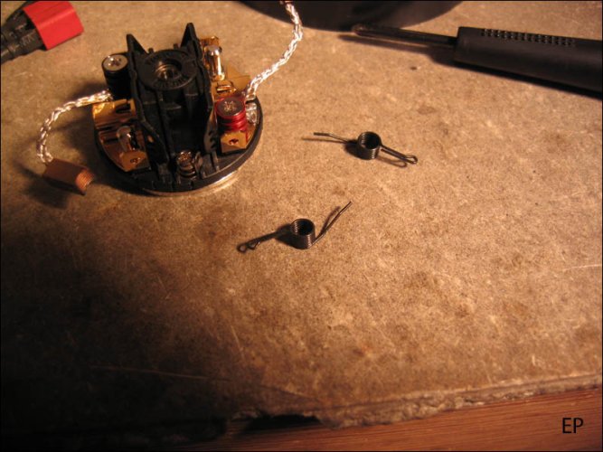

I tried two of the same springs. So I tested four springs total.
With a regular shaped black spring I got about 7.5 F U's
The black springs pictured below I got just under 8.0 F U's.
Fiddlestick Units. :mrgreen:

The regular black springs were from trinity, there is actually two versions.......one is super stiff, stiffer than a trinity silver. The other is like a Red (if memory serves correct) and was made for laydown motors (if memory serves correct)...
The springs picture below are Orion springs for laydown brushed motors.....they are the 175 degree springs. They are fairly rare, as Orion didn't sell a lot of them......I bought pretty much all they had years ago.....I use them for special motors.....they seem to hold tension better, be more consistent from spring to spring....
Just one of the many cool little things I have hiding in my stash of "New Old Stock" as its been called...
