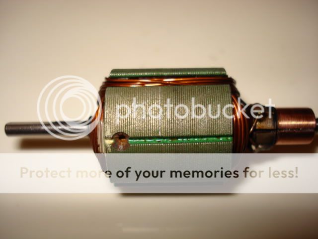

The above photo is not a slotted arm. That is a bone stock trinity arm. That small groove down the center is a guide for the balancing holes, basically where the center of the segment is, so the grunts at trinity wouldn't drill off center (though thats useful for balancing)....
This is a slotted arm (yes, this is the first 2011 LE to be released in a few weeks)....
A slotted arm will ALWAYS be less efficient than a full arm with everything the same (comm size, web size, etc) because there is less steel. It's just the way our little motors work. Racers would never run the 4mm arms in Touring Modified, as a 5mm blank was good for another 40+ seconds of runtime. ......the removal of steel on the slotted arms has a lessened effect. Typically we saw run time of about 20-30 or so seconds less......without getting too technical and confusing everyone, I'll just leave it at that.

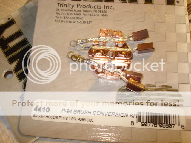

A p94 is different from the octagon brushes.....The whole p94 thing was kinda a gimmick to sell more brushes. It was pretty normal for all trinity team motors to use p94 brushes, but the face of the brush was cut down to to be a regular size brush......only trinity sold p94 brushes though, so they kept you from buying brushes from anyone else....their polarized springs served the same purpose. Ernie P was a smart business man....
The Ellipse brush (not eclipse) was designed for the Cobalt 2 modified motor.....it was a good brush, very similar compound to a XXX lemans...not quite the same though. The Octagon brush was just a different shape XXX lemans brush......

I think the p94 is a good fit with a 10mm comm.
I have been playing with various combos
4-5mm webs
7.5-10mm comm
standup,laydown,p94
The 2 mag can 5mm web,10mm comm with p94's has the best hold of what I have tried

You may find that slotting the arms axially makes the startup even worse. On a 5 or 7 segment armature it reduces the detent torque. On a 3 segment armature I have found it to make the startup jumpier and increases the detent torque slightly.
I haven't noticed that in any of my testing......their are videos of my truck from the last comp I went to......low throttle control was great and the extra power caught everyones eye.
I've tried Tri-Rotor arms, which would basically be a slotted arm off-axis...they performed similar.
Maybe post up some photos of your slotted arms, might be able to spot the differences why you experienced a more jumpy start up.
Later EddieO
I sent all the last ones out, so I will need to slot more for pics. I used a 1/8" endmill and took off material about 1mm or .040" deep. Maybe a wider bit would get different results. The power certainly went up a bit, but the startup speed increased as well.
It looks like your slotting removed quite a bit more material. I will try a 1/4" bit and plunge it deeper next time and see how the results change.
