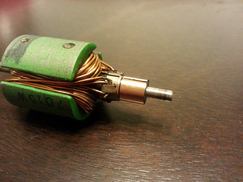

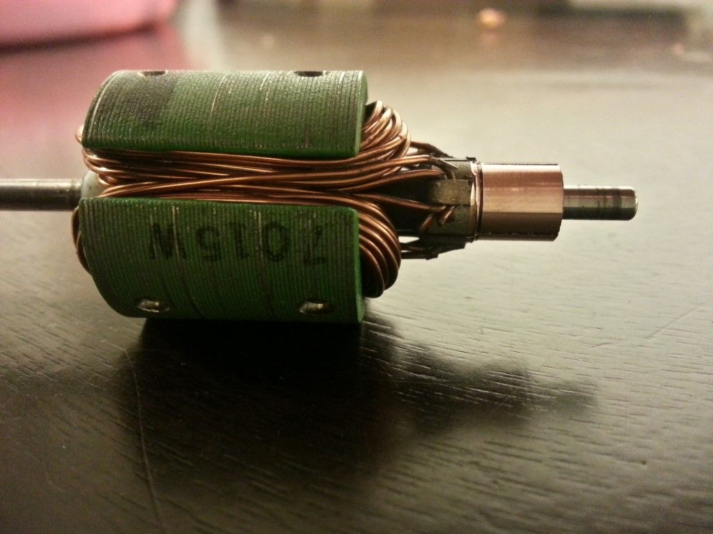

Cool, I have a nip 27t axial silver can I'm going to run it with and a converted atx power supply with 3.3v. I also added taps for 5v and 12v so I'm good to go with that I think.

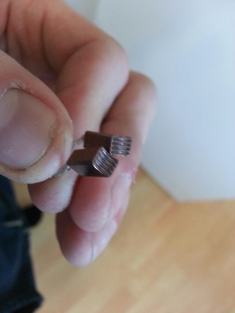

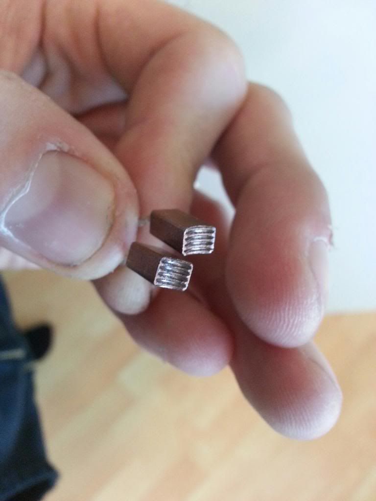

serrated brushes why ?
Faster break in
Crap, that thought crossed my mind when I was looking at my bottle of Greenlee dark threading and cutting oil, says it's good for ferreous and non ferreous materials so that should do. I was scared it would contaminate the brush surface but I can hit them with contact cleaner after?Use thread cutting fluid from the hardware store....makes them cut easier and faster,while being a better cut too.

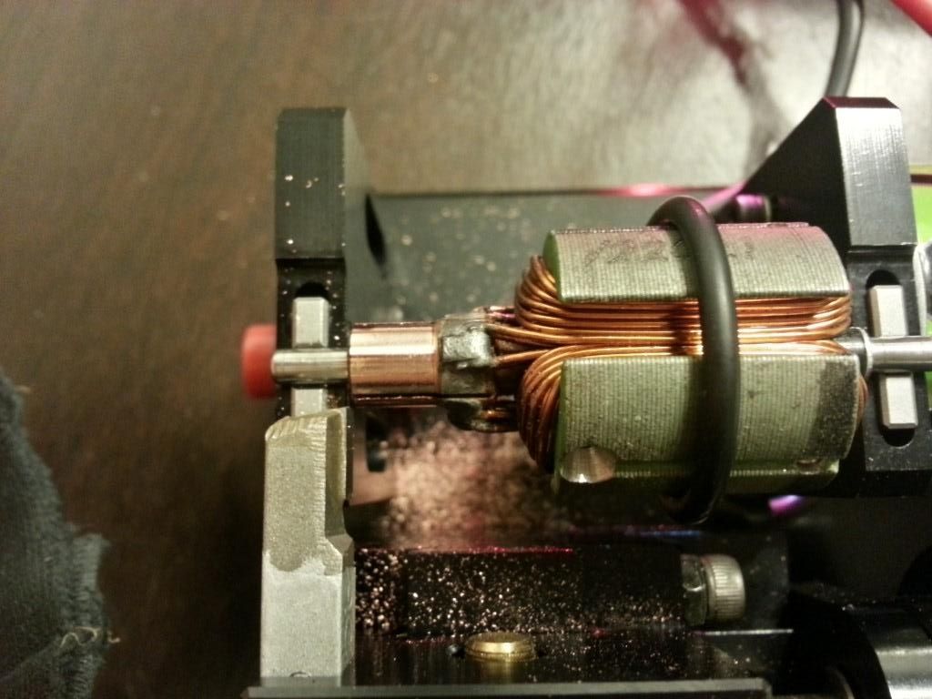

Thanks, a fussy brush maybe in my future, I like the idea of cleaning the brush face since I only have a comm stick for that. This cutter is only good for serrations and cutting which is a bit of a letdown. Unfortunately it's gonna run me 55 shipped from holmes so it's a bit rich this close to Christmas. Oh yeah, my bit can be adjusted up, it's set centered and low so I could flip the brush to evenly serrate it.Whatever brush cutter I have, can't remember and it's not the same as yours, sucks also. I got a Fussy from Brood and that thing tears em up, in a good way. However I still use the powered one more. I figured out if I don't use the grooves intended to hold the brushes but lay it on the deck and freehand it all it's way faster. Still takes pressure and a flip over but it's a done job in 20 seconds. My bit seems higher up so I'm able to. Or the deck height is thinner. Maybe not though, as I need to flip the brush over to do the full face.
They look fine though different because the serrations aren't from edge to edge.
The Fussy has numerous bits to replicate the diameter of the comm. Bonus.

Hit it and flip it and hit it. Move it around a little. Much quicker.
