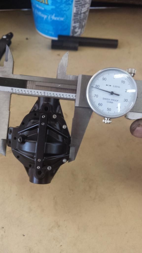

First, I took the VP Currie center section and wanted to make some small changes. First the Currie center is a decent amount bigger than stock so I wanted to shave all I could off the bottom for better clearance.
Stock 2.128"
Shaved 1.978".
Total of .150" off the bottom is pretty good! In fact, better than a stock AR60 housing!
Next was the pinion bearing. Stock is 11mm, I went to 13mm. This is a must IMO to upgrade this for long bearing life and also so your gears will last.
